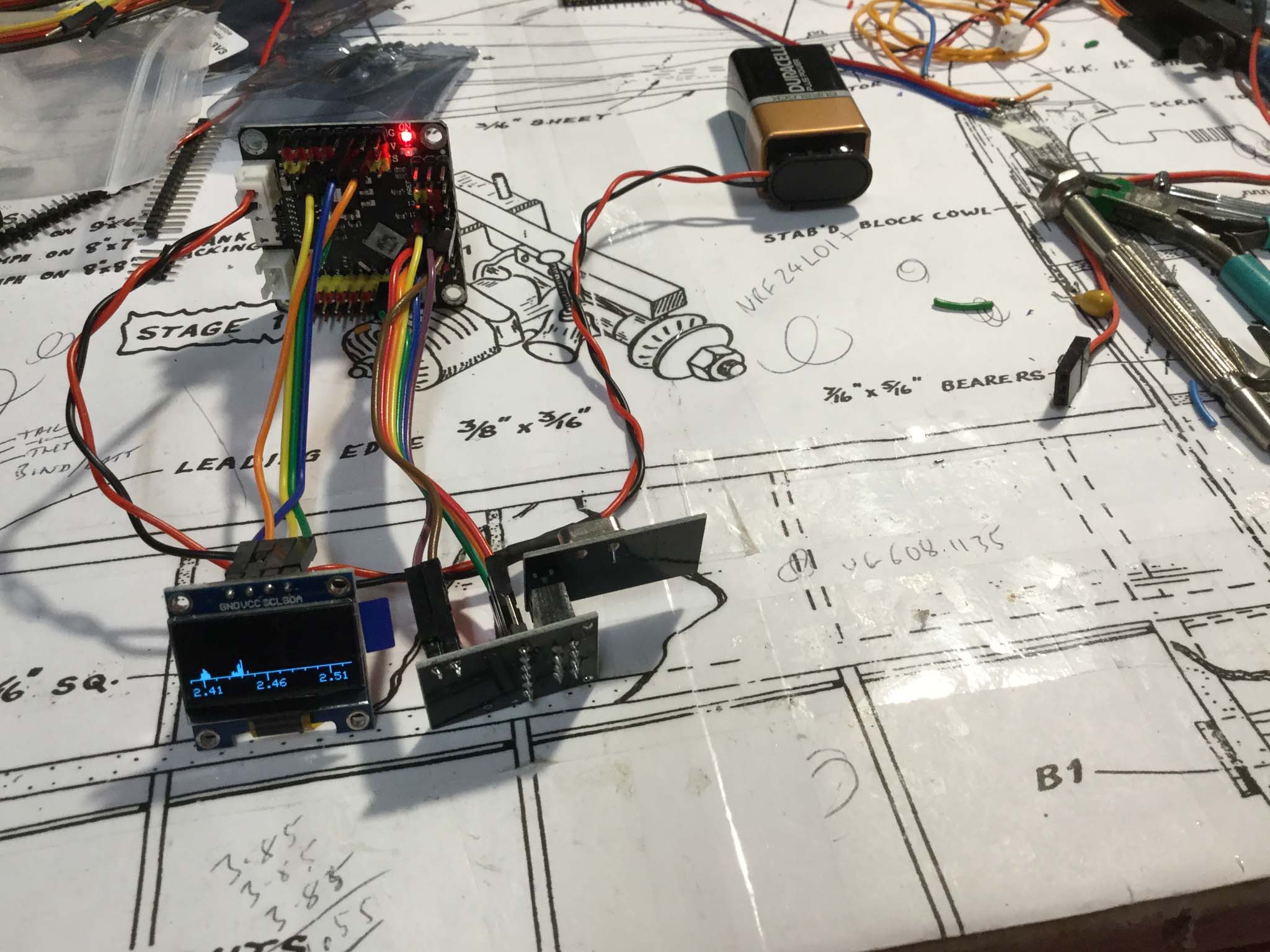

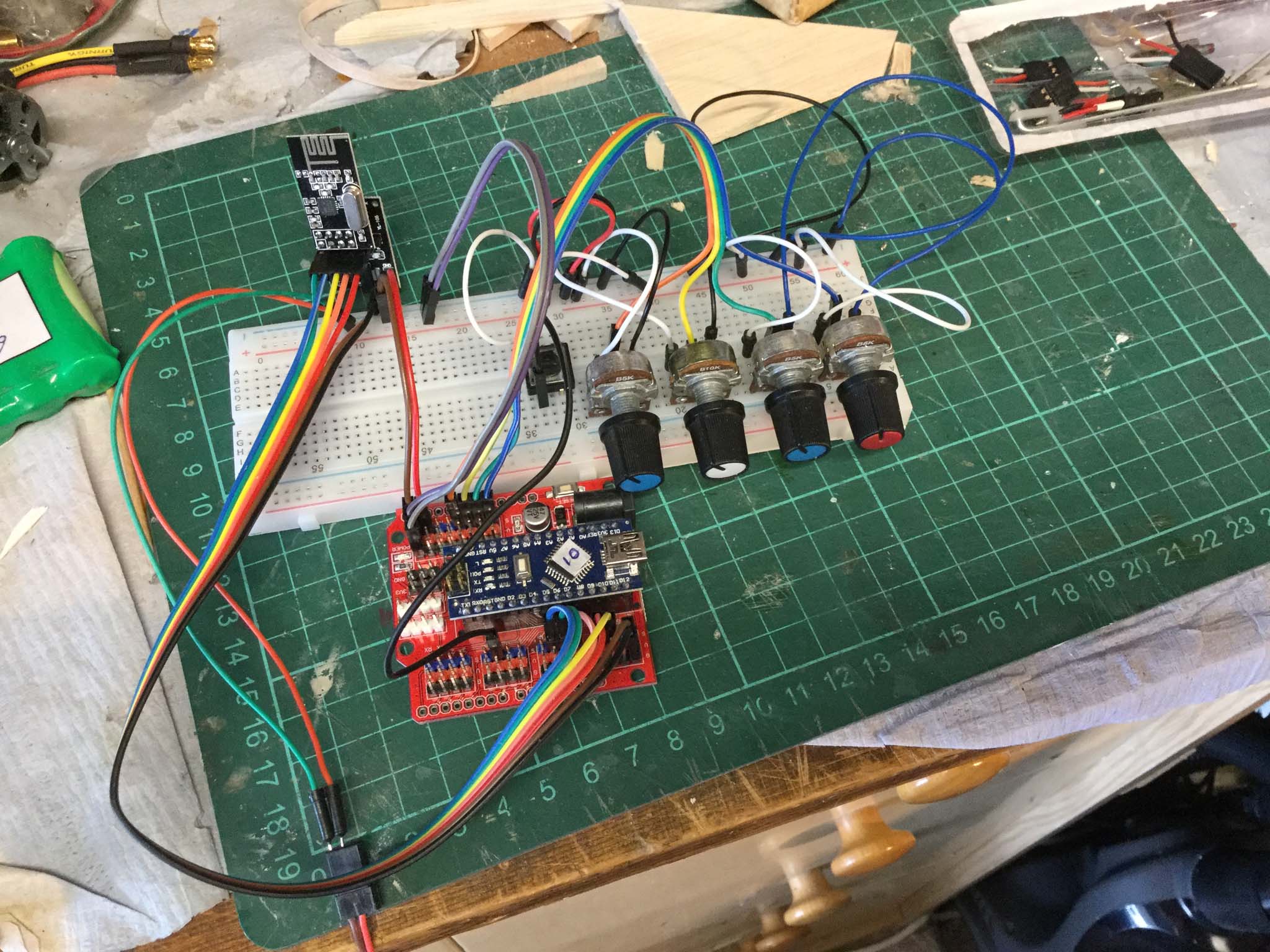

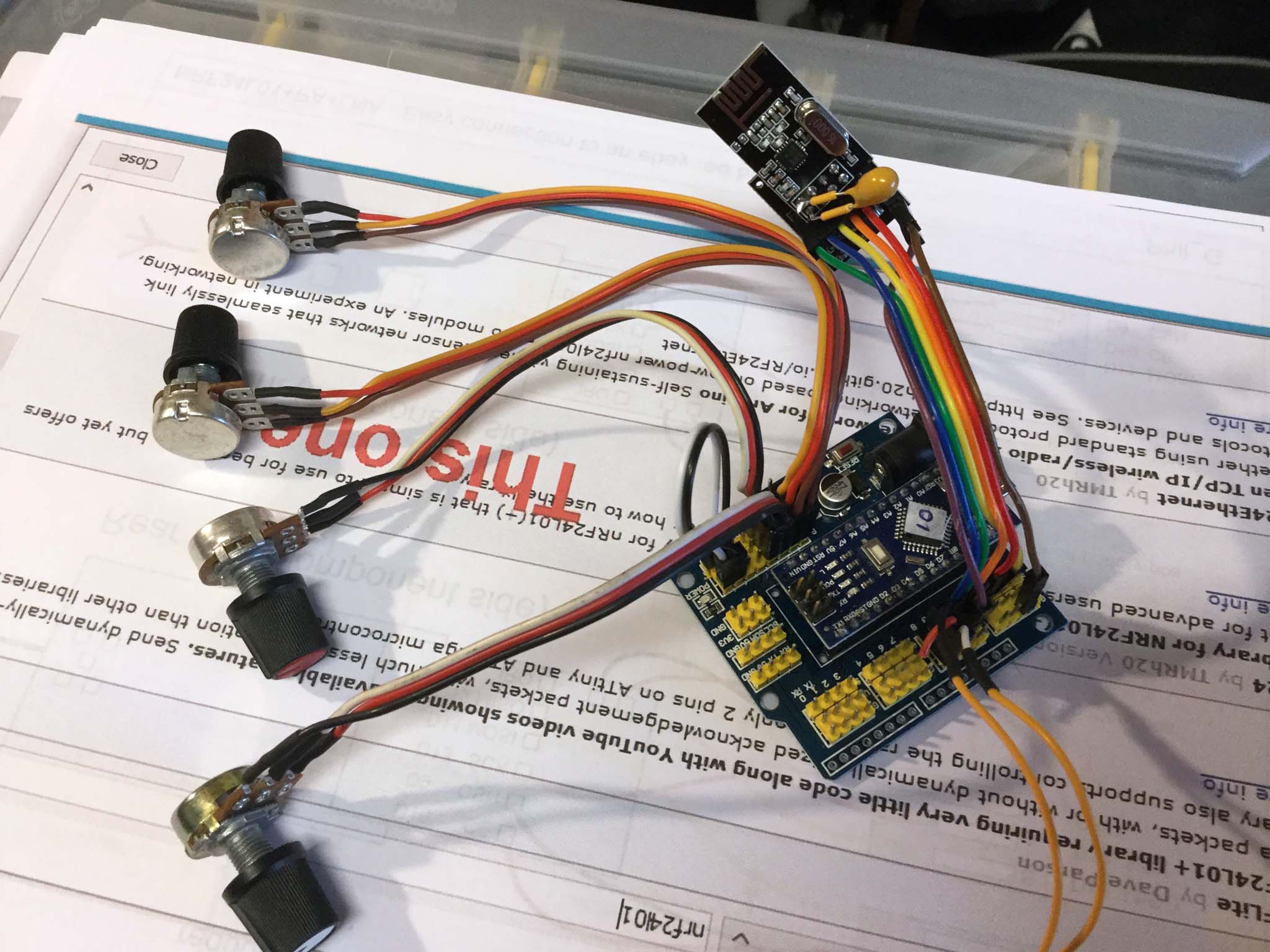

I am having a lot of fun with this NRF24 project.
I have some (hopefully not too dumb) questions.
First I made the 2.4 GHz scanner with an oled display which works fine and is a good test for my NRF Tx.
The NRF Tx is a arduino nano and the low power NRF24 module which seems to work Ok with a visible display on the scanner. The nano was programed through the ide using the USBASP programmer.

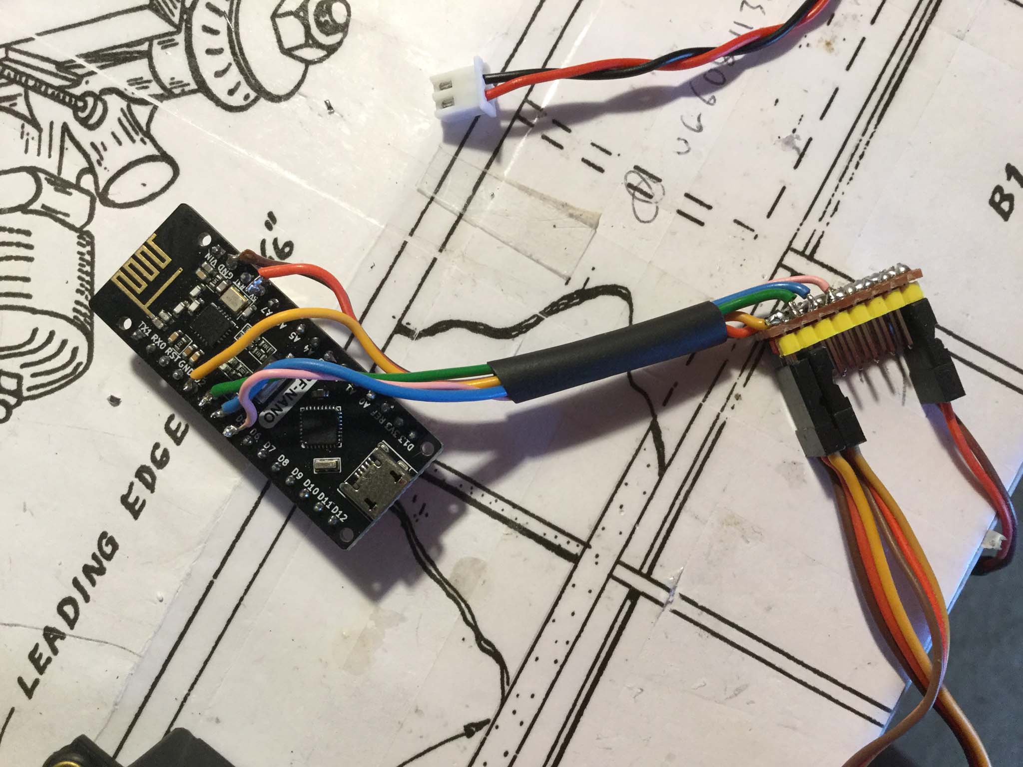

The Rx is a RF Nano which was programmed through the USB connector presumably with a bootloader.
When the Rx is switched on the servos initially twitch but no movement from the Tx pots.
I have scoped the Rx servo signal which shows a pulse output but no variation in width to the Tx.
Is there a point in the Tx nano where I can scope the ppm pulses thus ensuring that Tx pulse train is working?
Secondly is programming the Rx nano via the bootloader ok or is there a way to use the USBASP?
I am using 5 volt NiMh packs to power both Tx and Rx, for the Rx connected to the 5v pin.
I have included some pics.

First of all, have you fitted the 5v LED between A0 and A1 on the receiver? that will tell you if packets are being received. Using a 5v LED means no need for a resistor - much neater.
With the tx switched off, the rx should be in failsafe, so the LED should be solid and you should see 1100uS on the throttle and 1500uS on the other channels.
The number one source of problems is power, the NRF needs those decoupling caps. And forgetting to set CE and CSN to the correct pins (10 & 9 resp) though if your tx is working then you have that right.
Be careful with a 4-cell NiMh on the Vcc receiver pin, as explained in the thread, the NRF section is 5v tolerant, but only to 5.5v iirc, a 4-cell can exceed that. I use a 1S lithium.

Your band scanner - is that this project being displayed on the screen? I see only two carriers, did you spread the 16 FHSS channels throughout the band? It should fill the display.
I'm not a fan of breadboards, I dont use them because of the hours they can waste trying to find faults!
Try to simplify the layout - put links on A6 and A7, thats a start, looking at the pics your NRF wiring looks ok but I cant make out your transmitters 3v3 supply - thats crucial ;)
Thinking about it, the RF-Nano receiver is so simple its unlikely to be the problem, other than power, so I'd be going over the tx wiring again. That OLED screen defo looks wrong.

The Tx low power NRF24 is supplied through the power adaptor, but I will fit a capacitor across the 3v supply.
TX has the CE and CSN correct. Breadboard agreed is not the best but my way of seeing how it is connected and adding some control pots.

The 2.4GHz was showing just my house WiFi, Tx was off. Tx shows ouputs across the band.

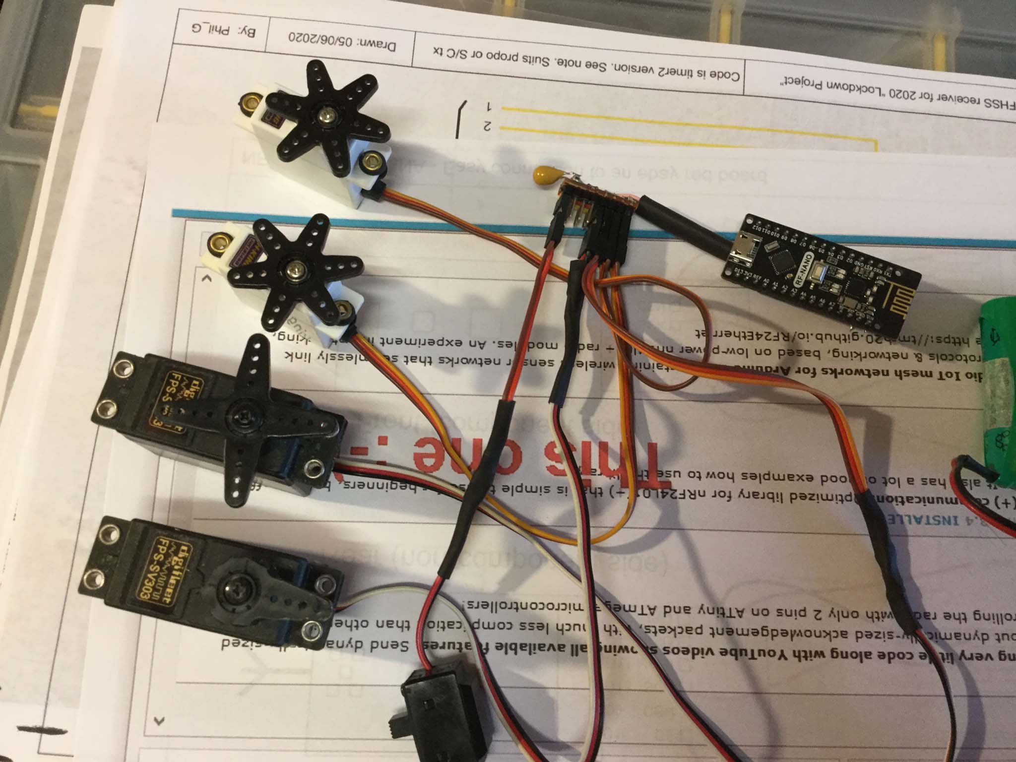

Finally managed to get a working Tx and Rx.
But the servo response is a bit jittery.
I would appreciate any pointers where the problem is.
Hopefully the video will attach as well.
