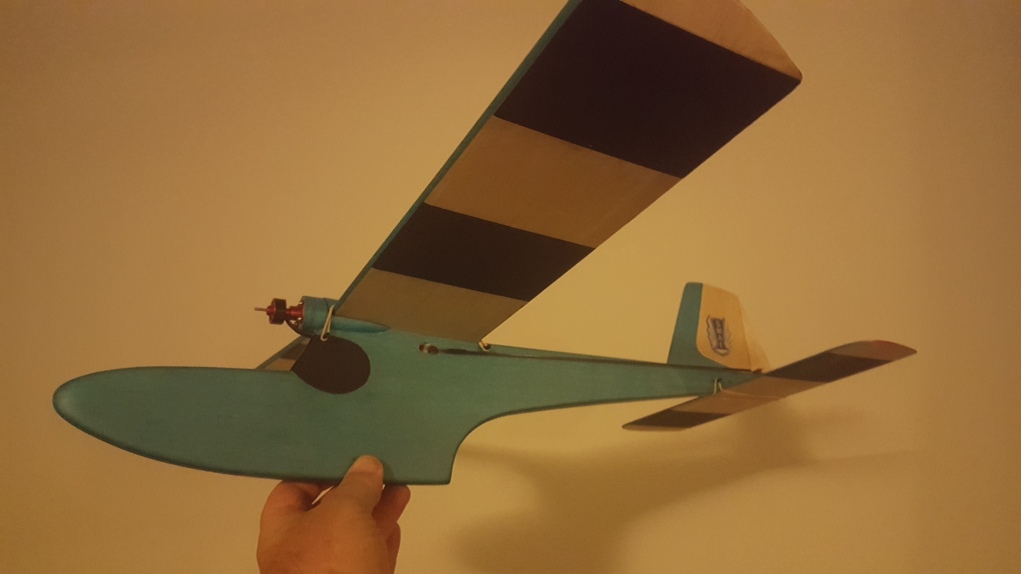

Last week I damaged my Mattel equiped Pulstar with a test glide which divebombed

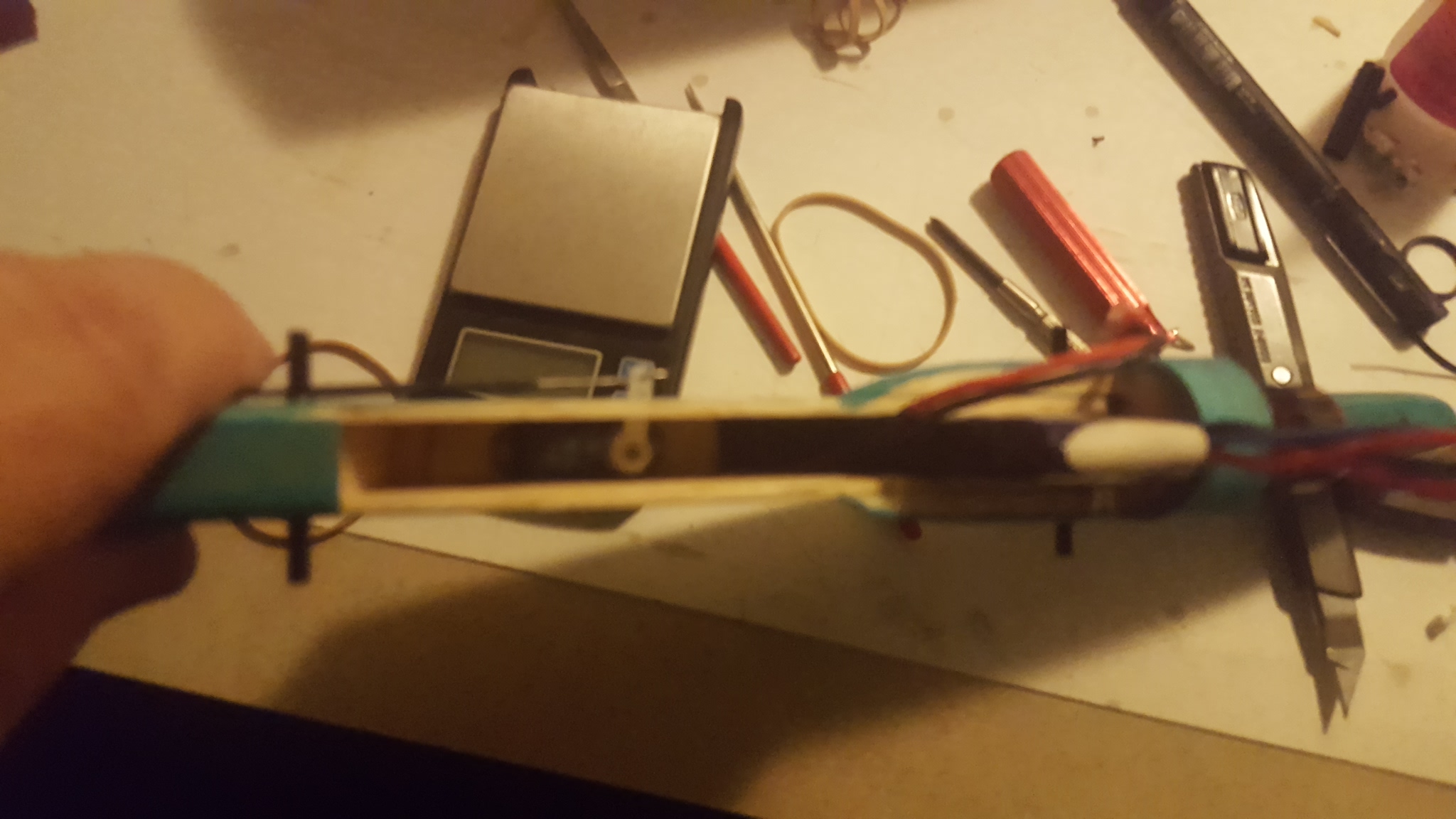

Since then I've built a second fuselage using lightweight radio gear. Just a couple more little things left to do and it's weighing in at less than 6.5oz (compared to 9.5oz). It's more like how Vic Smeed designed it but with a couple a personal touches.
This time I made the motor mount with the grain going vertically and sandwiched between two 1/16" pieces of ply that are cunningly disguised as the windows
Also I moved the location of the front dowel lower as this is where the first fractured.
Shaun encouraged me to repair the first fuselage and I have done this. Where it fractured around the actuator, I now have doublers (should have done this in the first place) and the damaged motor mount removed ready for a new one which I'll make when I have a motor. It's looking good as new
So I effectively have two Pulstars for different conditions and experiences
I'll look forward to a more successful test glide next opportunity.

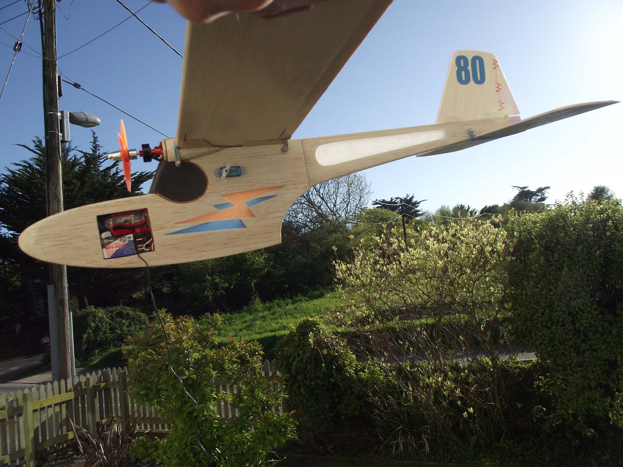

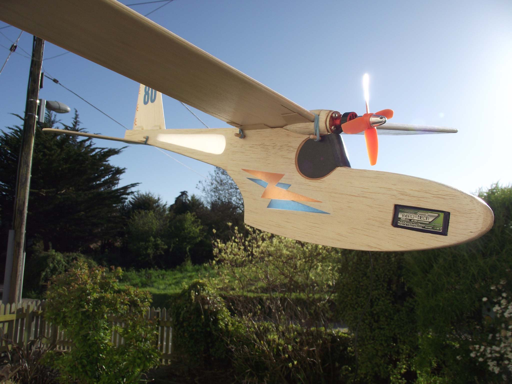

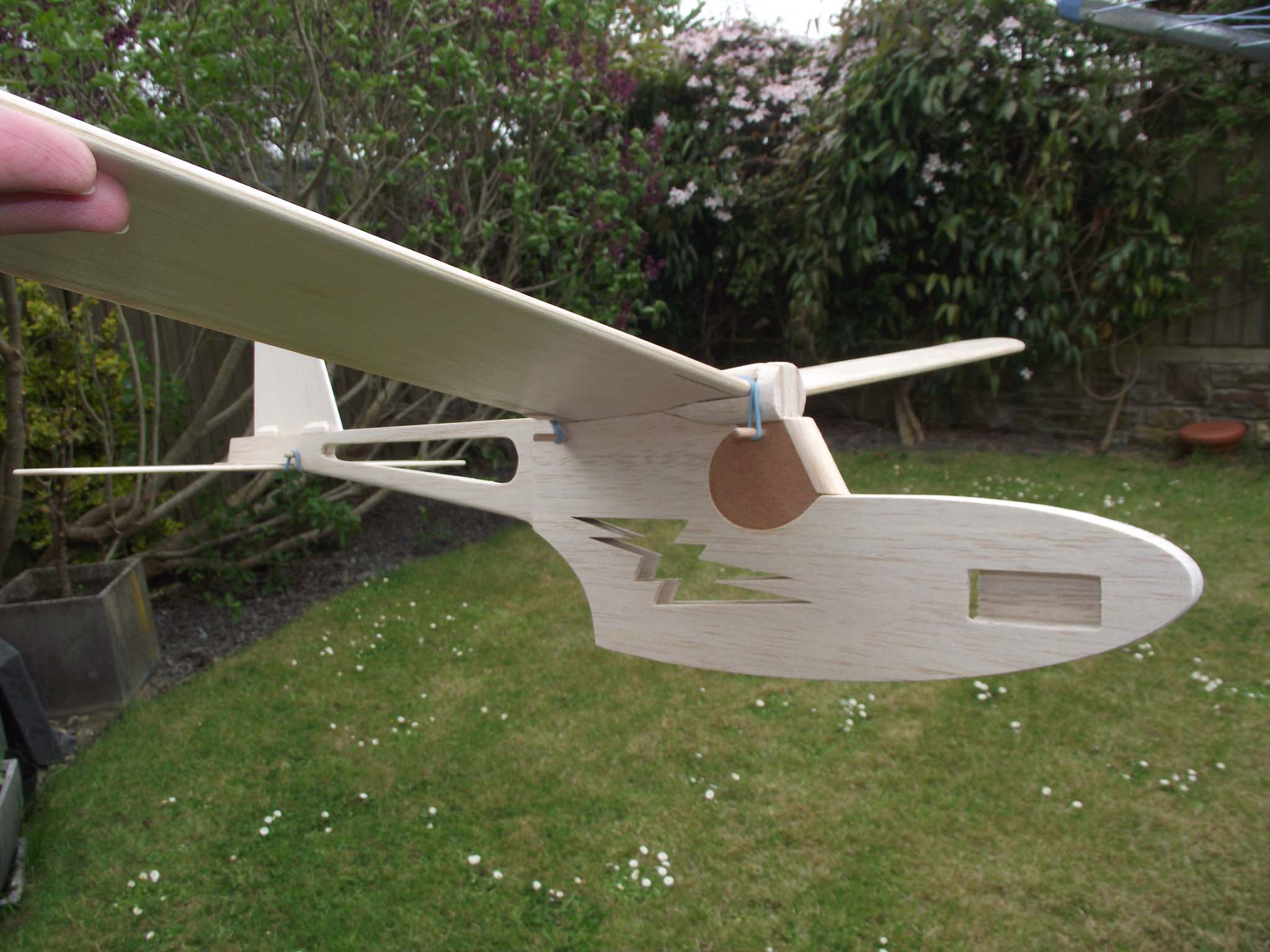

Mine's done.
As finished but without prop and probably a smidge of noseweight it weighs 5 1/2 ounces.
No kit, all me own work! 'onest guv!
Gary
Gary

Very nice.
Where's the battery bay, and what's the access method to insert / remove the battery?

Gary....As always, cracking job mate.
Martin.. our antipodean friends are well above the curve. I have it on good authority it uses wireless charging - like mobile phones and employs a boomerang GPS module so it can never fly away and can be used to get a spot of hopping lunch for the Barbie

Gary, that's a great colour scheme you've done there - like that very much.
Carl

'Nice job, looks great....... Good on ya!

Thanks for the nice comments chaps. There is no hatch, everything fits (just!) inside with access under the wing.
Decoration is gift wrap type tissue doped on in 'aqua' and 'magenta' with black patches under for visibility, background is plain balsa. Wings are two piece for ease of transport and I'm going to pop it in the post and get uncle Shaun to fly it proxy for me at Ponty then hang on to it for when I (eventually) get there.
Sound like a plan?
Gary
Sound like a plan?
Gary
