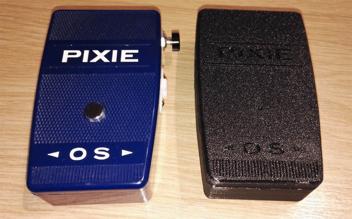

Finally, I'm feeling too despondent to do a separate post on the progress on the 3D printed OS Pixie MK2 case, so I'll do it here.
Printing the lid is getting beyond my ability (or at least the ability of my modified Velleman K8200). Or maybe it is the slicing program I'm using, as the detail on the printed lid is not replicating what I've drawn and seeing in 3D viewing programs. And worse, last night I decided to upload the STL file to get it printed commercially and three different sites say there are manifold errors in the STL file. I didn't know what a manifold error was until I looked it up on Google. And I found nothing on how to avoid manifold errors when using OpenSCAD. So is it the manifold errors causing my printing problems? Or is the detail too fine to 3D print?
Maybe I should have taken Neils advice and used a different 3D cad program. Hopefully, I'll get enthusiasm back before the weekend and have another go at printing it using different settings and take it to Ponty.

regarding your OS Pixie MK2 case, I would like to give it a try. The budy, who is doing the 3D-printing for me, is quite experienced and we got very good results when printing my Futaba FT-3 case. Maybe we could improve the printing quality on your case.
