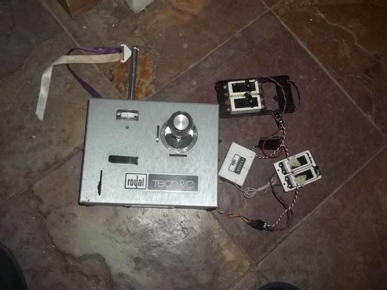

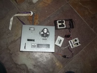

Just found yet another one complete with RX and servos!
Re: Odd Ball - Single Stick Radios
The servos look like D&R Bantams - were they standard with Royal sets?

You will need some one more knowledgeable than me I'm afraid.

Yes, those are D&R Bantams. Nice little servos, got four myself! They were in my original Lark helicopter until five or six years ago, when I replaced them with more modern JRs. Still work well...

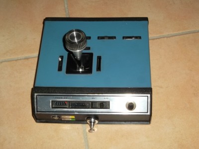

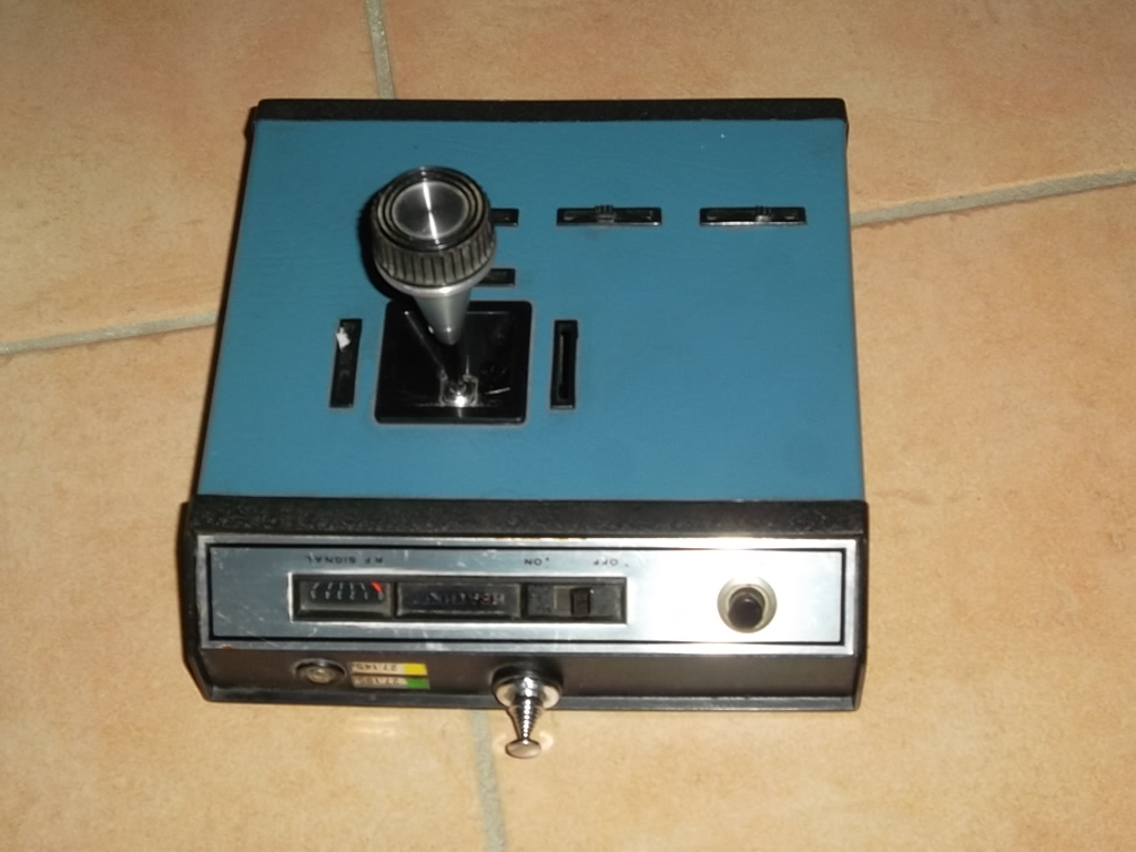

Just working on a conversion of a Hesthkit Single Stick 8Ch Radio.
I am using only 7 channels, 6 propo and one switch channel.
It is working nicely now with a 35MHz HF unit and I will add an Orange 2.4G modul as well.
The TX had the option to switch between two sets of crystals using a switch in the front. I will use this switch to change between 2.4G and 35Mhz.
The heart is a DIY Strong Board with mixing option and single channel emulation (trainer button) using a modified 7Ch sketch from Phil .
To replace the wiring for the rudder knob was the most difficult part of the conversion.
Works well on 35MHz on the workbench and it sure will on 2.4G as well. Flighttest in the near future. Frank
