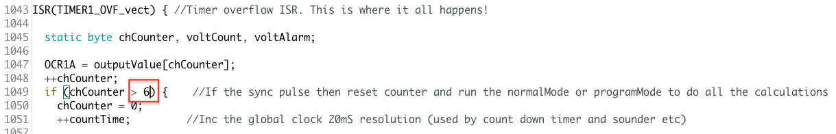

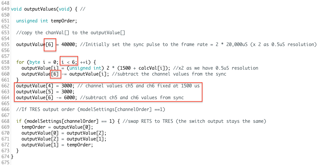

Don't know if you have read about my problems with the Flysky RF module ( viewtopic.php?f=62&t=695), but I have a hunch that the 4 channel format of the ppm stream is the culprit. Preliminary testing with a 6 ch source has shown some improvement, so I have modified your sketch to a 6 channel output. Can you please check and confirm that the changes below are all that is required, and I have not overlooked anything?
(the vertical line after the "6" is the cursor position)
Max.
Edit: Something must be wrong, Phil's pulse analyser shows a single pulse and a frame rate of about 25 ms.
Edit2: I found an error in line 658, "i < 4" should remain as it was. I'll test it again later, I am going out to fly something now :D
Edit3: error corrected, but result does not change, still a single pulse (about 670 us) and 25 ms frame rate.

I'm away from home this weekend and only have my phone, so it isn't so easy to look through Arduino sketches. I didn't have a copy of the sketch, so I've downloaded it from this forum. One thing I noticed in your code alterations is you hadn't increased the variable array size, it now need to be:
67. volatile unsigned int outputValue[7]; //define array size to number of channels + 1 (for the sync pulse)
Try that and see if it fixes it.

Pretty basic stuff, I should have found that, duh.. :oops: The code now generates a nice 6 channel ppm stream.
