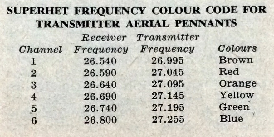

Next, as early as Feb 1962, RCM&E published a newly-adopted crystal “protocol”. The adoption of this (Brown through Blue) enabled those with superhet receivers to fly 6-up, and no “waiting your turn”.
Essentially, the Tx “colours” were each separated by 50/60Khz, with the corresponding Rx using a crystal 455KHz lower, to produce the intermediate frequency.
Now, at least as late as 1966, Remcon released the “12 Versatile” with a designed tx/rx IF separation of 465KHz. I’m guessing this tied kit builders to Remcon crystals and might have provided a modest reduction in the chance of interference for Remcon receivers, but it would create a problem when “splits” (further dividing up the 27MHz band) were introduced, a few years later. (Indeed, my recently purchased “spare” Remcon Superhet receiver shows sign of its crystal being changed to the “standard” 455KHz separation, at some time).

Most modern single conversion superhet receivers use 455 KHz as the IF frequency. This is largely because that's what the Jaapanese manufacturers used, and their crystals were readily and cheaply available! Early British superhets tended to use 470KHz, and some European manufacturers used 465 KHz.
Trying to retune a set designed for 465KHz to 455KHz is a bit of an ask. It might work, but will probably be on the limit. You might do better with 470KHz crystals - only 5 KHz away instead of 10!
You could always use a Futaba crystal in the transmitter, and get a receiver crystal made. There are lots of places still around making crystals to order. A quick Google brings up http://www.quartslab.com/ or https://www.euroquartz.co.uk/manufacturing/custom-build .Don't expect them to be as cheap as mass produced items, but they shouldn't be extortionately expensive!
Otherwise, you could replace the IF cans with ones designed for 455 KHz, although these are harder to get hold of these days than they were only a few years ago (no-one building their own anymore!).
The channel spacing was not simply a question of the receiver selectivity, but also of transmitter cleanliness! The 50 KHz channel spacing arrived because of the American CB situation. In the USA, 40-channel CB was introduced on 27 MHz, with certain channels being reserved for model control. These channels could not be selected on a stock CB set. The US RC channels were 50 or 60 KHz spacing, so crystals were readily available for these frequencies and we followed suit. However, at 50 KHz channel spacing, you could get away with quite sloppy filtering on the transmitter, without causing adjacent channel interference! Many of us remember certain outfits being unable to cope with even 20/30 "split" channels, due to sideband splatter from some very well known transmitters!
