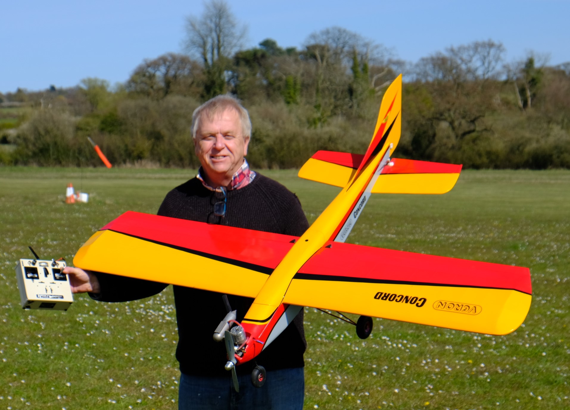

Leon at Belair does a laser cut parts kit for the Concord. He can also put you in touch with Colin Smith (Phil Smith's son) who took over his plans service. Ali Machinski has the pre kit prototype I believe.
Just for bragging rights, I have the 2nd prototype Veron Concord. It was the proving model built from the first production kit by Phil Smith.
No hanger queen it's flown and will do again.

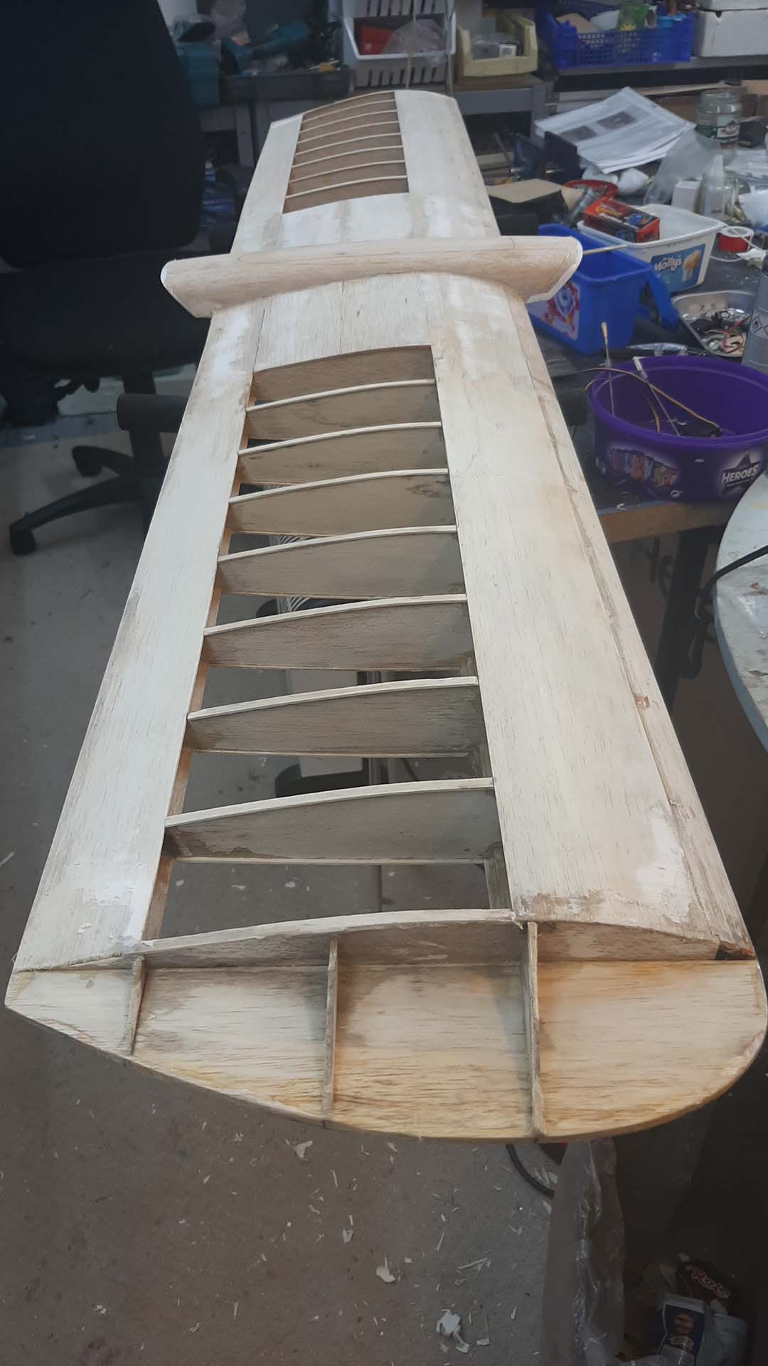

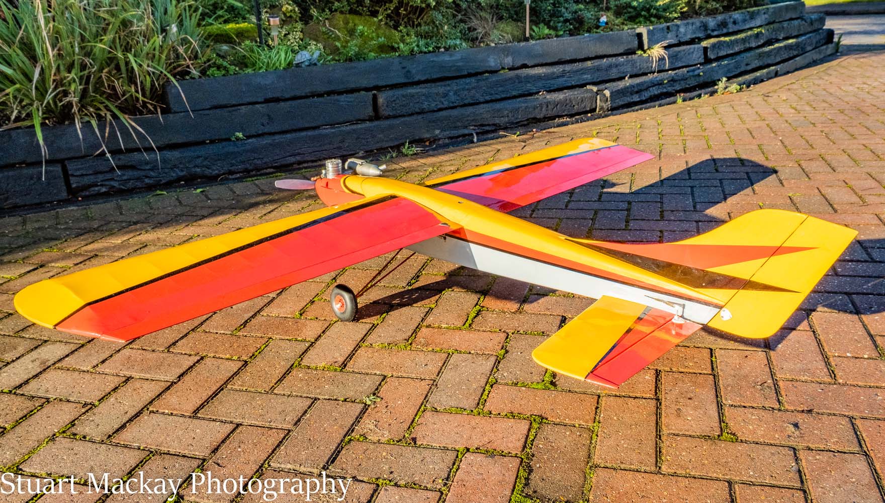

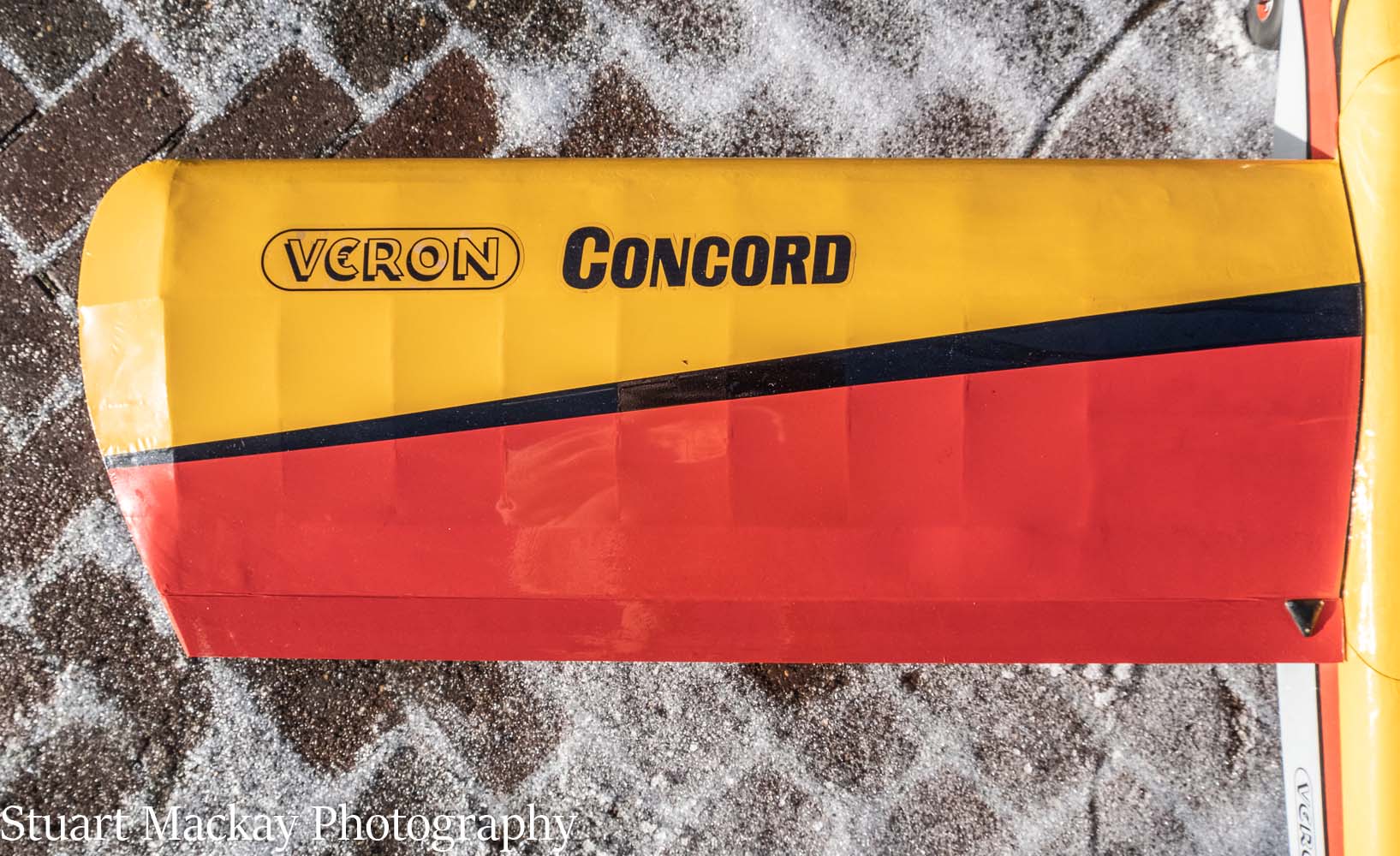

Thanks Shaun, have a model here that needs the ailerons re-engineering.
I wanted to see material thickness and dimensions of the surfaces, can you share that info with me?

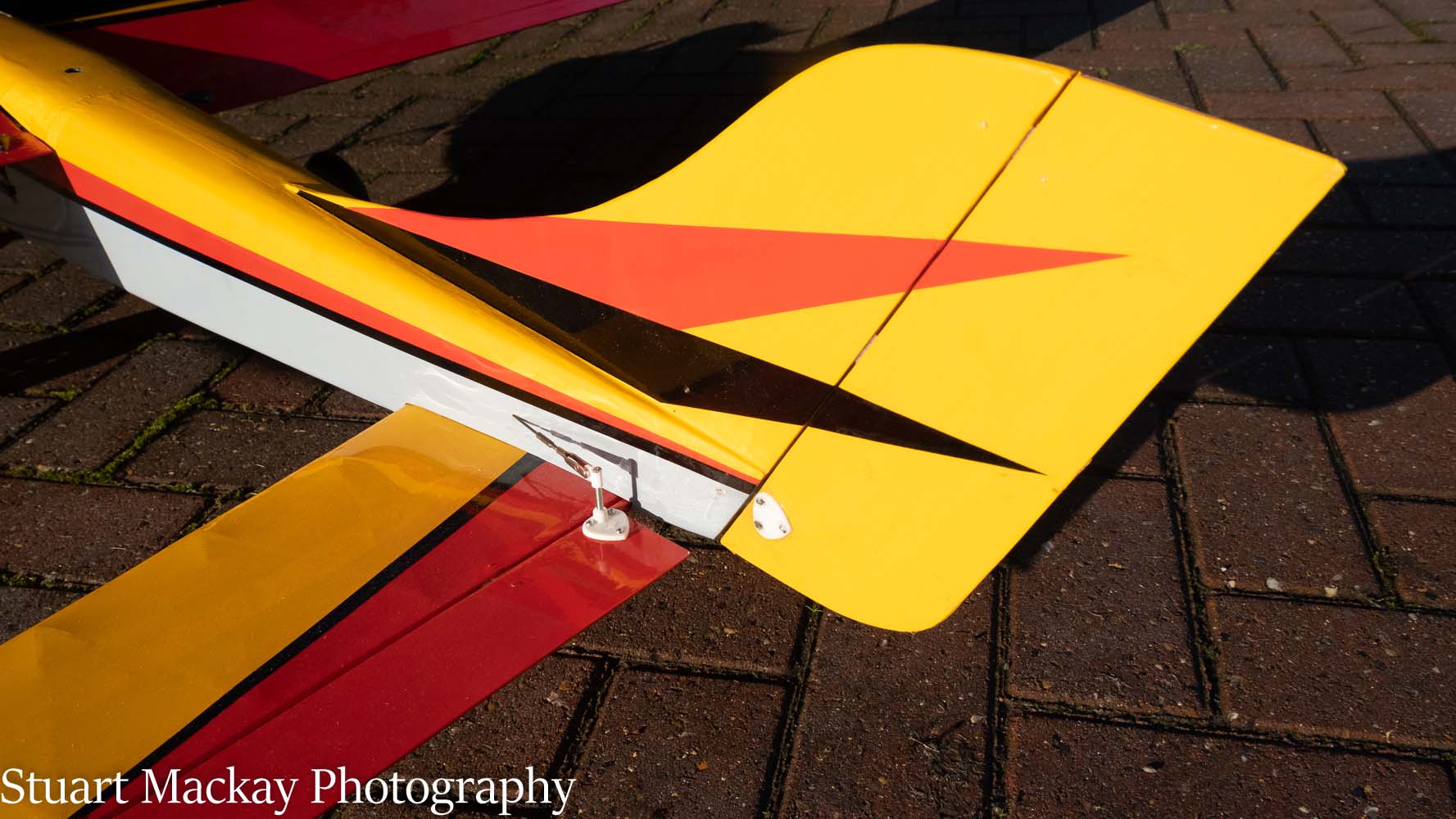

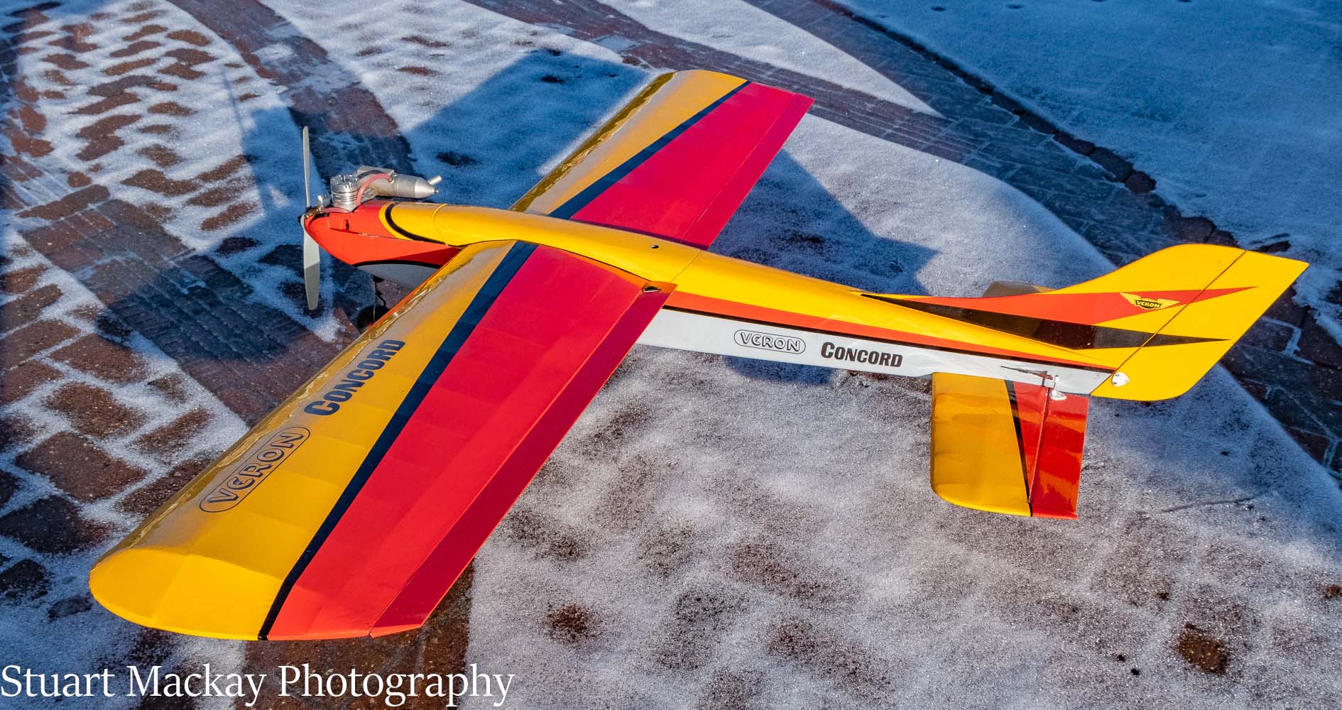

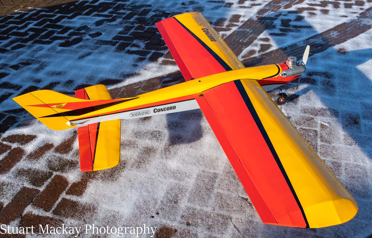

Got Any pics of your one to post here?

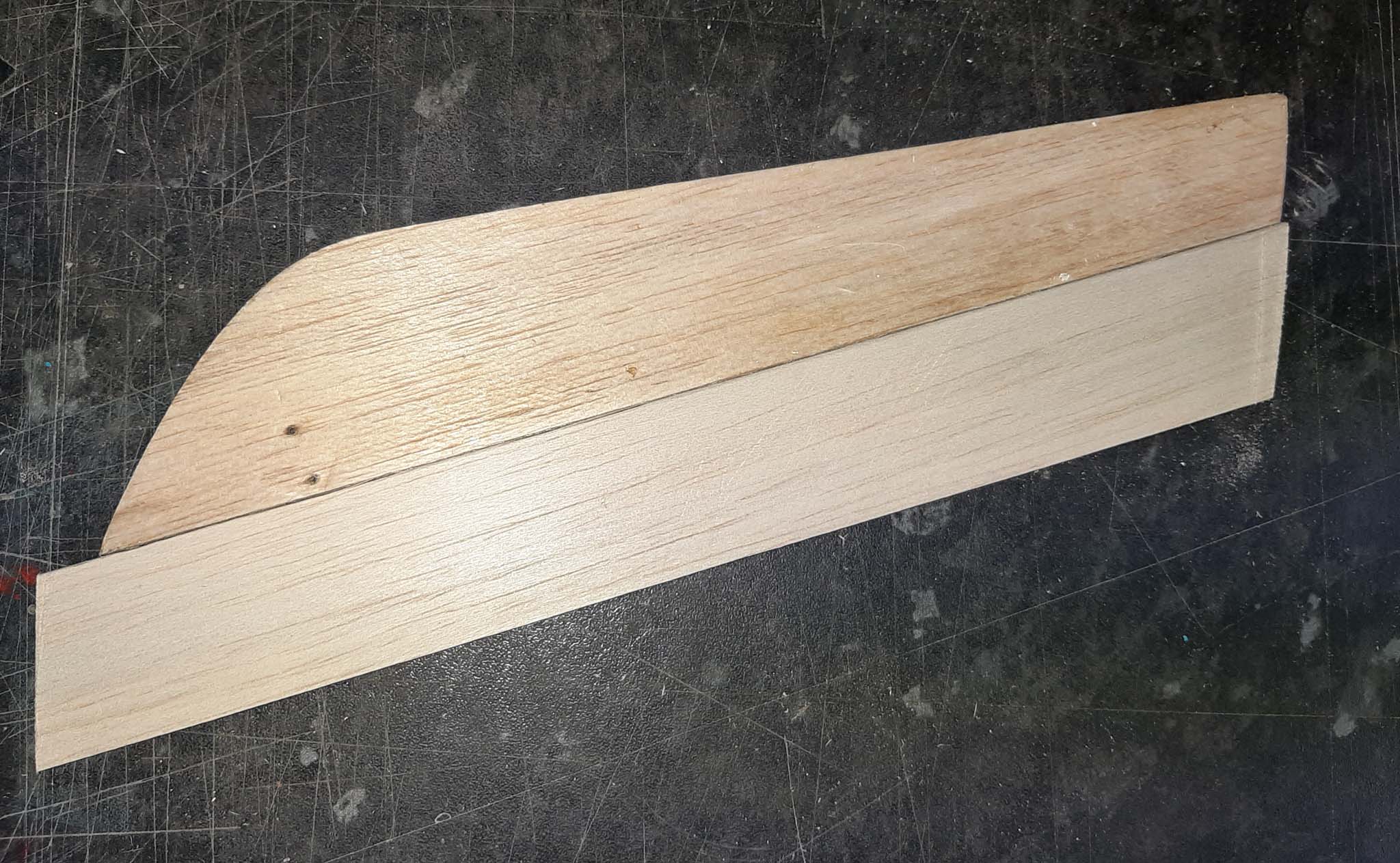

Re: Veron Concord plan
Hi Stu,
Aileron is made from hard balsa:- 1 3/16" wide tapering from 1/4" to 3/32" at the t.e.
C of G is:- 4 5/16" from leading edge.
- Posts: 606
Thanks Shaun, think I can make out what I need from the pics!
Stuart

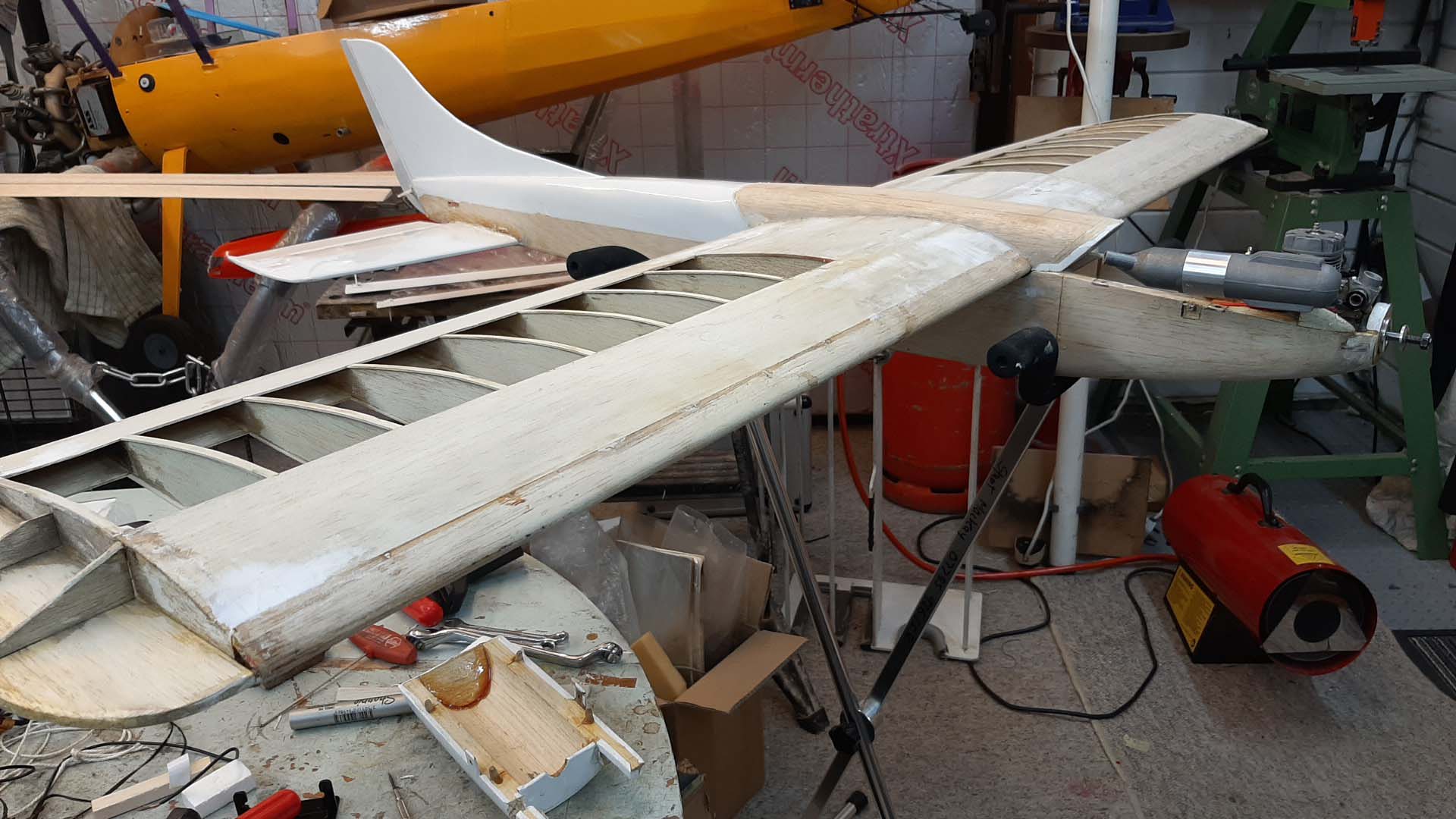

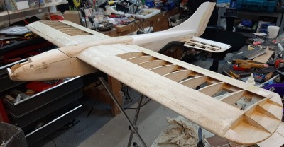

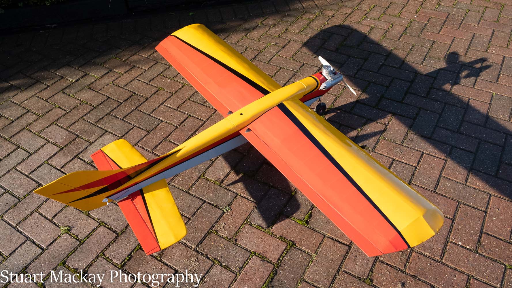

- Posts: 606

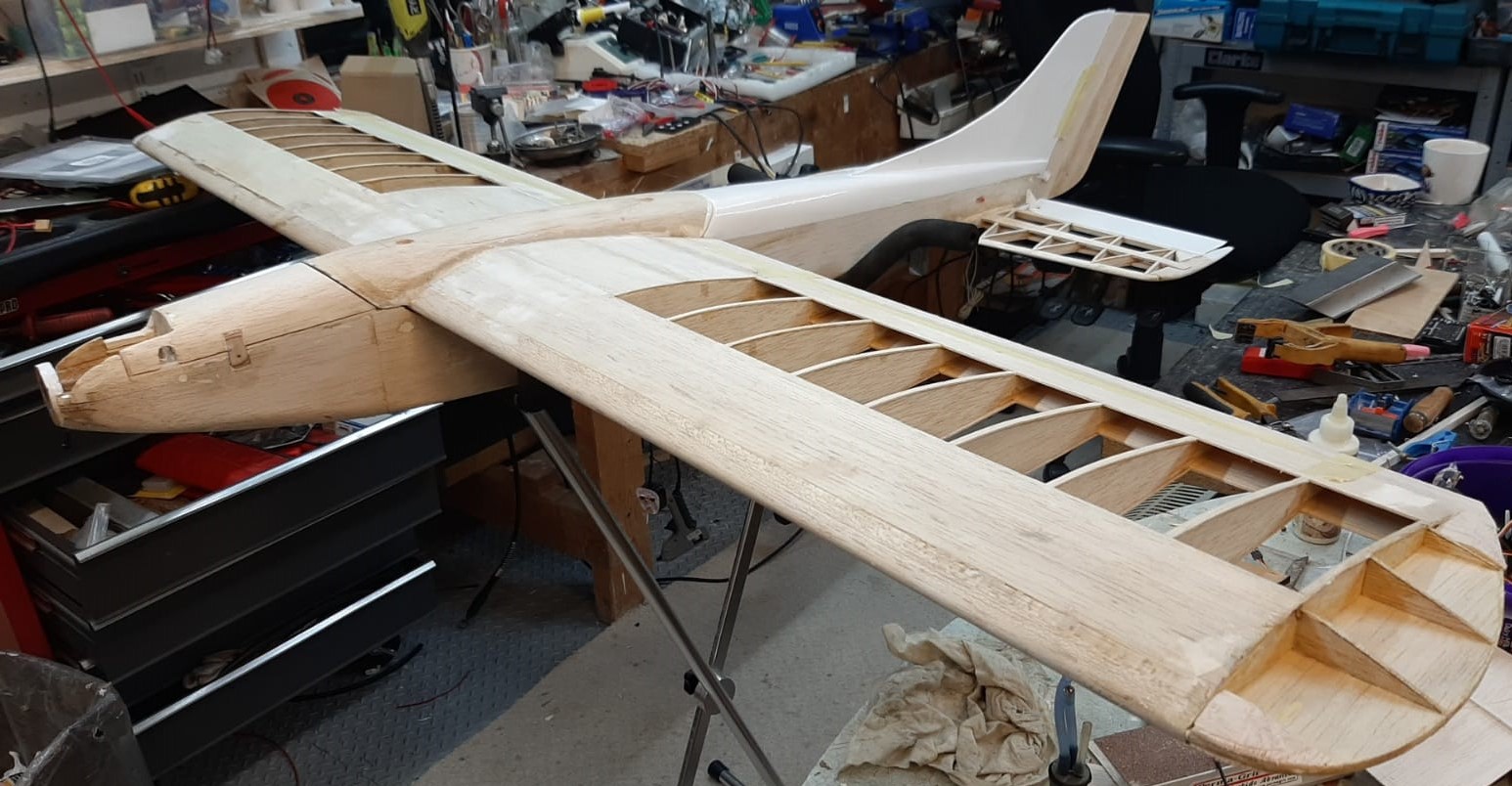

Thank God, I stripped the covering off, as one wing tip was soaked and going mouldy inside the covering.
Letting it dry out completely and some bleach took all the black mould out of the wood.
Progress so far.....

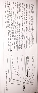

- Posts: 606

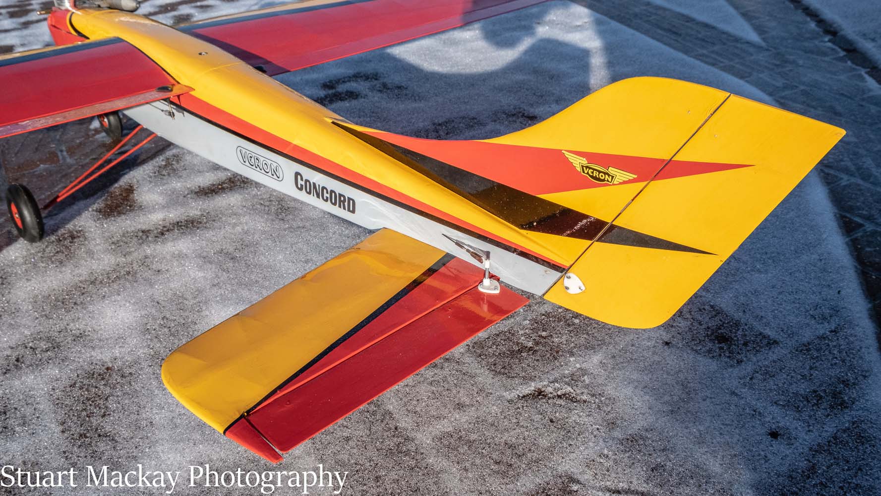

Extending the rudder area for more authority
- Posts: 1254
Plan rudder worked fine on original one be Stu. Plenty of authority.

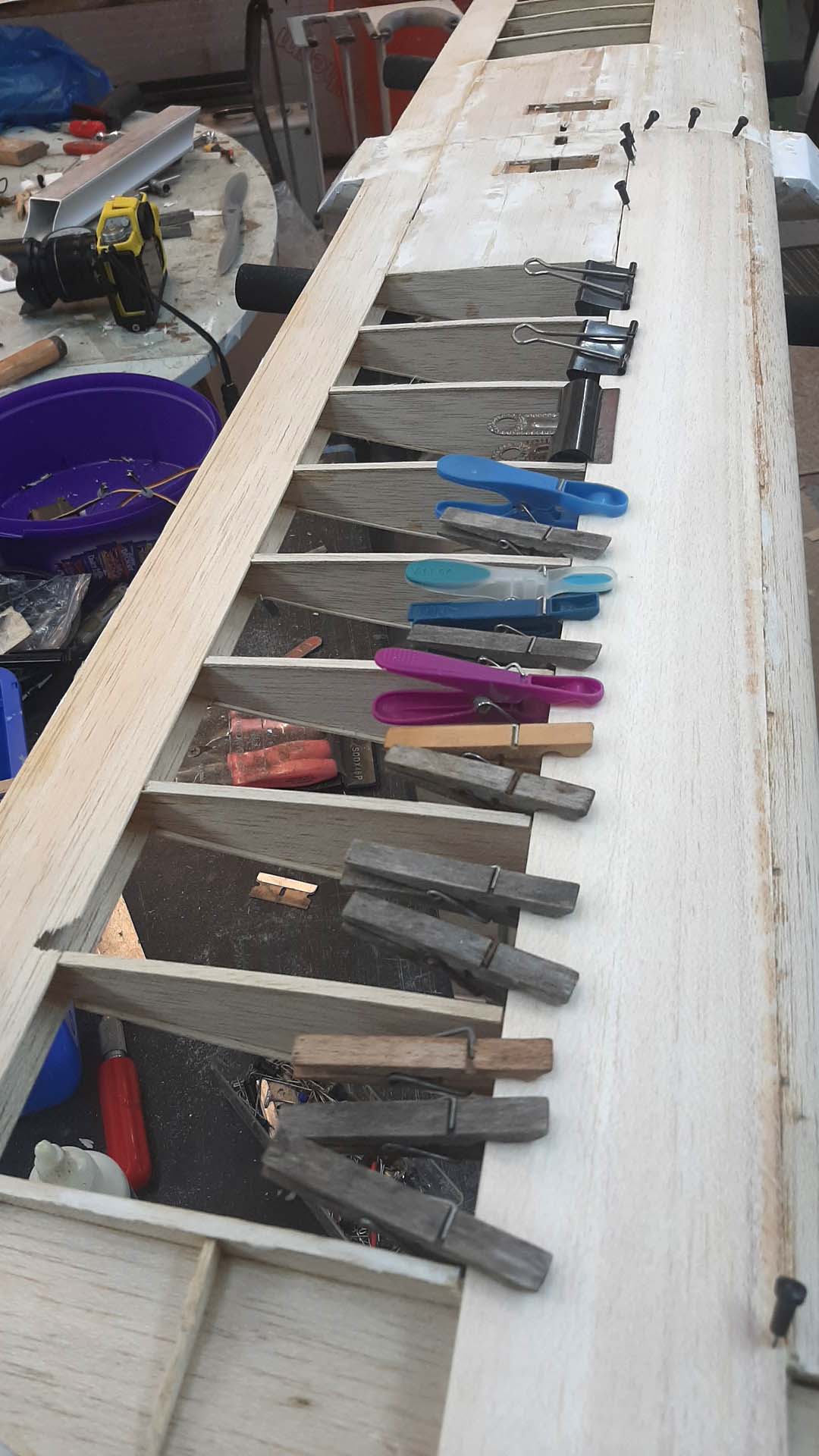

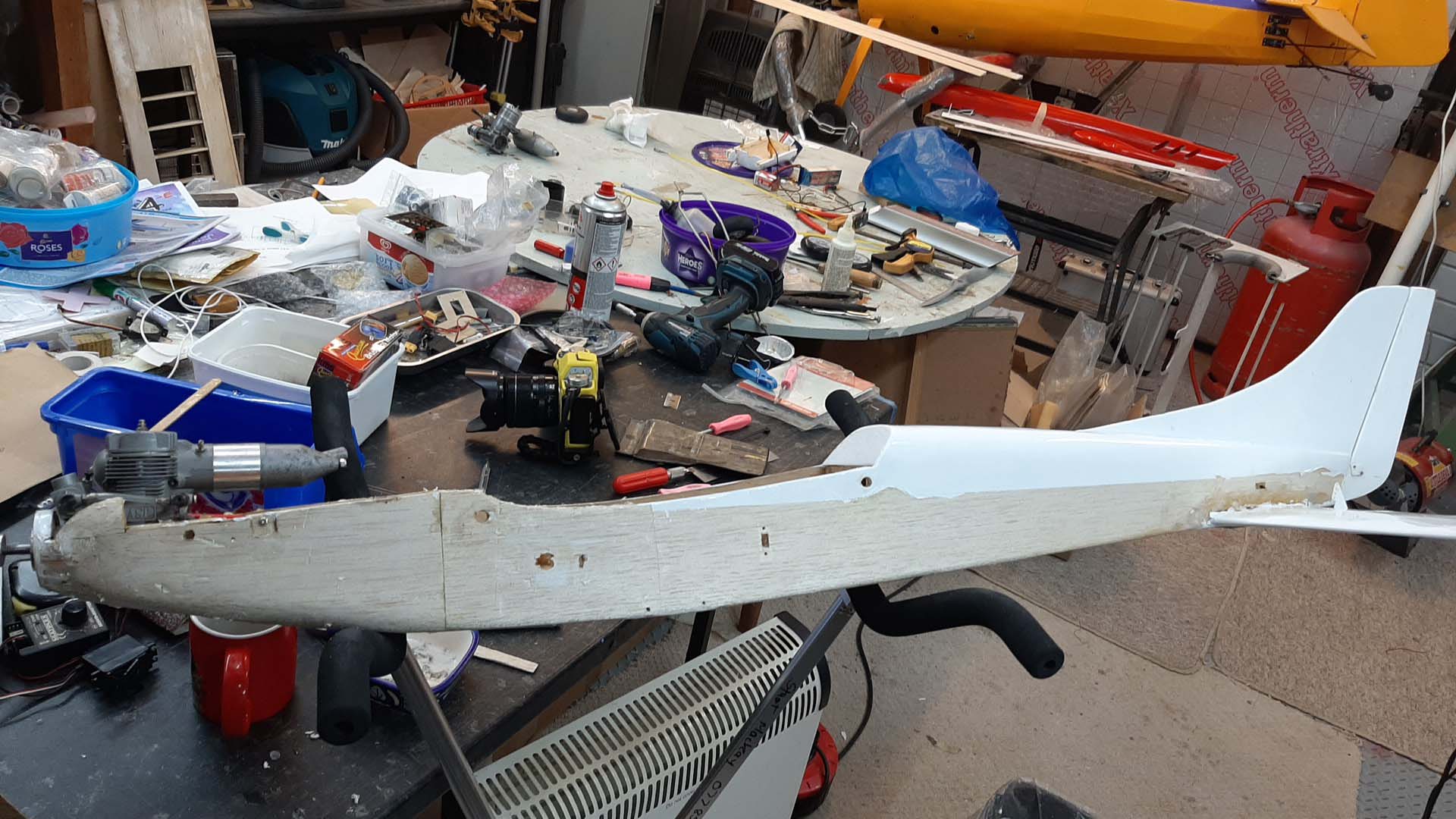

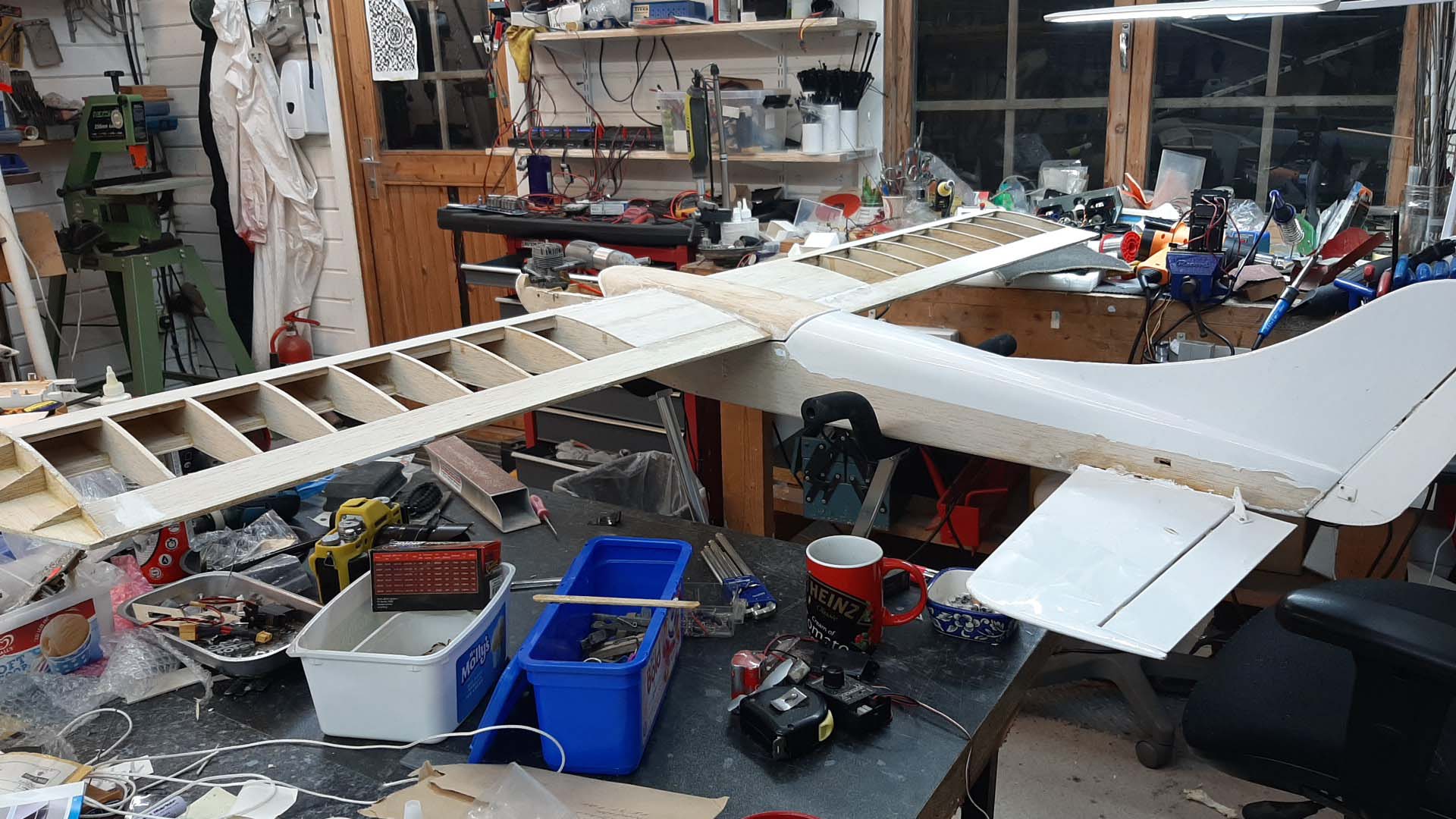

- Posts: 606

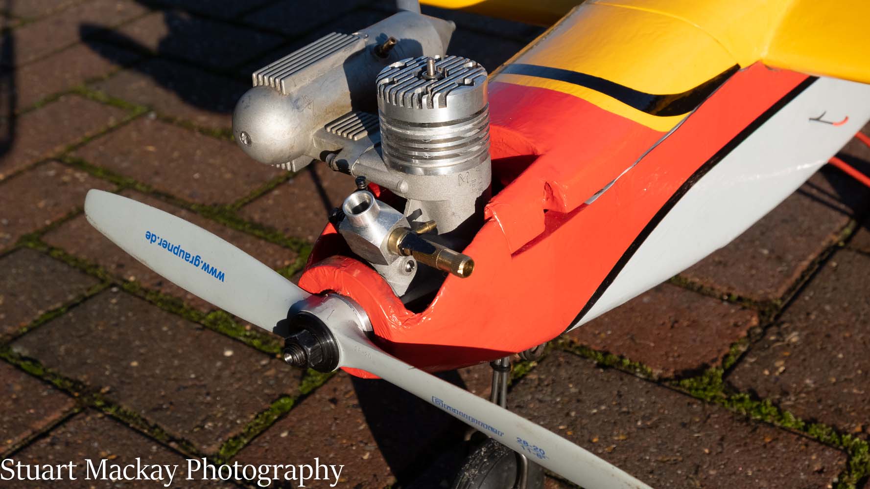

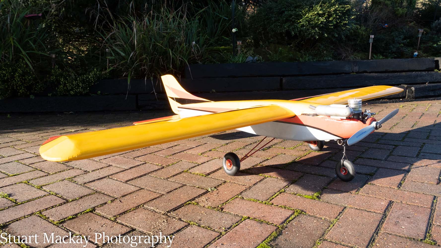

Slow but sure progress in the Swaffham balsa dust factory!
Covering getting perilously close after removing the glued on stab and made into a bolt on affair as I have done with the wing.
New ailerons fabricated and wings fettled and fuse/tail/wings all +realigned.
Am pretty sure the airframe has been built from an original kit many years ago judging by the amount of spindle moulded components in the fuselage structure.
