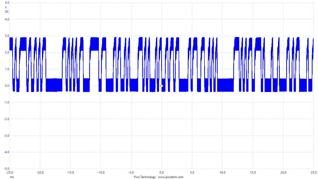

I assume the hash on the signal in this diagram is just RF pickup from the 72Mhz getting back into my scope probe and not a digital code added on top of the 1.5ms frames.

PCM is different though. It uses high/low pulses in a frame, just like normal PPM, but the information is different.
With PPM, it's the time difference between the leading edges of successive pulses that gives the position of each channel. Some brands use the trailing edge of the pulses instead - but that doesn't usually make any difference because the narrow pulses are usually all the same fixed width.
With PCM a pulse is either wide or narrow, and this contains "one bit" of digital information. The exact timing doesn't matter: Simplifying, we could say that if a pulse is less than (say) thirty microseconds, it's a "0", and if it's more than thirty microseconds, it's a "1".
The Receiver assembles those "0" and "1" bits to give a number, and the number specifies the position of a channel. The number of bits in the number sets the resolution - and that's why you see names like "Futaba PCM 1024" which uses ten-bit numbers that resolve 1024 discreet positions.
The PCM encoding uses other tricks - Futaba used to send the "main" channels 1-4 more often than the "auxilliary" channels 5 and up - and it would occasionally also send the fail-safe positions for each channel, which the receiver would remember in case the signal was lost.
Another trick was to add a checksum. Imagine I'm sending you 8 numbers all in the range 0 to 1023. To check for noise, I could send you a ninth number that you're not actually going to use other than as a check. I would work out that ninth number so that when you add all nine numbers together, the answer is some exact multiple of 1024 with no remainder. You can then add all nine numbers together and if the sum isn't an exact multiple of 1024, then you know that the packet has been affected by noise, and you can carry on using the previous good values until you either get a good, error-free, packet, or give up and go to fail-safe.
