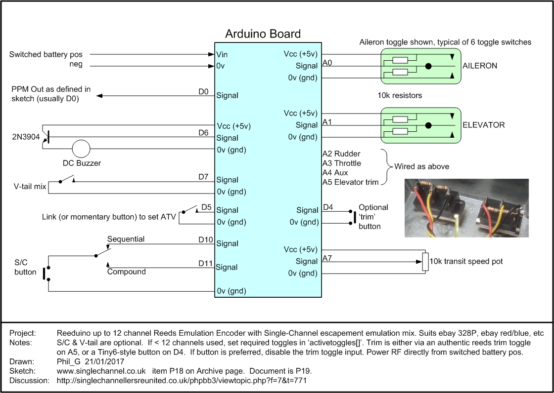

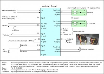

Edit 21/01/2017: Added a brief document and diagram

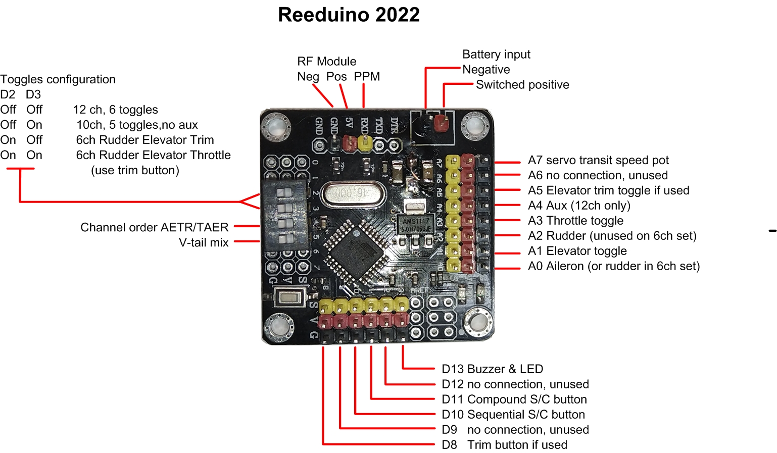

Edit 19/06/2022: active toggles configuration, channel order & Vtail mix moved to a dipswitch

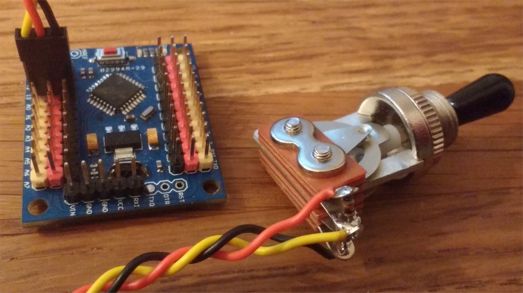

The 328P board on the other hand is complete and readily available from ebay for £3 or thereabouts, and it becomes an easy DIY project.
Easier and cheaper Image
Oh dont forget that A4 & A5 are switched around on the 328P board, thats the aux & trim toggles in this particular case.

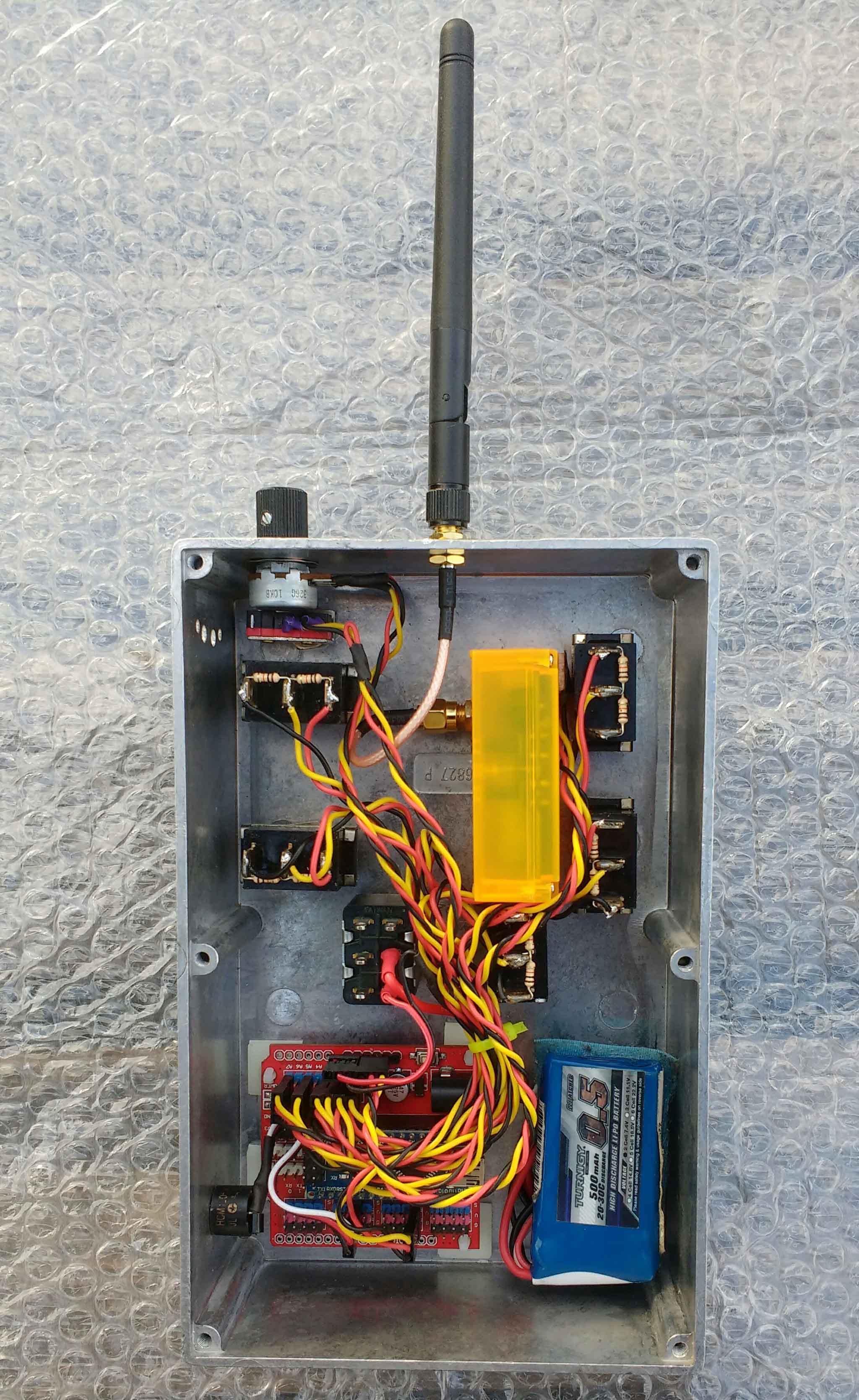

I'll write some notes asap. Here is the case I used: https://uk.rs-online.com/web/p/general- ... es/1610919
The sketch has the single-channel emulation option, D10 is sequential (button to ground) and D11 is compound. I use a 2-way toggle switch to connect the single-channel button to one or the other. Select which toggles you have wired if you dont have all them connected, as in say a 6ch or 10ch set.

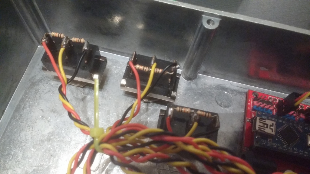

I feel I have to explain the use of resistors and to make it clear that this is not "propo with switches instead of pots" :-)
The only reason for using analogue inputs with the resistors centre-biasing is to enable 3 'digital' positions to be read by one input pin. It makes the cabling easier and its more economical on processor input pins - the three toggle positions are not in any way linked to servo outputs, or to the resistor values.
Each input is quantised to 3 states: 'left toggle', 'right toggle' or 'neither'. To do this I use just the 2 most-significant bits of the ADC, which are translated as:
00=toggle thrown one way, signal line less than 1/4 rail, typically at ground 0v
01 or 10 =toggle at neutral, signal line is between a quarter to three-quarters rail, typically around half (2.5v)
11=toggle thrown the other way, signal line above 3/4 rail, typically the full 5v
Anything from 1/4 to 3/4 rail is seen as the toggle at neutral, this completely eliminates any resistor tolerances.

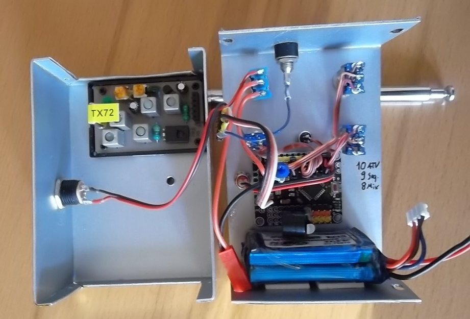

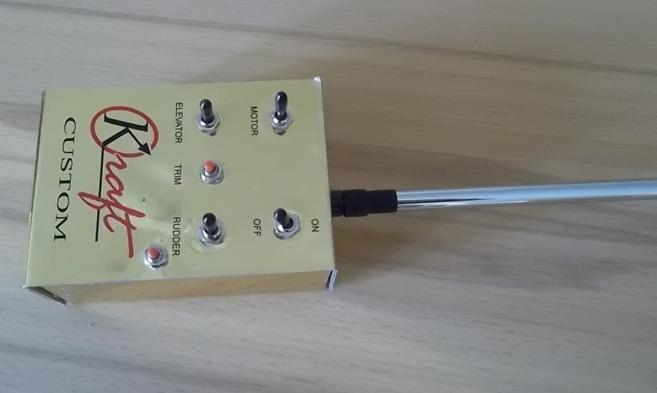

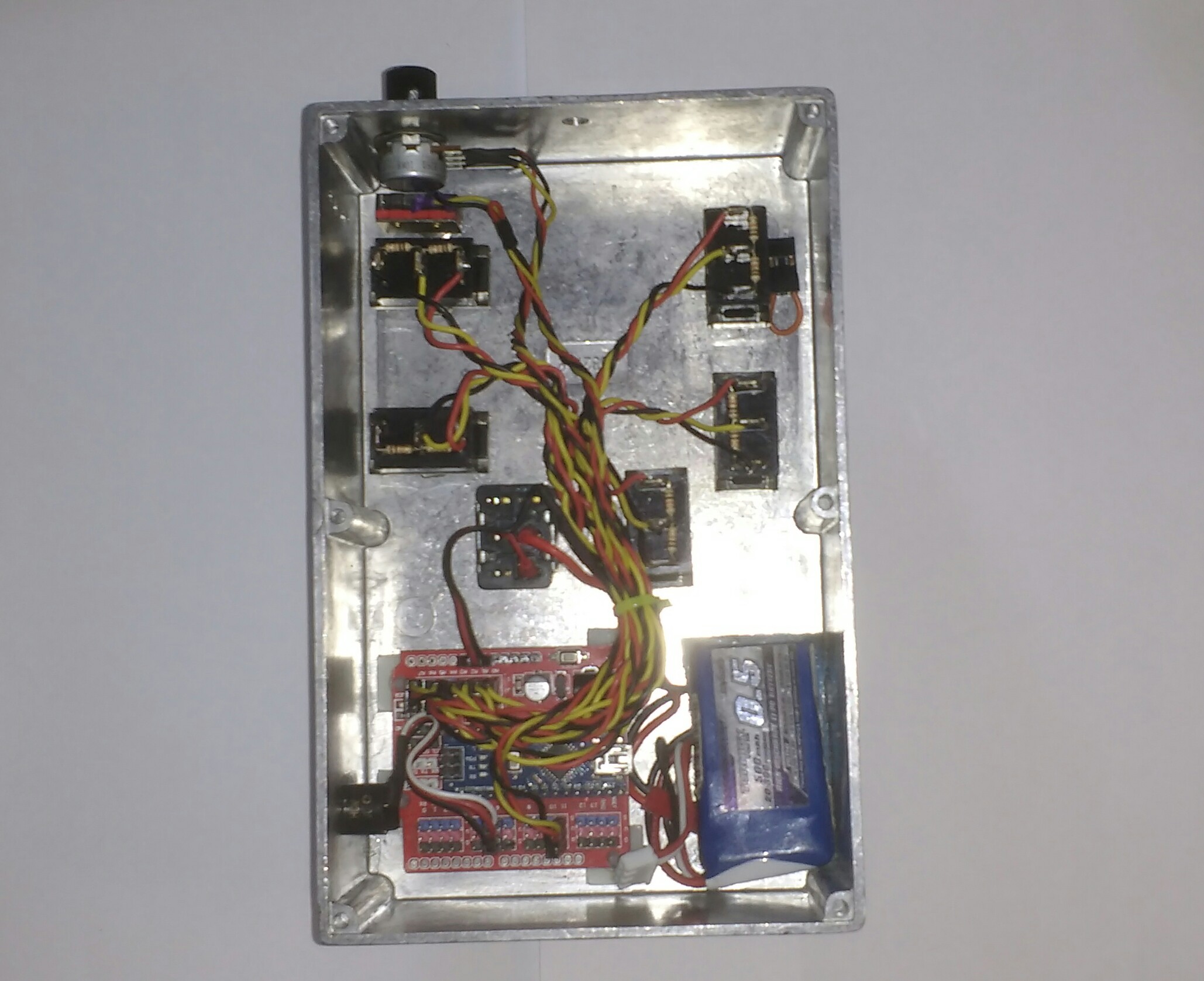

The next Reeduino version is ready for test-flying.
It is a Kraft Custom 6 replica using the Reeduino with S/C emulation and all the bells and whistles like ATV, mixer etc. but only 6 channels and a trim button like the Tiny6.
RF is a Jamara 35MHz module, power comes from an old 2S lipo, and because it is old and worn, no ballancing during charging.
Works great here at home, test-flying next week will proof its reliability.
A 12 channel version will follow in the near future.

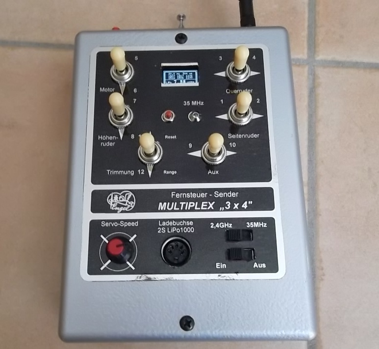

Postby tiptipflyer » Sat Jun 10, 2017 1:09 pm

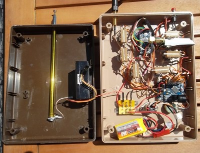

Hi Guys,
my Reeduino 12 channel transmitter is almost finished. I just have to add the S/C button, the ATV button and a mixer switch. The rest is ready to go and already tested. The flight-tests were very succesful, no problems at all as expected.
I was flying a Goldberg Slylane 42, a Hegi Fechdax, Ken Willard´s Roaring 20 and Schoolboy. A great radio. I chose the Engel Multiplex 3x4 replica design for this one.
It features both Spektrum 2.4GHz and Futaba 35MHz to be as versatile as possible, just a flip of the switch.
The Oled display shows the battery voltage and transmitter name and by pushing the tiny red button also the pulses for all six channels in numbers, so you can always can see what is going on.
One Arduino pro mini is powering the display and a second Arduino is powering the transmitter part. Power comes from a 2S Lipo.
Many thanks to Phil for the transmitter software and to Ron and Martin for the display software.

// two examples: ail,ele,rud,thr,trim for a 10ch reed tx, activetoggles[] = {1,1,1,1,0,1,};
// ail,ele,throttle for a 6ch reed transmitter using the Tiny6 trim button, activetoggles[] = {1,1,0,1,0,0};
const bool activetoggles[] = {1,1,0,1,0,0}; // Tiny6ch.
//  const bool activetoggles[] = {1,1,1,1,0,0}; // 8ch, with trim button but no trim toggle
//  const bool activetoggles[] = {1,1,1,1,0,1}; // 10ch. 1 for the toggles you are using, 0 for unused ones,
// const bool activetoggles[] = {1,1,1,1,1,1}; // 12ch. this prevents unwired ones reading randomly
Note that in each case, the line we want has had its '//' prefix removed, and all the lines we dont want are commented out by the '//' prefix.
Re: Repost: Trad 12-channel reed encoder "Reeduino" with S/C emulation
This is a small update to the Reeduino project for new builds, please note that there is no advantage in updating a working transmitter as functionally nothing has changed. All I've done is to put the four most popular activetoggles configurations, the channel order (AETR or TAER) and the V-tail mixer on a dipswitch. This means theres no editing of the sketch to suit your configuration, the one sketch suits any just by flicking switches.
Of course the actual wired toggle configuration has to match the switch selection, see attached diagram :-
12ch with aux, thats 6 toggles - ail, ele, throttle, rudder, aux & trim toggle
10ch without aux, , thats 5 toggles - ail, ele, throttle, rudder, & trim toggle
6ch , thats 3 toggles - ail, ele, & trim toggle for gliders,
6ch again 3 toggles for IC - ail, ele & throttle using the trim button idea from the Tiny-6.
The ATV, S/C mixes, Vtail, transit speed, sweep & trim button options are unchanged other than I've had to move a few connections, other than that the original Reeduino P19 document still applies, for new builds just substitute the new connections until I get the document updated.
To emphasise please note that there is no advantage in updating a working transmitter as the overall functionally is unchanged, this is just a neater way of selecting configuration options without changing the sketch :)
PS if you prefer, of course the dipswitch can be replaced by headers & links (spektrum bind plugs) - but for config that usually is only done once, dipswitches are ideal.
