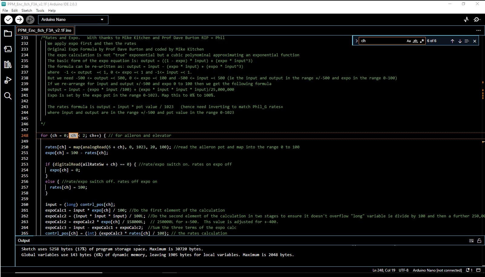

I had never tried compiling the encoder sketch with the latest Arduino 2.03 as I've stuck with the older 1.8.19 as the latest version just takes so long to fire up compared to 1.8.19 (and I have a reasonably fast i7 SSD PC). So I fired up 2.03, and it compiled PPM_Enc_8ch_F3A_v2.1F without a problem (see screenshot below).
So we need to work out what you are doing differently to me and many others.
What line number is highlighted when you get your compilation error? When I search for "int ch" in the sketch I only find it's defined once on "line 76", could you have accidentally duplicated the line?
Next what "board" have you selected? I use MCUdude minicore, but I re-tried with the "vanilla" Arduino AVR Boards and selected Nano and ATmega328P and again it compiled OK.
Finally, if you still have problems, upload the sketch you are trying to compile and I can try to compile it and compare it to what I have in case yours has got corrupted somehow.
