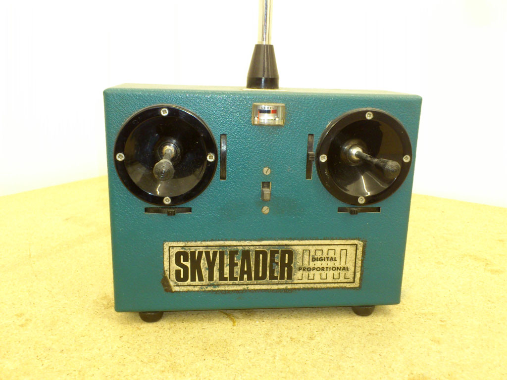

Well I have just bought another transmitter from our dear friend EBay! This time a lovely Skyleader Clubman Super. It was pretty clean but A bit more scrubbing and it’s come up lovely. As soon as I opened the box I had a twiddle of the sticks as you do. I noticed immediately that they were stuck on one axis. Now usually this usually signifies bad internal corrosion, however opening the back it’s beautifully clean but the stick units have been glued up and pots removed so they only operate on one axis each. The right-hand stick left and right and the left hand stick up and down. I fully expected to see it made off as if it had been done by a previous owner but now I’m completely confused because the encoder board only has two channels and the receiver a blanked off section for the remaining channels - In Other words two channel only. It’s a late date version of the club man super with an FM 35 MHz board. I want to run this at least four channel so I’m going to have to add one of Phil's encoder boards or Rob another encoder board from something else less desirable ! Has anyone seen the like before?

Hi Jonathan. I don't think it is an oddity at all, you've bought yourself a Skyleader 2 channel set and it is how it came out of the factory. I've got a 2 channel Skyleader CS AM set in my collection and it's Tx encoder board is similarly only populated with components for 2 channels, the joysticks have been glued into the centre and no pots were fitted for the unused channels. Oh and the trims have been cut off flush for the unused channels. What confirms you have a 2 channel set is that the RX is 2 channels as well. Skyleader made a big thing about buying 2, 3 or 4 channel sets and being able to upgrade them to 7 channels, but in practice most people bought 4 channel sets unless they flew gliders. But sets only used for gliders tend to be cleaner than those covered in glow fuel.
Without new joysticks I think you'll struggle to modify it to 4 channels or more. Maybe somebody on the forum has some spare Skyleader joysticks? If not you often see Fleet Custom 2 FM sets (the black ones) and they use Skyleader (SRC) sticks. They come up on eBay far more frequently and are usually cheaper than Skyleader CS sets too. The other advantage of using Fleet sticks is that the Skyleader CS sticks had really strong centring springs, that make them feel really heavy if you normally fly with more modern sets. The Fleet sets used the same weaker springs that the Skyleader TSX used. I fly with a 2.4GHz converted Skyleader SLX as my everyday transmitter and I quickly fitted some spare TSX springs that made a big difference. I also shortened the sticks by about 15mm in length, to make them similar in length to a modern set such as a Spektrum, Futaba or JR.

Thank you thats MOST interesting! Mike you are right on the money Its a set out of a glider and flown twin stick. I just couldnt see the economics of making a two channel set in a 4 channel box.
I have already converted it to the full dual axis sticks - Right again Mike I used surplus Fleet spares and noticed along the way the softer springs - Another tick Mike!
It now has the smoothest sticks of all three of my Skyleader outfits.
I have a spare Futaba challenger encoder board but its near impossible to fit into the Skyleader case. So i am most likely to use Phil's 7 channel propo board which I already have in my possesion. All I need now from you guys is pointing in the right direction to find the right circuit diagram to hook it up. I am assuming Phil has already pre-programmed the board??
I am a bit of a purist as I really like the sets to retain their original innards as much as possible, and their outward appearance. I love the telescopic aerials of 35 and 27 and indeed still fly on 27mhz.

Here is photo of the completed sticks with Fleet bits added so I now have two dual axis joysticks

Jonathan. I've probably got enough spare components to populate your existing encoder board to 4 channels if you want to keep things as original as possible, but you would have to set up the timing for the half shots for the new channels.
I've also got an untested encoder board from a Skyleader TSX, taken out when I fitted one of my encoders a while back. It would fit straight in, but would need some re-wiring as it had the dreaded "black wire".
I've got a spare 7 channel Skyleader 35MHz FM Rx if you need, though you should find the other channels are in your Rx, except that the servo connectors are not fitted. I'd be a bit cautious of using old SRC-1 servos as some of mine have the output arms getting quite brittle.
If you wanted to be ambitious I could let you have details of my encoder, then you'd finish up with a 10 model memory computer transmitter, with similar features to a Spektrum DX8, except no heli mixes, no telemetry or spoken alarms, but with single channel compound and sequential added. It's got aileron differential too. I use my Skyleader SLX and Micron PL7D as my everyday transmitters to fly most types of fixed wing. Over the weekend I flew my Junior 60 (using S/C compound emulation), a warm liner glider, a 4 servo wing powered glider and a Multiplex foamy 3D. This evening I flew my Bonsai flying wing with LED's so as you can see, you can use it like a modern computer set, yet all the nostalgia of a 1970's transmitter. And you can practice your S/C flying.
Finally you asked about aileron differential. Don't forget that you can get differential mechanically by using a servo output disk instead of a servo arm and connect up the aileron linkages either in front or behind the centre line.
