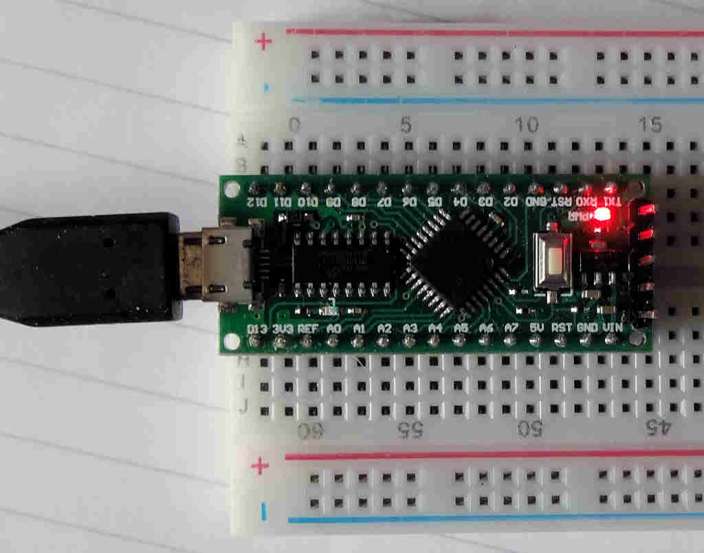

Received my RF-NANOs today - the ones with the LGT8F328P chips, as recommended by Flynn. :)

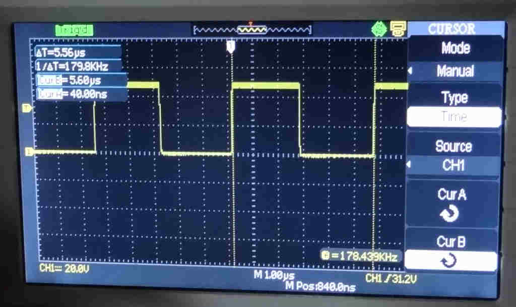

And that does a complete cycle (high and low) in 5.56 microseconds. Now we try adding the 'shift into high speed mode' described by Ralph in his video. This just means adding one #include and one call to set the clock_prescale in setup():

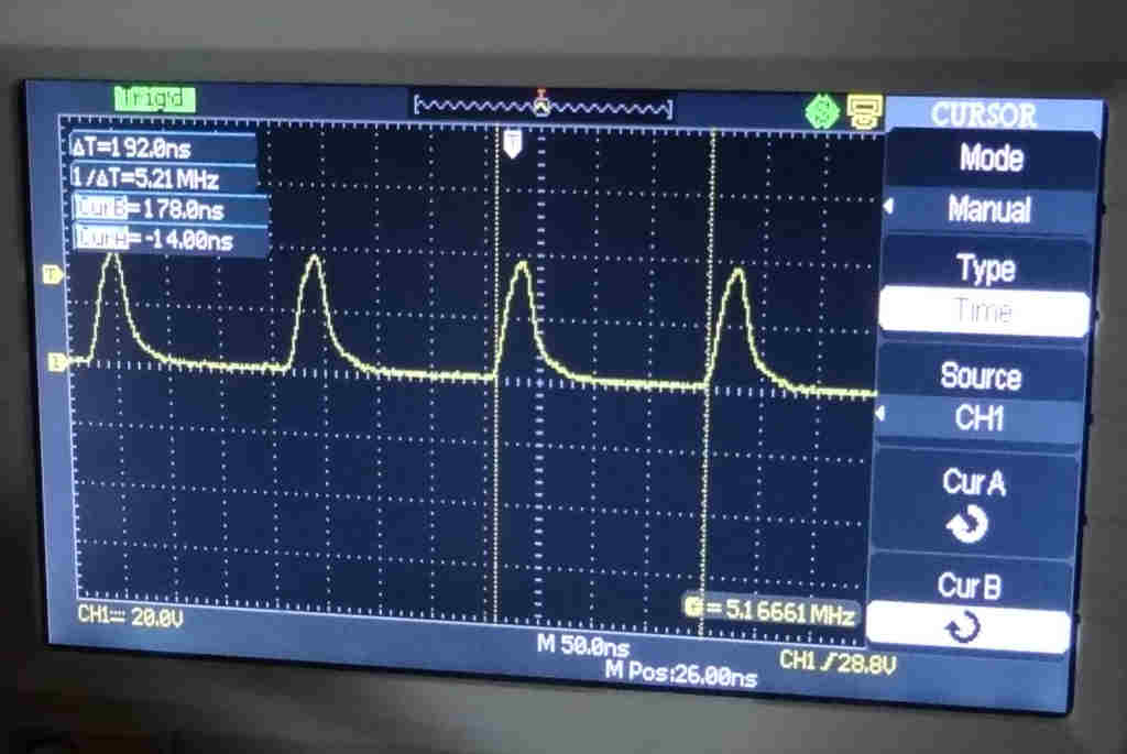

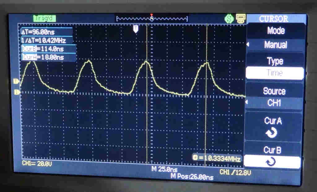

Now it does a complete cycle in 192 nanoseconds (0.192 microseconds), that's over fourteen times faster, but the waveform is no longer symmetrical, with the 'low' part about five times as long as the high part. That's partly because of the overhead in the Arduino's loop() function - which we can eliminate by using an infinite while() loop inside setup.

Now we're down to 96 nanoseconds, but there's still an asymmetry because the processor is basically doing three things:
set the pin high
set the pin low
jump back to the start of the loop
The jump instruction takes time to execute, and that means the low part of the output waveform is still twice as long as the high.

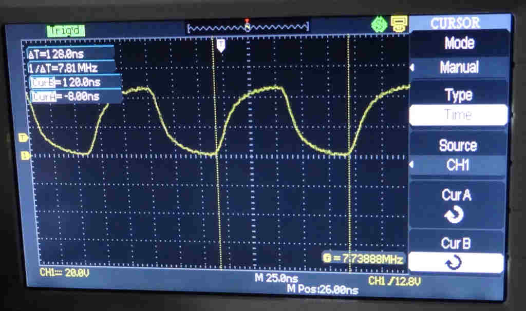

Sure enough it works. The waveform is even, and each complete cycle now takes slightly longer (128 nanoseconds) - which is to be expected because the microcontroller is now doing two pin change operations and two jumps for each complete cycle, rather than two pin change operations and a single jump.
At 32 MHz, each clock cycle of the microcontroller is just 31.25 nanoseconds, so it looks as though the compiler has optimized our code into just 2 cycles per loop - which would be impossible on an Atmel microcontroller (it takes 2 cycles to write to a port register and 2 cycles to jump). This LGT8F controller is not only running at twice the clock speed, it's also doing port writes and jumps in a single clock cycle! So for a simple program like this, it actually runs FOUR times faster than a regular Arduino chip could do! We can use some assembly code to perform the same function. We can use the processor's SBI (set bit in) instruction, and its rjmp (relative jump) instruction. sbi 0x03, 5 sets bit 5 (and only bit 5) of the register at address 3 (which is PINB).

That generates exactly the same output waveform, with a cycle time of 128 nanoseconds.
Conclusion: the chip is definitely running at 32MHz, also executes at least some operations in half as many clock cycles as an Atmel processor, and otherwise shows very good Atmel chip compatibility, so far.

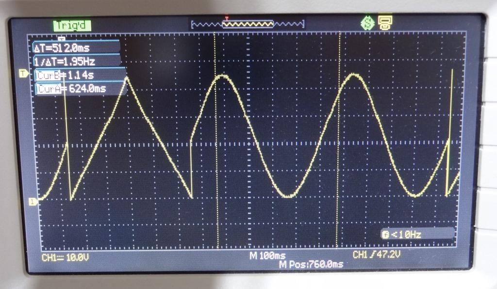

Analog Output: as far as I've found so far, it only works at 8-bit resolution. Still, a cool thing to have!

  // now we can stick to values below 250, and carefully set the scope trigger to only work on the highest point!
  // ramp up
  for (uint8_t i = 0; i < 250; i++) {
    DAL0 = i;
    delay(1);
  // ramp down
  for (uint8_t i = 249; i; i--) {
    DAL0 = i;
    delay(1);
  // sine
  for (double a = 0.0; a < PI * 4.0; a += TWO_PI / 500.0) {
    DAL0 = 125.0 + sin(a) * 125.0;
    delay(1);

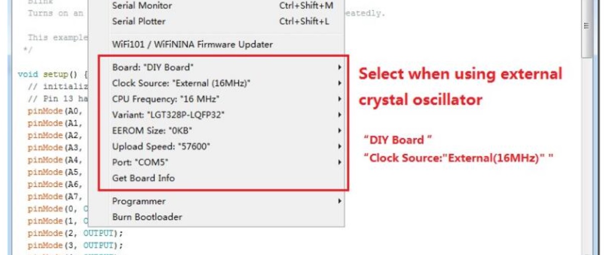

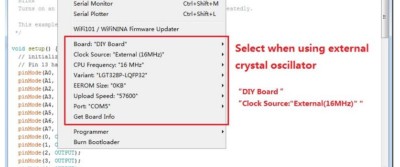

The RF-NANO board has a crystal (16 MHz) which my sketch doesn't seem to be using. In the Arduino IDE Tools->Board->Nulllab AVR compatible boards section, you can choose different boards, but the only standard one that seems to work is the Nulllab Nano/Maker-Nano. If you choose DIY board, then it opens up other selections for Variant: (the RF-NANO has an LGT328P-LQFP32 package), CPU Frequency, and Clock Source: there are a multitude of options for the clock source. But if you set the clock source to anything other than Internal (32 MHz) or External (32 MHz) the code won't compile (you get the error "Clock Source Must 32MHz" [sic] If you set it to use External (32 MHz) then the code compiles and uploads, but doesn't run.
Excellent stuff Martin.... You are right... As far as selecting the external oscillator is concerned it seems that if you select 'Nulllab Nano/Maker' then it will employ the internal oscillator, however if you use these settings with 'DIY board' it is supposed to use the external osc...
There is also this little snippet..
Why is the HT42B534-1 USB to TTL module recommended for downloading the LGT8F328P module?
The built-in RC of the main HT has higher accuracy, and the 12M oscillator reaches 0.25%, so the download success rate is higher and the download is more stable under the same conditions!
If you use other built-in RC USB to TTL, please pay attention to it, if you frequently download unsuccessful, you can use this section to solve the problem!
Note: this model uses CH9340C serial chip,LGT8F328P external 16M crystal oscillator
Which seems to me to indicate 'they' recommend a separate USB-Serial adapter because 'the LGT8F328 internal USB-Serial is not reliable at 16MHz'!.. perhaps that was the reason you had problems with non-running code? Don't you just love Chinglish!

I'd not tried the combination of Clock Source: "External (16MHz)" and CPU Frequency: "16 MHz" (not sure why, as it makes sense). But I just tried it now.
With the (recommended) Upload Speed: "57600" it wouldn't upload - I get the error message:
avrdude: stk500_recv(): programmer is not responding
avrdude: stk500_getsync() attempt 1 of 10: not in sync: resp=0x5d
(all ten attempts fail)
I also tried the same Clock Source and CPU Frequency settings with Upload Speed: "115200" Then it compiles and uploads without error, but the program doesn't run (I tried a simple 'blink' program for that test, so as not to involve sketch baud rates and similar).
Tried the same combinations on two different RF-NANO boards. Same (failed) results on both. :(
So, at least until I can get a hardware programmer working (instead of the serial bootloader) I shall stick to these options:
Like that, the boards always run at 32MHz (albeit about 2.4% slow) without any need for the clock_prescale_set(clock_div_1);
millis() and the Serial baud rate then work correctly.

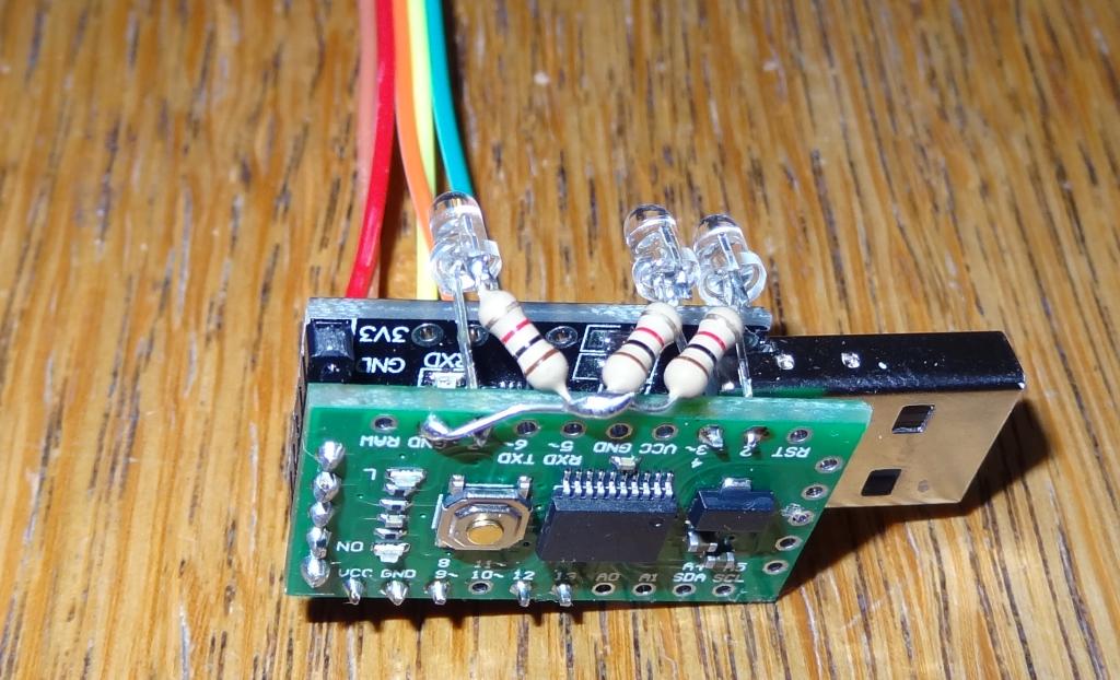

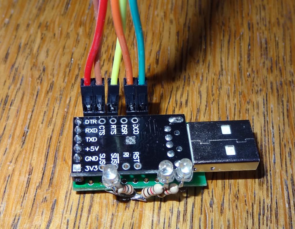

Edit: I decided to try to get a hardware programmer working next, and to that end I've swapped over to using this LGT8F328P Nano clone, which I've had for ages.
It's a non-RF model, but with the same chip and no crystal. Interestingly, I had to change the Upload Speed to 57600 to get this one to work. Otherwise, the same settings of Internal 32 MHz, 32 MHz clock. This one has no crystal, but my speed test showed that this one runs 0.37% fast rather than 2.4% slow, like my RF-NANOs.
The reason I swapped is that this one has the programming pins SWD and SWC on the header at the end of the board. On the RF-NANO those pins aren't present. There are some non-through-hole pads on the bottom of the board, which I guess include the programming pins - I've not investigated those yet, but I will if and when I get the programmer working.
Posts: 787
Re: LGT8F328P Arduino 'clones'
That was somewhat of a struggle, mainly because the documentation is scattered all over the place and somewhat out of date. I think I'll document just what I did to get it working on my website, and then I'll post the details here too. I want to check the method I used works under Windows as well as Linux before I post it.
Here's a link to the blurb I posted about building an ISP programmer on my website. I won't reproduce all that stuff here: https://ceptimus.co.uk/index.php/2022/0 ... ogramming/

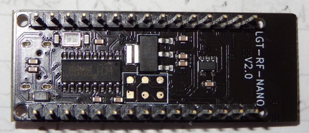

RF-Nano board has programming pads on the bottom, laid out in the form of a two-row, three pin header with 0.1-inch spacing, but they're not through-hole pads, so will be difficult to solder to. Also, my RF-NANO boards came with the two main rows of outside pins already soldered in place. This would normally be a good thing for plugging them into breadboards, but for converting them into RC receivers could be a nuisance - and it makes getting at the programming pins even harder.
I've belled them out and as far as I can see, they're in no industry-standard order. They're laid out like this
Code: Select all
GND  VCC  N/C
SWC  RST  SWD
The SWC pin is the square one, and SWD is at the other 'bottom' corner the way I've oriented the board in the photo. The other pins are also available on the board's regular pins, so the programmer only needs to make a temporary connection to those two. I think I can rig something up with some spring-loaded plungers to connect those two pads, and locate on some of the regular legs to get the other necessary connections and keep the spring-loaded ones located correctly.
I'm off out flying tomorrow, weather permitting, so probably won't make much more progress before the weekend. I intend to build a dedicated SWD programmer, and a rig for connecting and programming the RF-NANOs using that. Then I should be able to get the RF-NANO crystal working, so that the timing will be accurate when frequency hopping.

I built this handy-dandy compact ISP SWD programmer using one of the 'micro' LGT8F328-SSOP20-package boards mated to a CP2102 USB-to-serial adapter that happens to have the perfect pin arrangement to match the serial input side of the micro board. I had to swap the I/O allocation around a little, because the SSOP package chip doesn't have all the pins that the original sketch used. I'll post the modified sketch if anyone wants to build one. It works great for uploading sketches and burning bootloaders. I'll probably 3D-print a case for it, eventually.
Now I realize that the crystal on the LGT8F-RF-NANO belongs to the nRF24L01+ :lol: :roll: so there's no pressing need to use the ISP programmer on the LGT8F-RF-NANO anyway! I'll go back to serial-uploads for now, and investigate the nRF24L01+ part...
