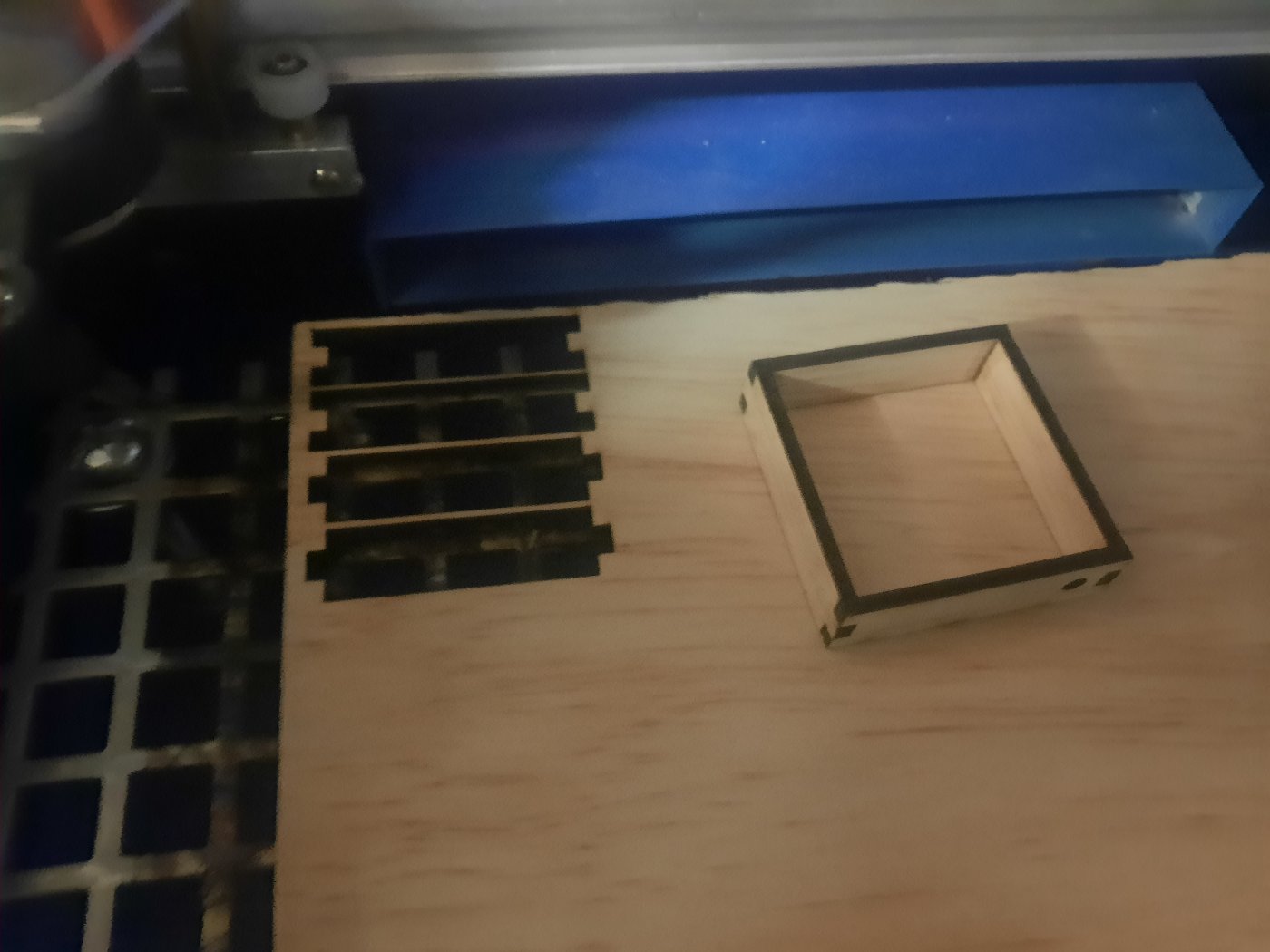

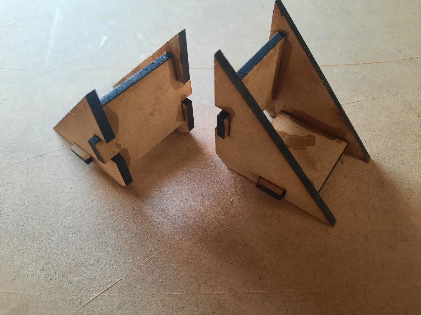

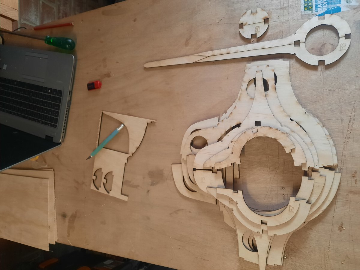

- _AL_
- Posts: 171
- Joined: 17 Feb 2018, 01:09
- Location: Sydney Australia
Re: Advice On Laser Cutters Please.

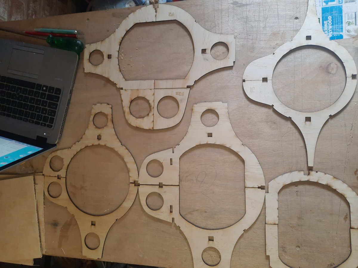

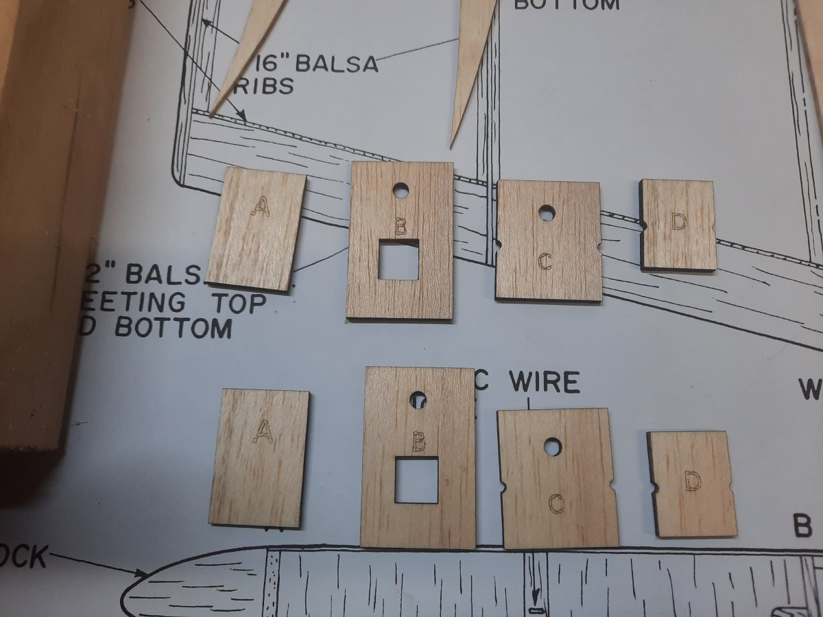

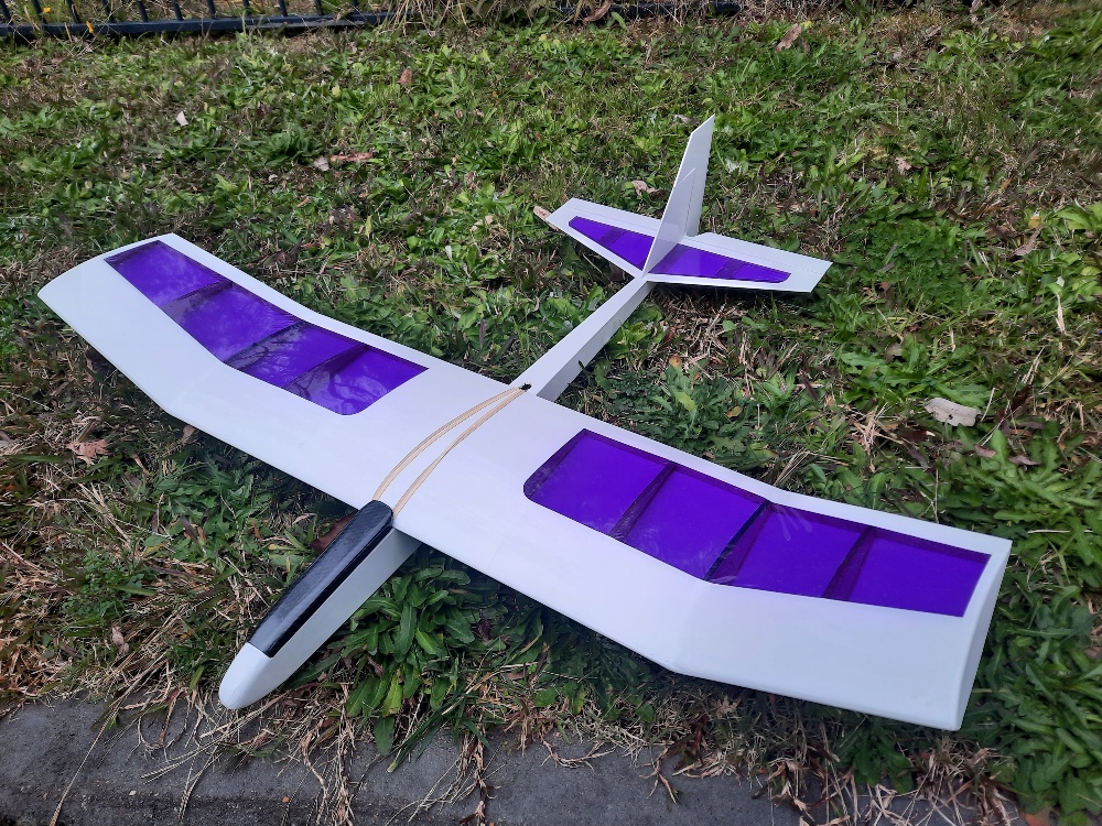

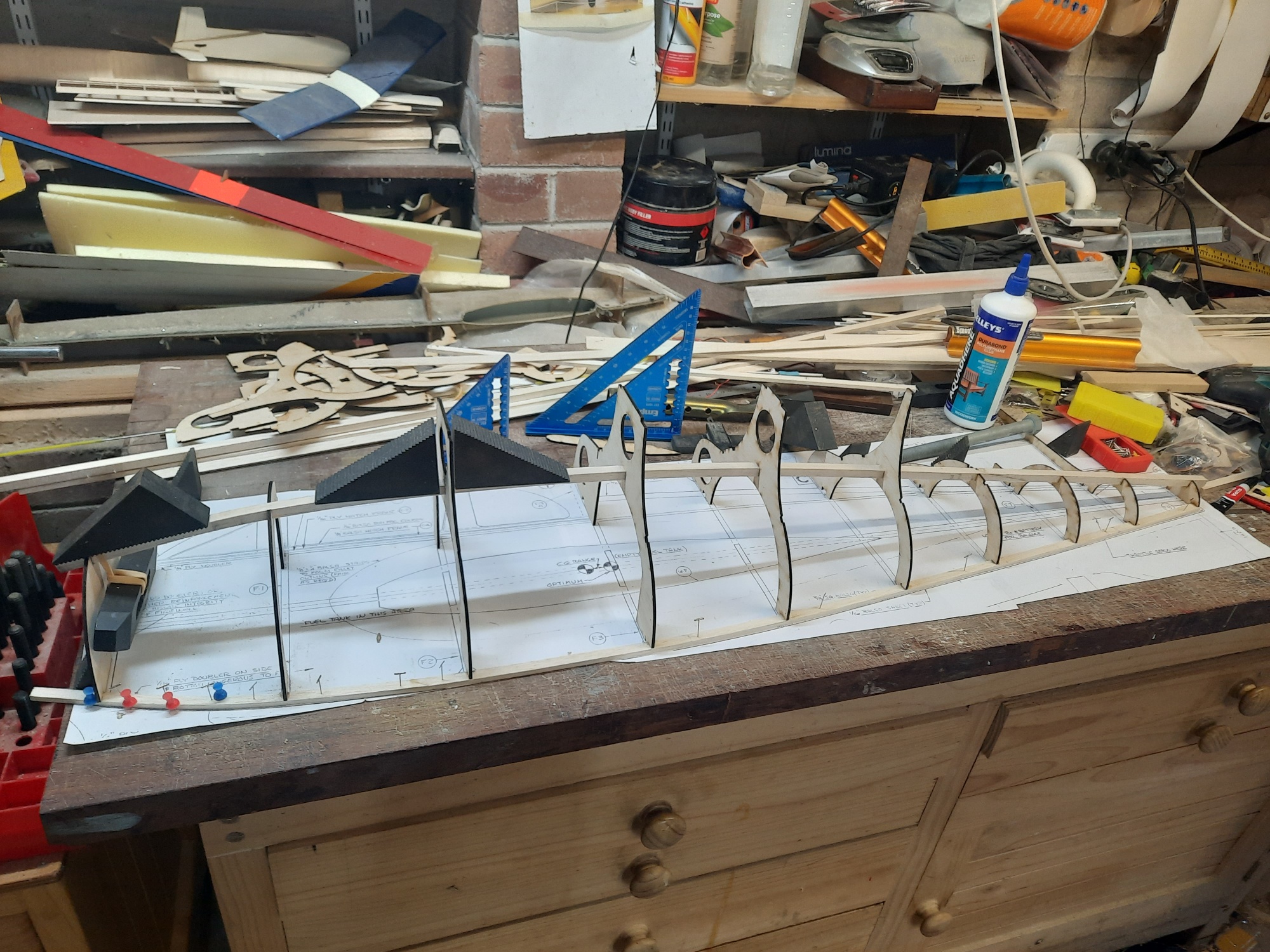

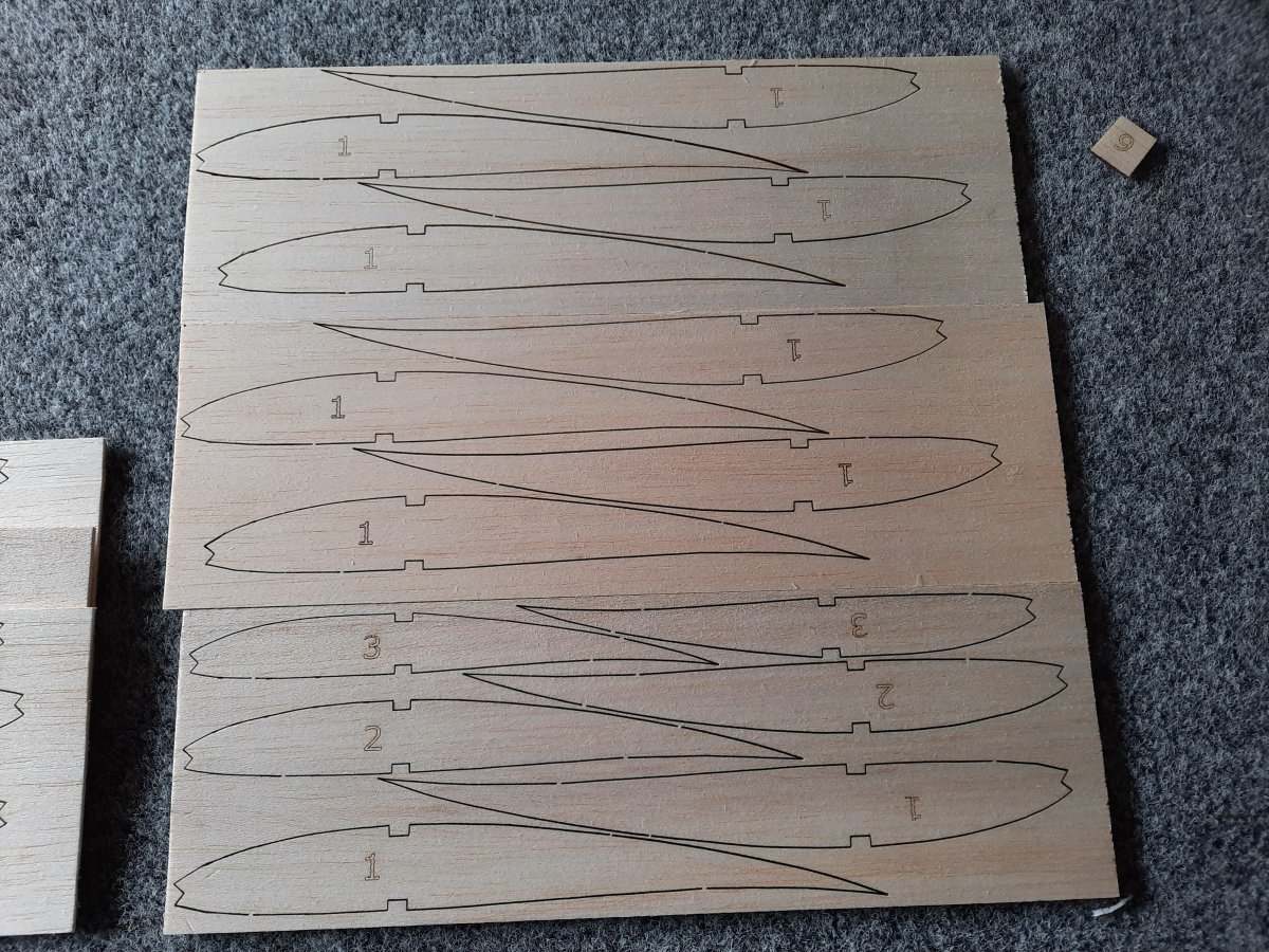

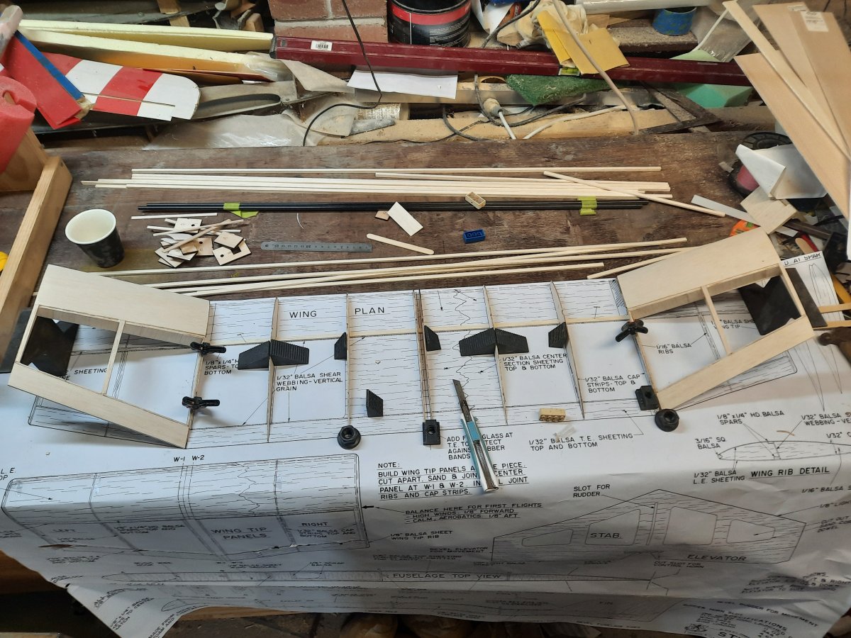

Some projects on the laser.
