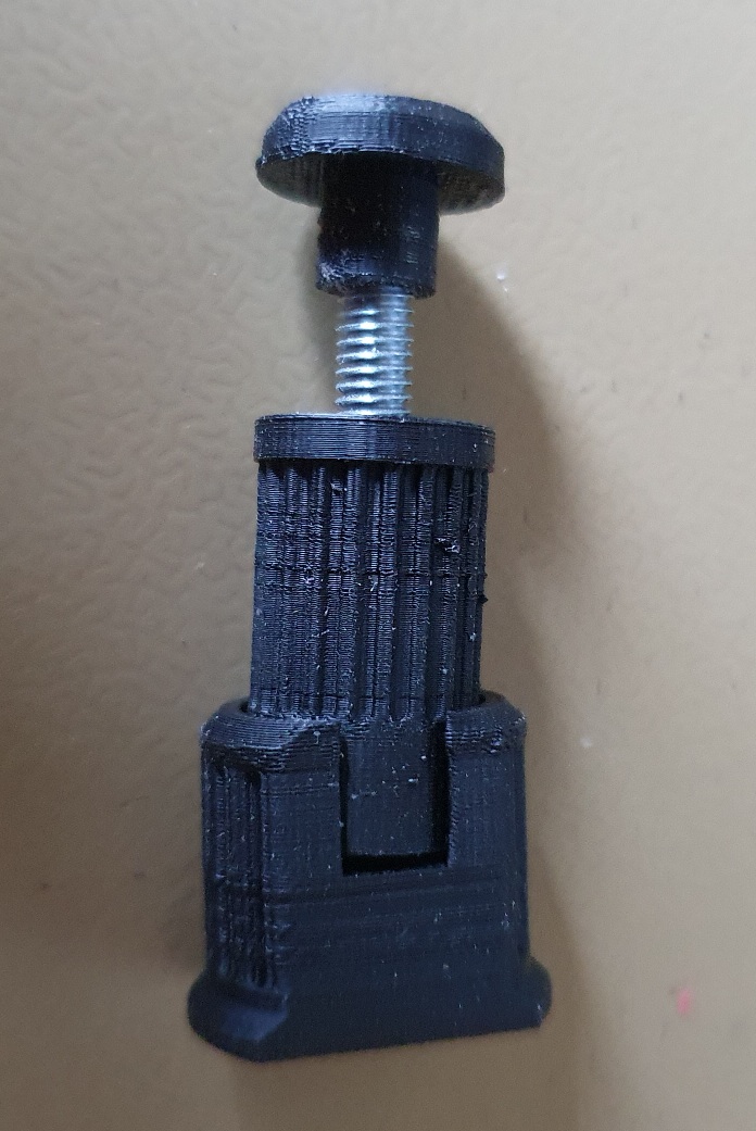

This is a side project to compensate that my hands are not as flexible anymore...a third hand!?!?!
There are several variants out there of PCB holder but most are quite bulky and/or quite expensive so I put the little grey cells to work and came up with this:

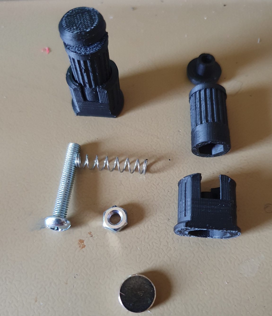

All parts are slided together, notice the side where the nut goes and the top is screwed in place
Should give an idea of the required sixe of the spring, the screw is a M4x25
You will find most information in the included .zip file and as hardware you would need a M4 x 25 screw with nut and a spring that fit the screw and almost as long.

The nut slides into to the middle piece that when rotated will first regulat the spring tension but eventually lock the PCB if needed.
Each vise has a magnet of 10x4 inserted so it will "stick" to a piece of thin sheet metal i.e. scrap piece from a roofing company or similar that has a bend along one side.
