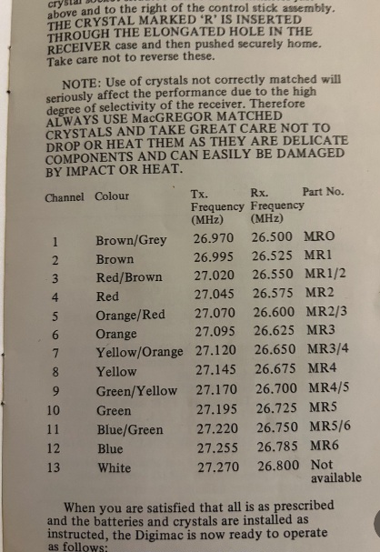

I think the old blue brushed aluminium Macgregor receivers with the black end cheeks with white rubber grommets like MR23 were 470khz i.f. but when the “A” series ones came out (blue plastic) they moved over to 455khz. I can clearly remember a 470khz sticker on the boxes.
Re: Recreating a Remcon Versatile receiver
Hi Phil
No, the sticker definitely said 470khz If.
Here’s the manual for the digimac 1plus 1 on crystals.
