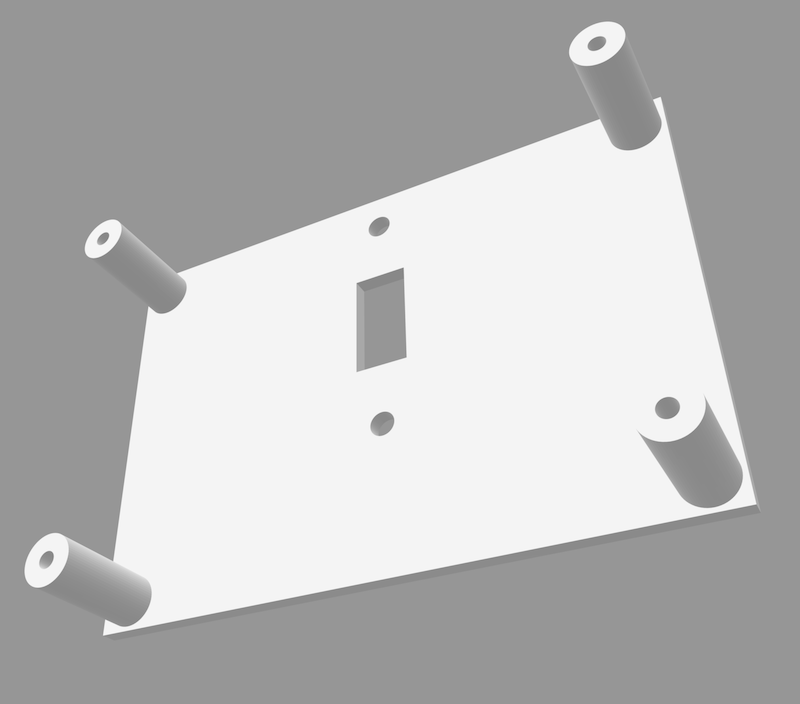

It's a fairly straight forward conversion apart from thinking how to mount the strip board PCB.
What I came up with was a 3d printed plate that is mounted through the on/off power switch bolts. Then plate has printed stand offs which raise the pcb just above the switch. See picture 1. The NRF module is mounted on the pcb and uses a pig tail to connect it to the antenna, I wasn't sure if this would affect the range but after a thorough range check I can confirm it has no effect. Range is at least half a mile, I got sick of walking

Here is the STL file for the mounting plate
