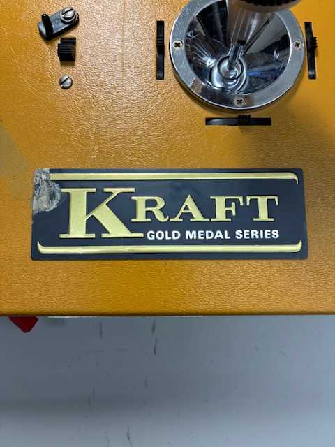

I'm looking for a Kraft "Gold Medal Series" foil label to replace the original damaged label. The original is 100mmx34mm. Any help would be appreciated. Thanks.

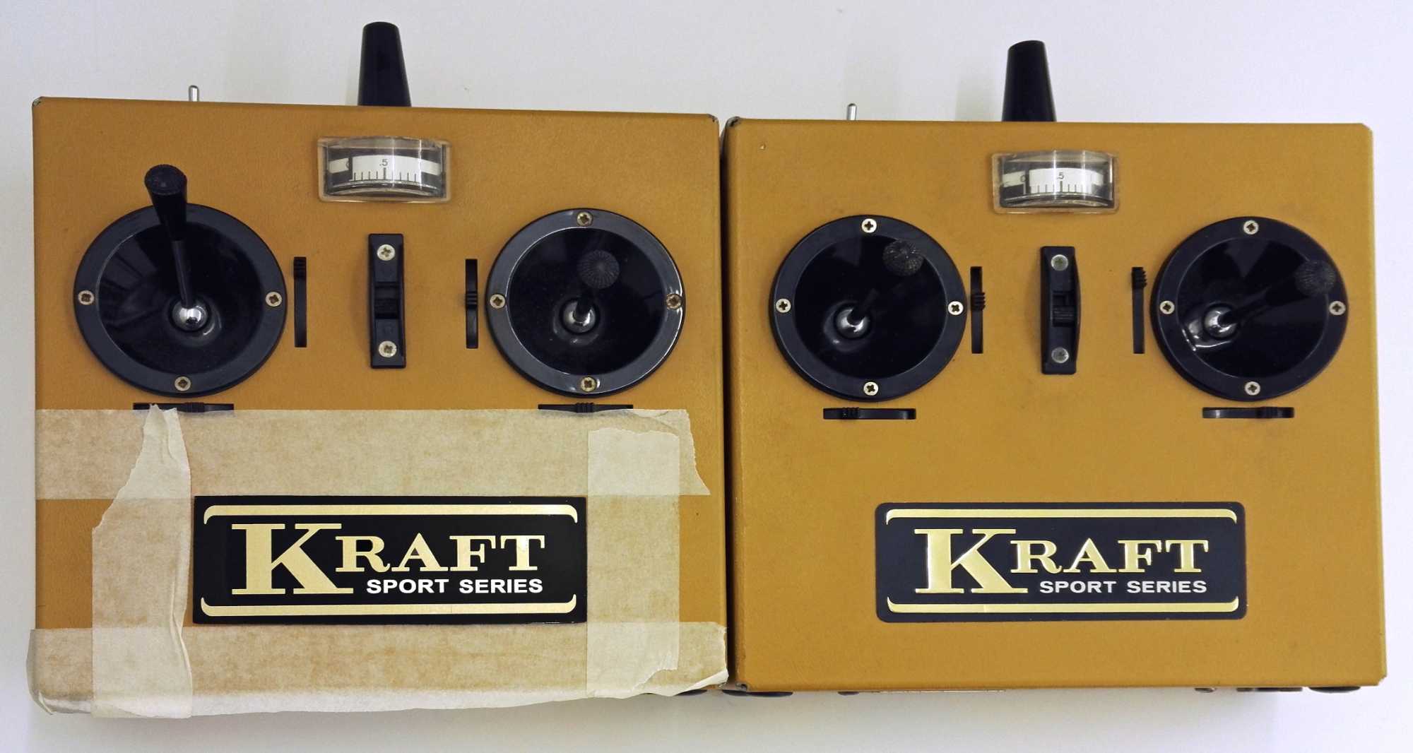

An alternative is to make your own. I have done the art work for most of the Kraft sets.
viewtopic.php?f=64&t=617
If you follow Ron's labelling method and use silver/alloy labelling material you can get a result equal to Cal Orr's commercial ones (yellow printed on silver material finishes looking gold). I've had better results with a laser printer than an inkjet, but others have used inkjets to good effect, so it's possible to use either.
viewtopic.php?f=74&t=321
And the results (the printed label is on the left, on the right is an original).
