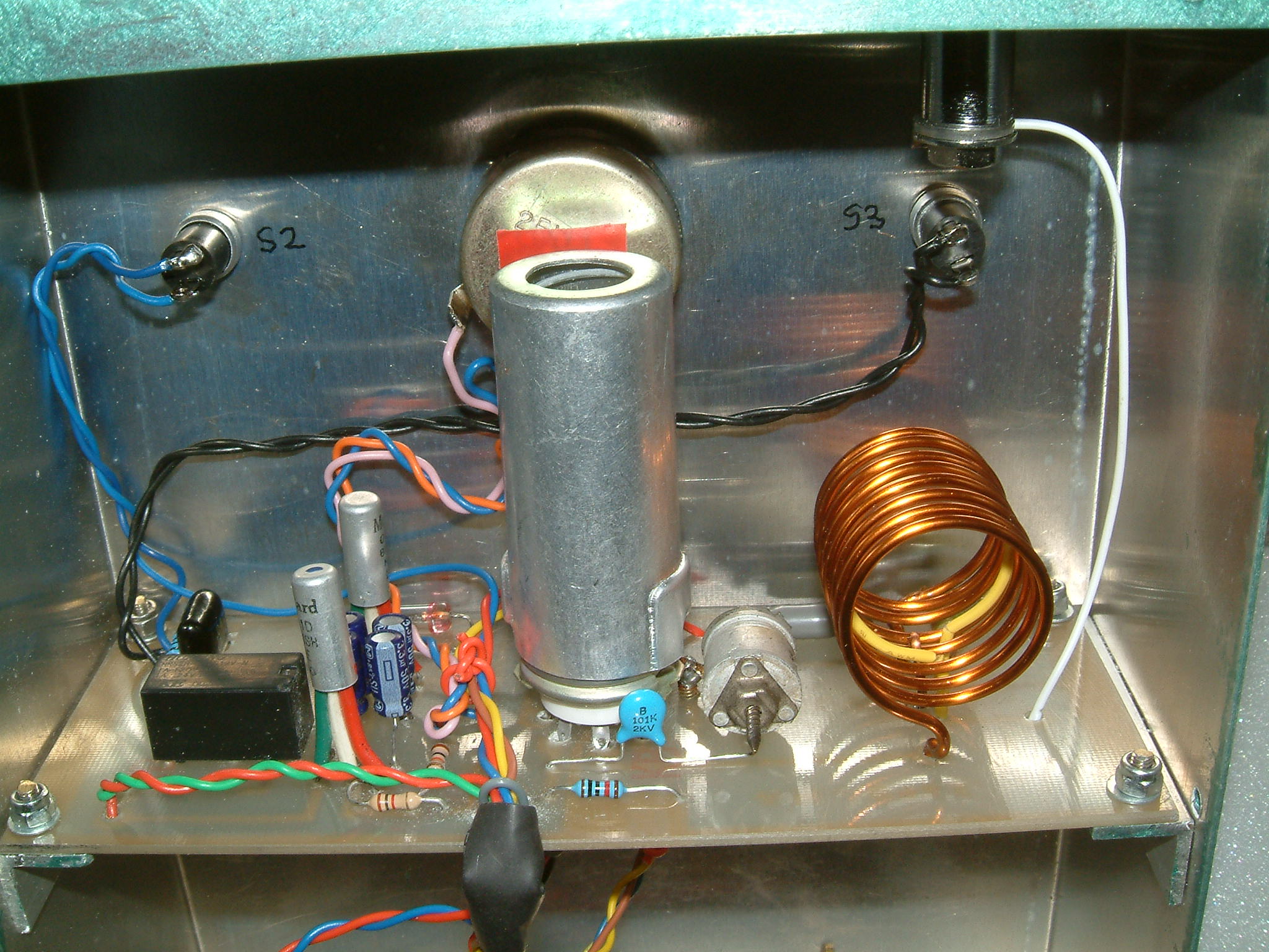

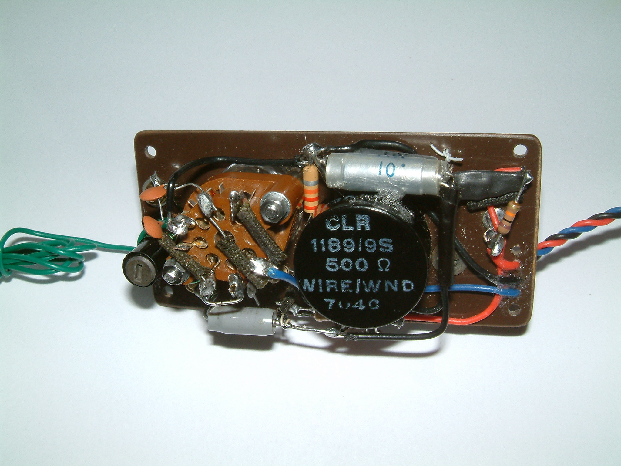

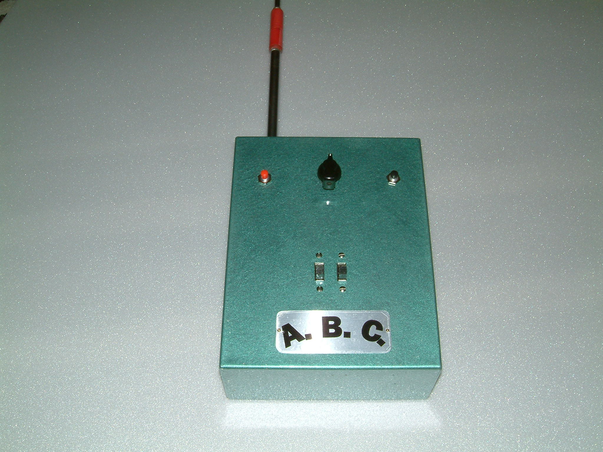

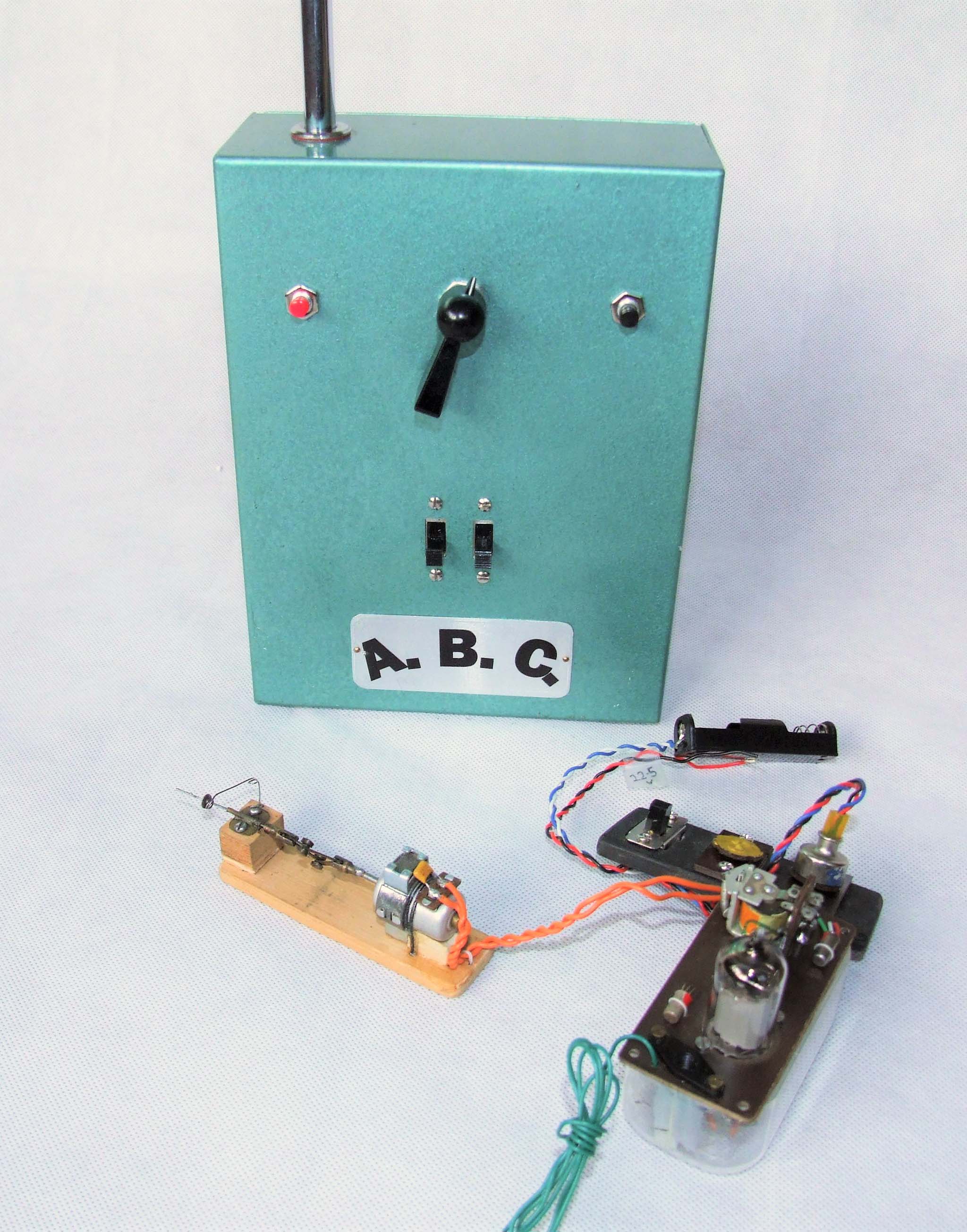

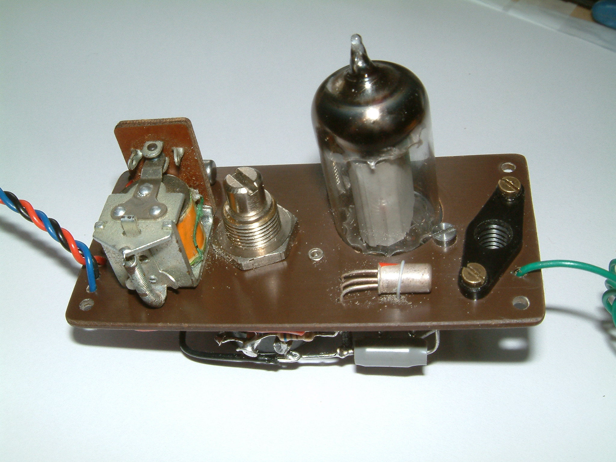

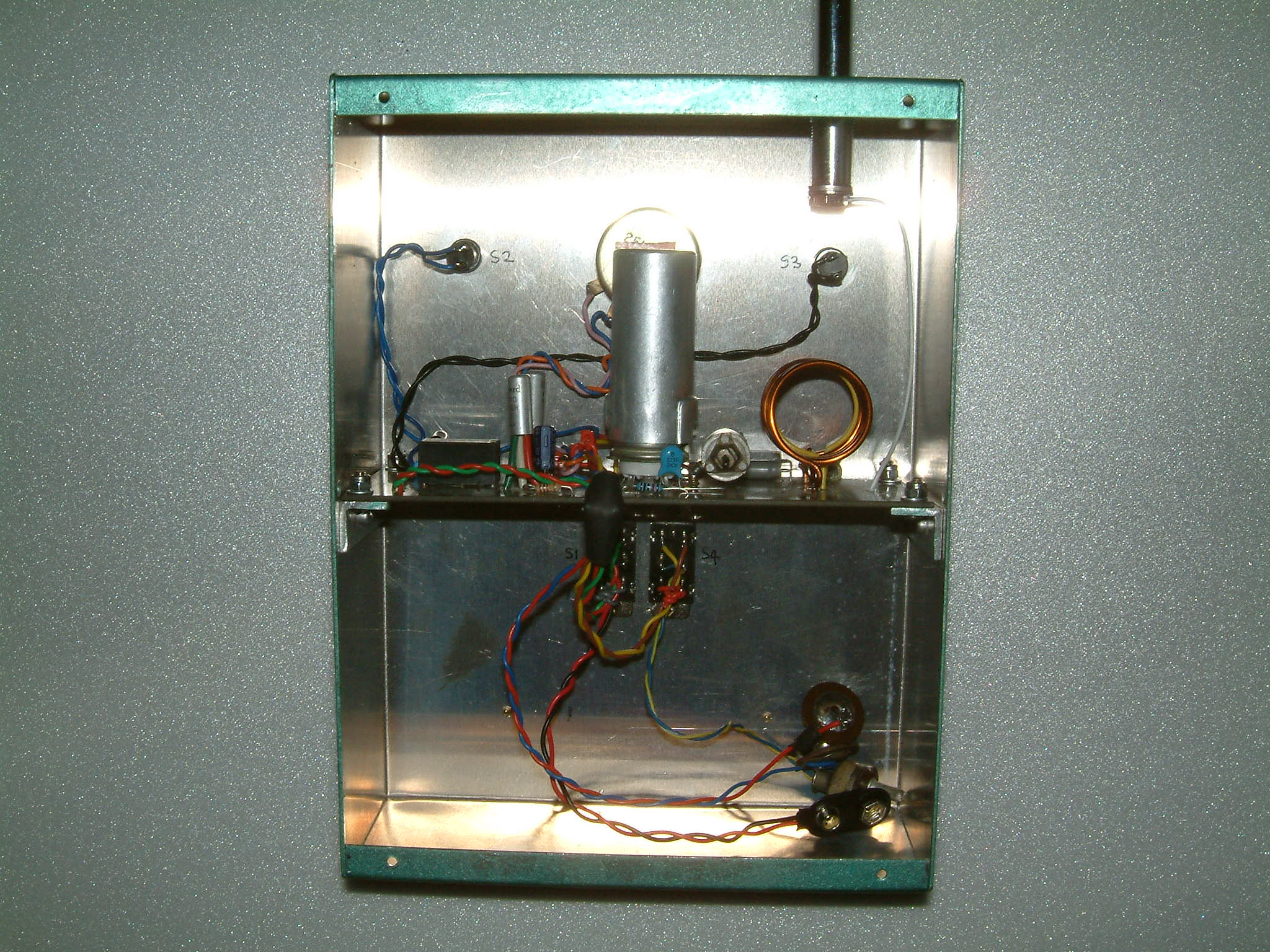

For a bit of fun you could make the ABC Valve / Transistor hybrid carrier wave pulse Tx and Aeromodeller Valve / transistor Rx; works a treat,pretty simple to build. Only issue is finding a 5K relay for it. There are designs for other all transistor carrier wave ones around though. Then make a simple fly-ball actuator. They were surprisingly powerful

The ABC set up is my favourite build over the last few years. Great fun, different and rewarding when it fired up.
Shaun..
