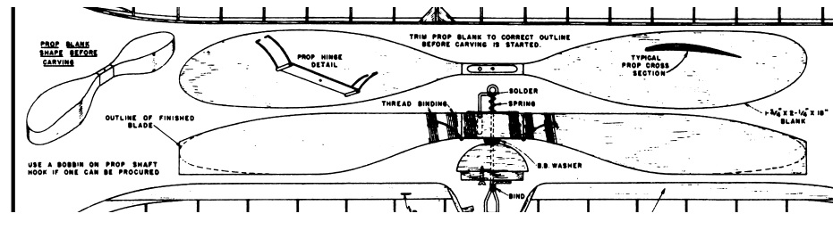

You need to look through some of the vintage rubber plans for folding props, just found this in the Korda Dethermaliser plan.
