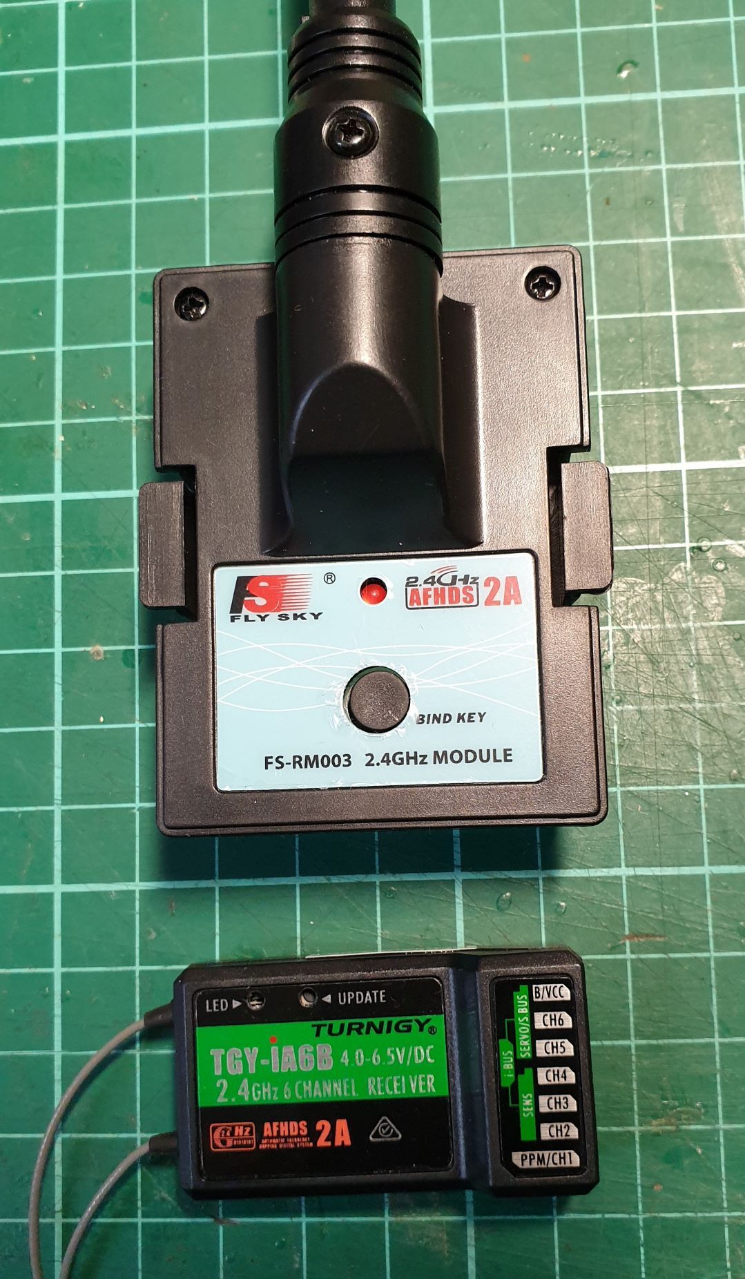

My Flysky RM003 RF module will not bind to my iA6B receivers. They are the Turnigy brand, but I have tested compatibility before with a Flysky Tx and they should bind. I have tried 2 Rx using the standard procedure, and variations. The module and the receivers both use the AFHDS2A protocol as clearly stated on the respective housings. I have also tried to run the module without ppm connection, but then it will not even enter bind mode.
Any ideas?

I am giving up on the Flysky RM003 module.
I have tried everything I could think of, different procedures for binding, delaying power up until the ppm stream is established and a completely different receiver, a small Banggood Rx with a proper bind button i.s.o. a bind plug, but it showed no sign of binding at all. Binding it to my Turnigy TGY i6 was not a problem.
I hooked up the ppm stream to my analyser and to the module at the same time to see if the signal was still there, all seemed well. Could it be signal level perhaps?
Incidentally, memory recognition is not as I remembered it. Changing the memory on the i6 did nothing to prevent the Rx functioning (both the iA6A and the Banggood).
Just to be sure I opened up the module, nothing suspicious there, the connecting socket is wired up exactly as in Phil's RM002, albeit with a different PCB layout. Most connections are GND, exceptions for Vcc and ppm.
Max.

Re: FlySky RM003 RF Module & iA6/iA6B receivers
Max, I just used my RM003 module mounted in an old JR Tx, to bind to 3 different Turnigy IA6B Rxs - all bound first time
This is what I used: I can do a short video if that is of any use?
