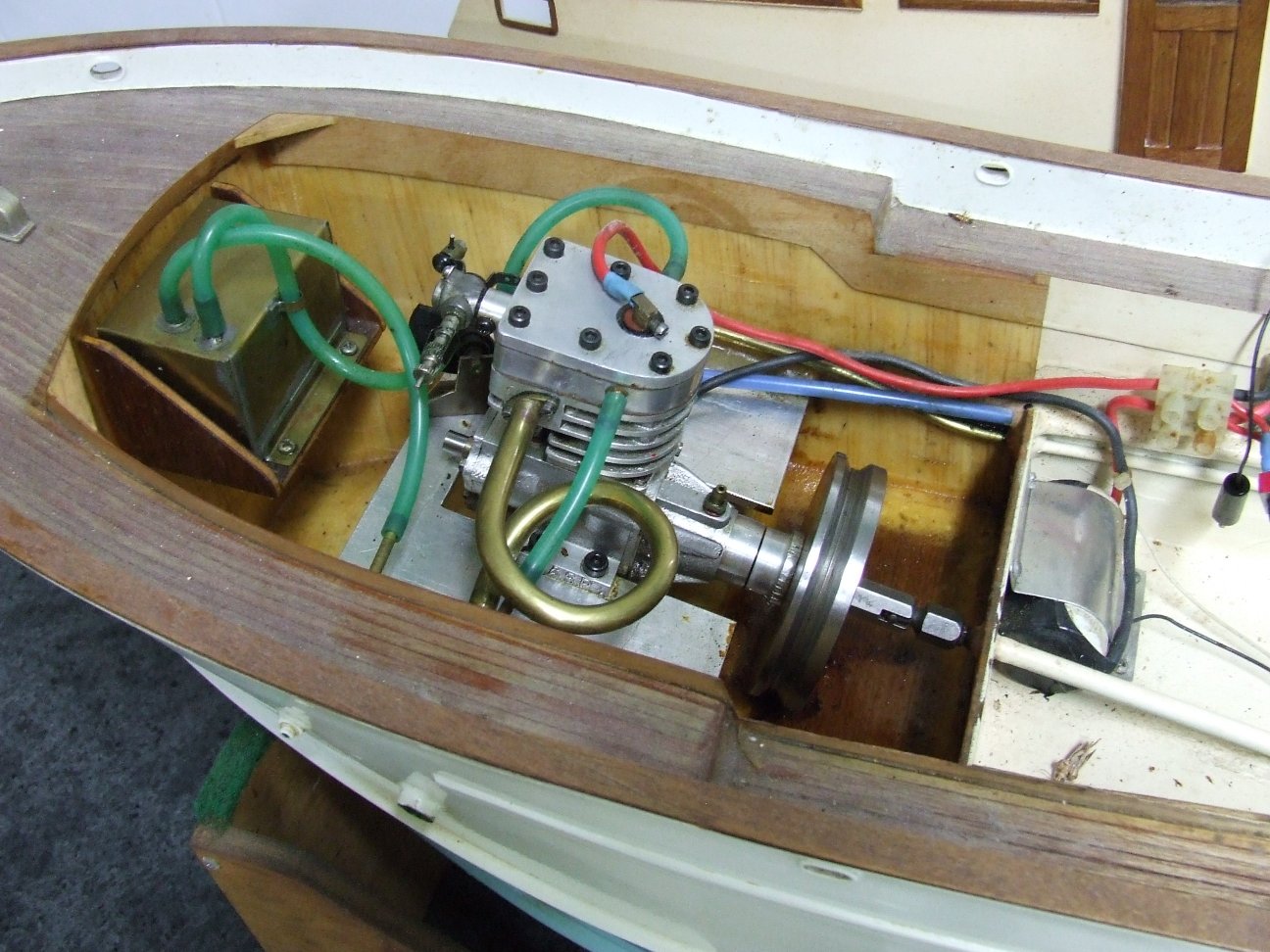

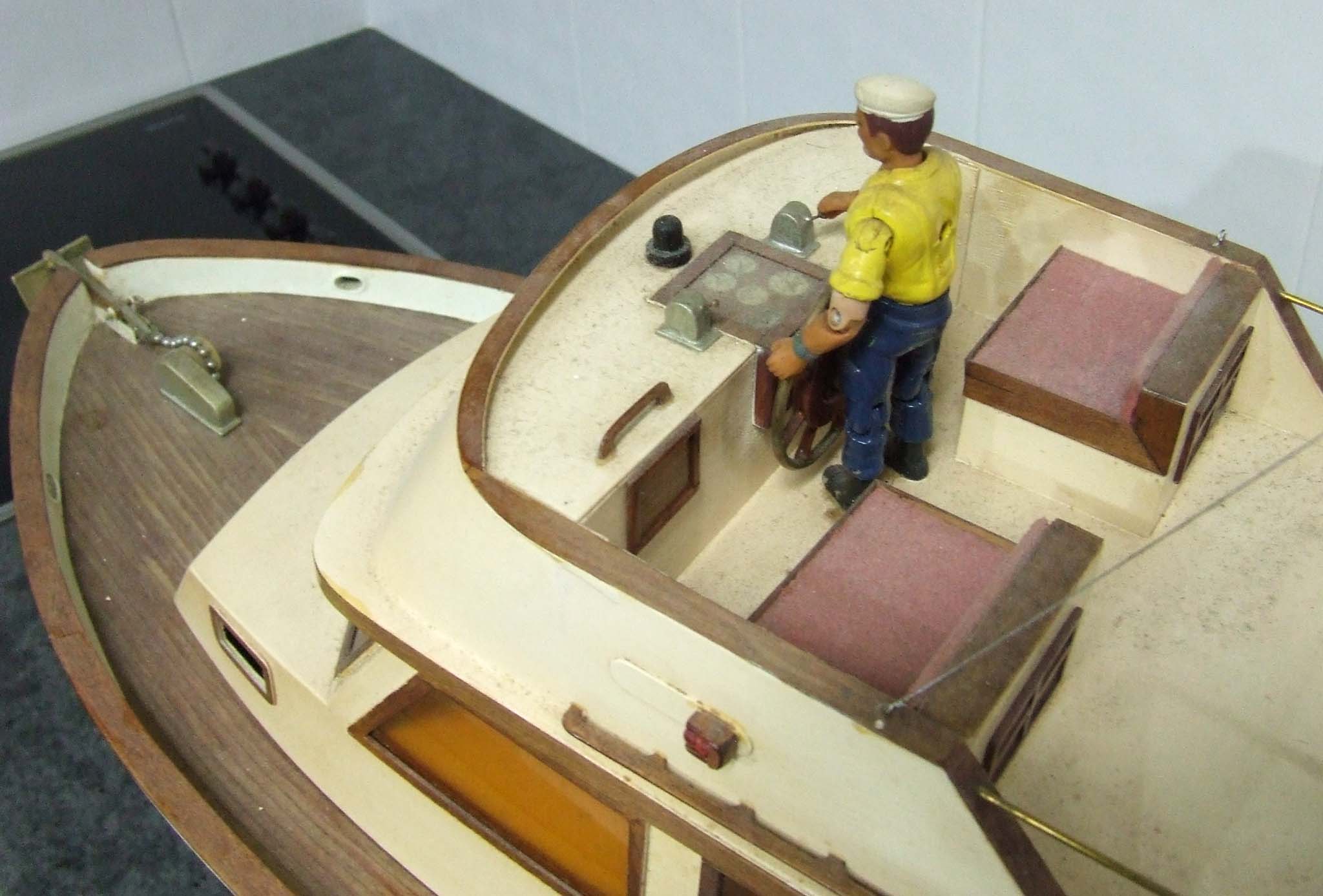

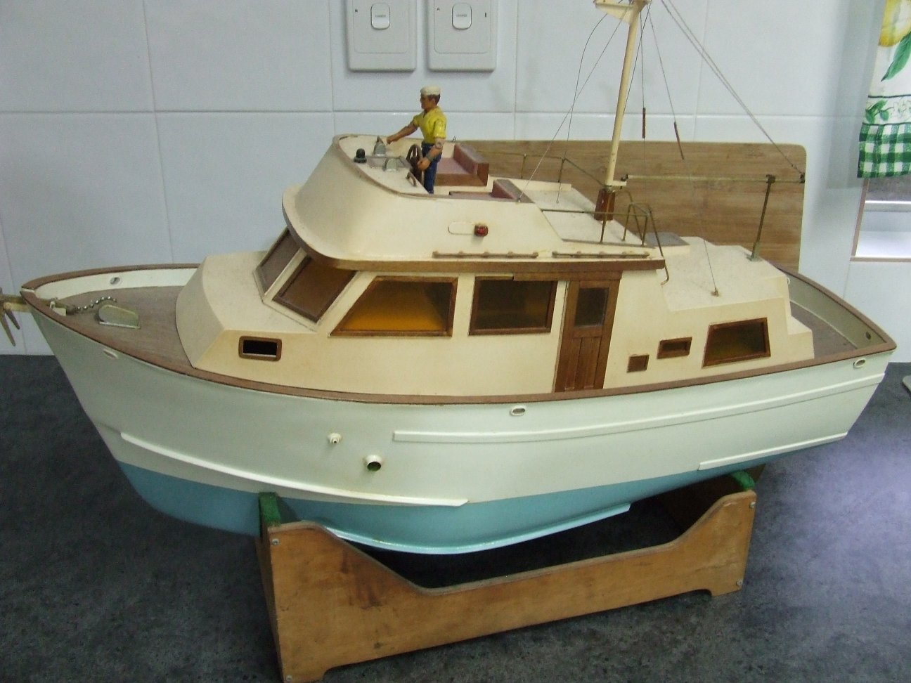

Few photos of the little scale Neptune I built ages ago.
Engine is one of George Punters castings (block and rear cam casing) all else built as my first engine back then.
7.5cc water cooled head four stroke, individual cams at the rear. Carby was from a small old OS engine from the 50's. Idles down great with glow assist and 4:1 methanol/castor. Used to be a line of kids up down at the local pond when my 2 boys and I would go sailing.

Boat started out as a foam plug for a mold but took so much time I decided to sheet the inside and fibreglass the exterior.
One can see the difference between the auto laquer finish and the spray can colours how the latter changes over time.

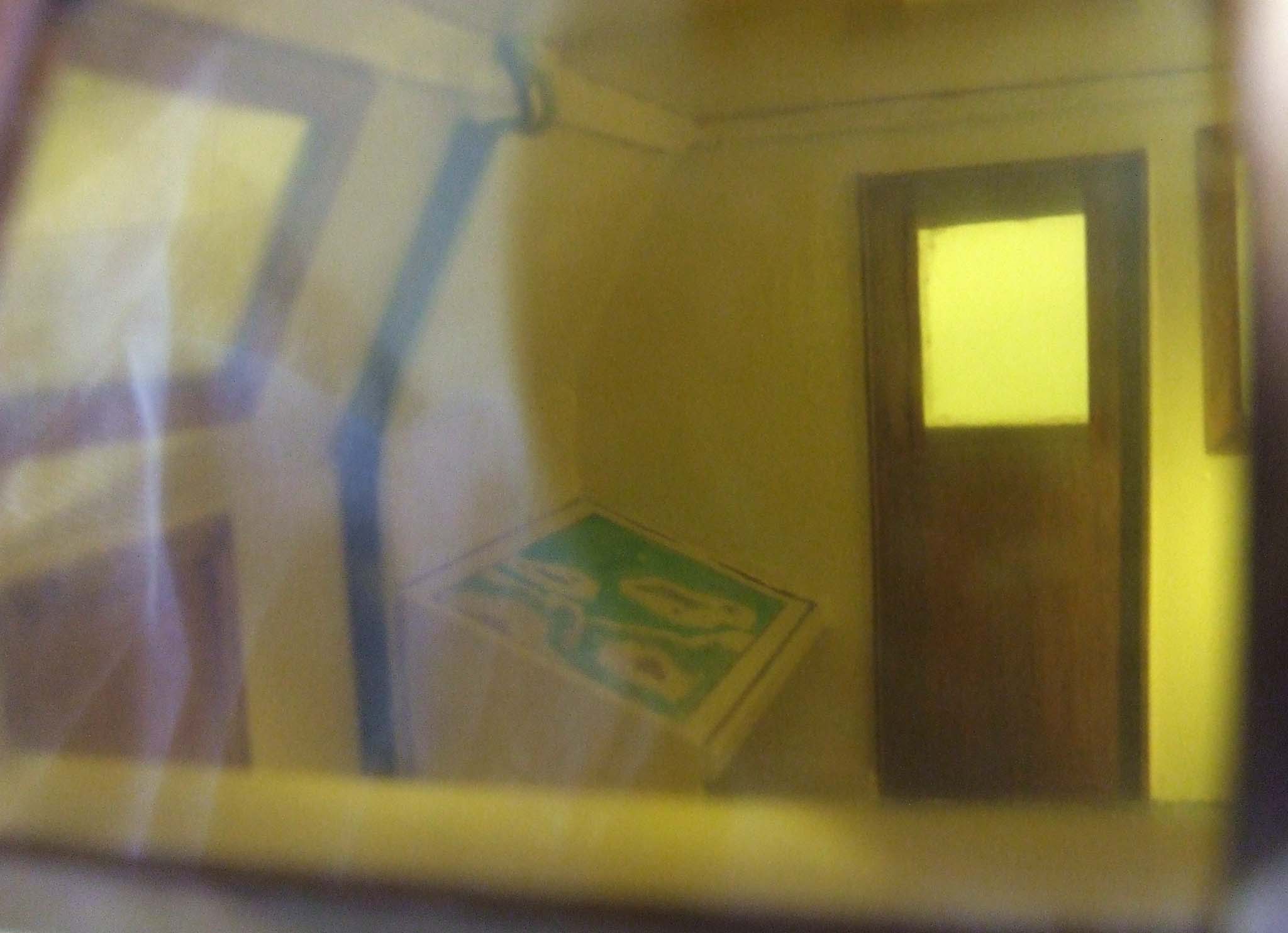

That door in the second picture looks so real, I can just imagine someone walking through it.
Very nice.

Very nice. How does the water cooling work? What causes the water to flow? Is it a closed circuit and the water would eventually boil away?
Posts: 714
Re: 25 year old scale Neptune

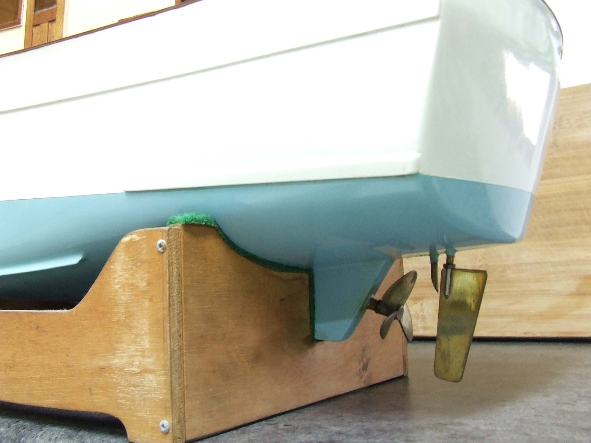

...I'm guessing he has a pick up just behind the propeller and but before the rudder and that is normally more then enough.
But the cooling pipes seem to be connected to that 'tank' in front of the engine. What is that?
bluejets
Posts: 349
Joined: 19 Jun 2019, 04:09
Post by bluejets »
Martin wrote: 25 Jun 2019, 17:22 But the cooling pipes seem to be connected to that 'tank' in front of the engine. What is that?
Water cooling indeed comes from a pickup tube near the prop. It can be seen in the prop photo.
Upsweep of the home built brass prop forces water up the tube.
Brass tube carries water supply up to the engine area and then green tubing into the head.
The brass exhaust tubing is coiled to allow for engine vibration.
From there the water flows out of the head and into the exhaust pipe to make sure it is cool as it passes through the hull.
Latter also serves as the usual "tell-tale" that cooling water is actually flowing.
Brass tank also has green silicon tubing up to the carby with another tube as vent leading to the outside of the hull.
To refuel, line is slipped off the carby and fuel fed in until it squirts out the vent line.
Runs about 20 minutes on each refill.
Maximum speed is a little over walking pace with an idle to kill for.:)
One can actually see the pulses from the prop at idle in the water.
Running lights and interior lights also work well for night time running.
2 channel radio with a glow assist unit I used to make here for aircraft.
