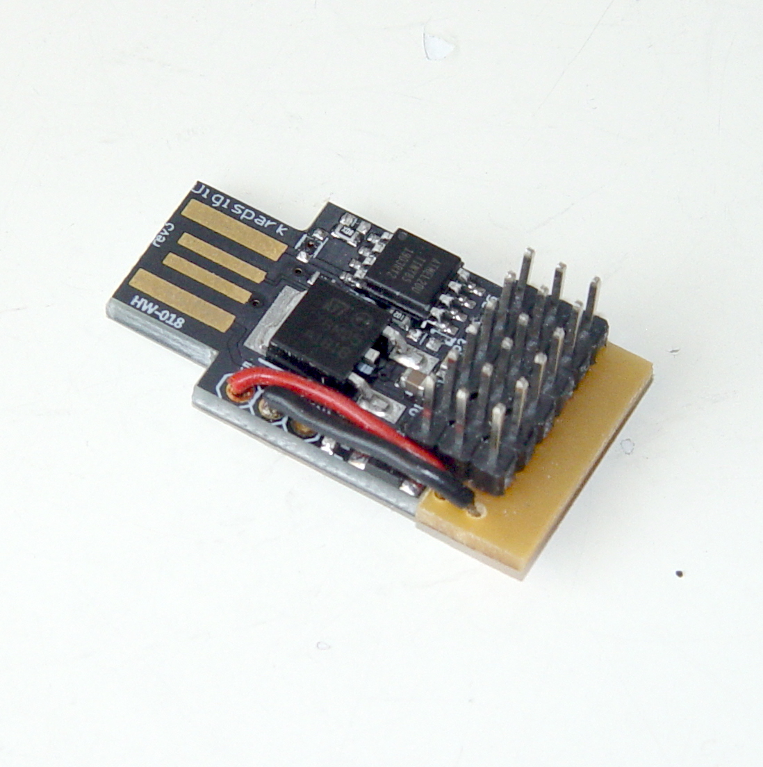

The Digispark, properly "defluffed" as per Phil's instructions, and extended with a strip of veroboard to connect the servo pins. The USB-tab will be hacked off later:

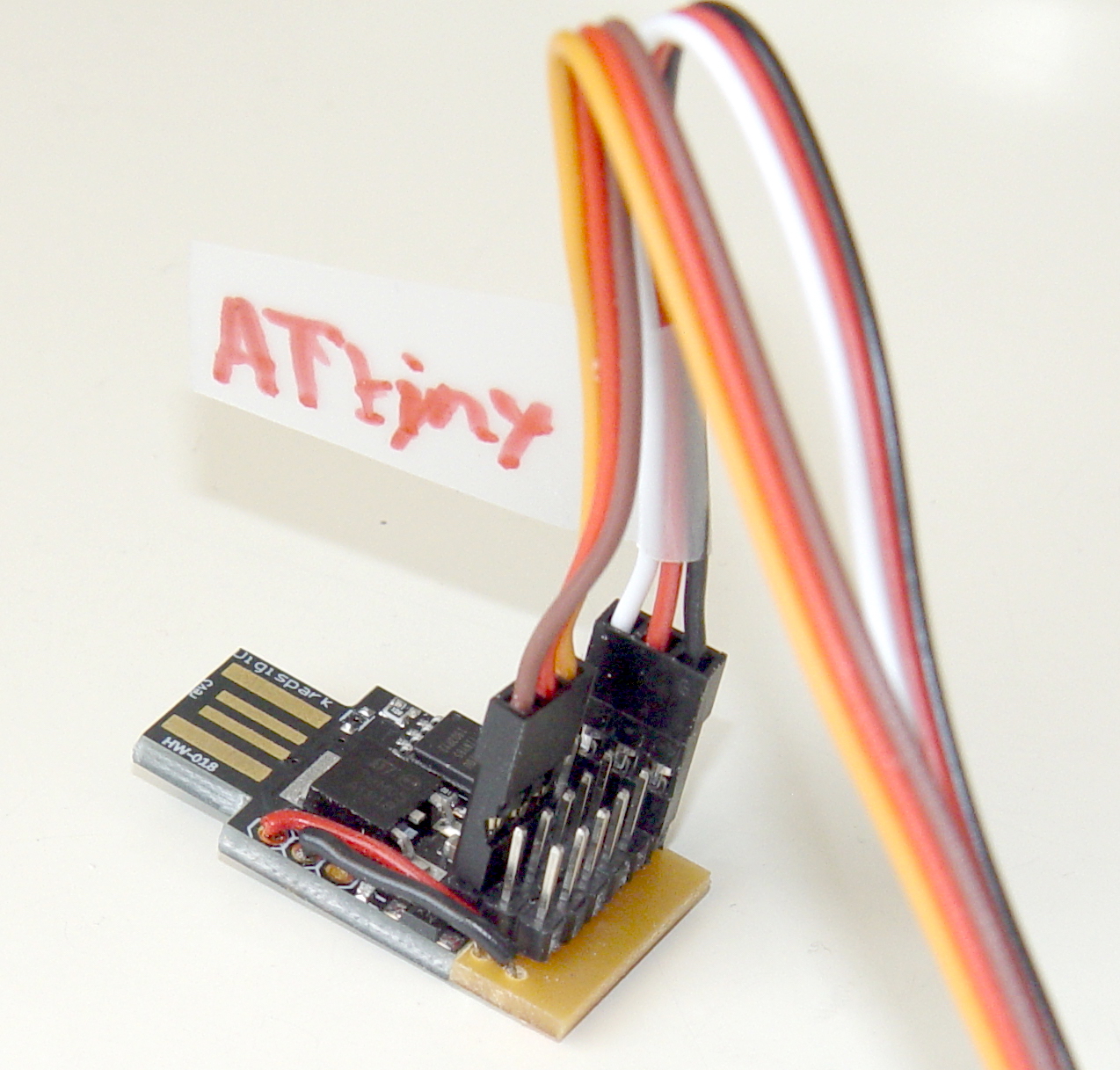

And with the USBasp programming adapter cables connected. The largish flag is to remind me that I should swap the +5V and Reset leads when I use them on the ProMini (for which they were originally intended as per Mike_K's description in his S/C Tx design documentation):

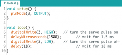

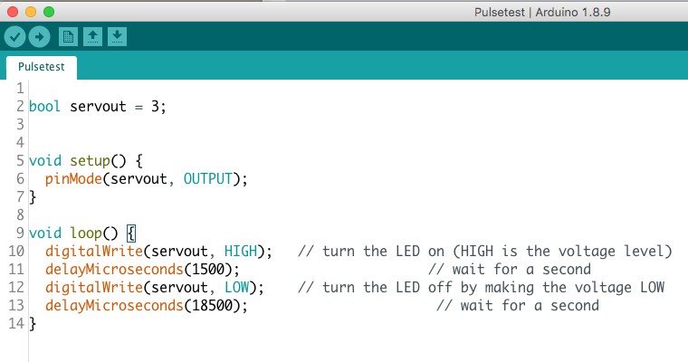

As for the output pin, here is the sketch, but the pulse appears on PB1(pin 6 on the chip)?

Ok Phil, I think I understand now :|
Anyway, I "burned the bootloader" at 8MHz, and the output is now more or less as expected. A bit disappointing is that the programmed 1500 us pulse has a spread from 1493 us to 1505 us, so more than a trim pip of 10 us, which reduces the practical use of this method to generate servo pulses.
Re. pinout: what a silly mistake, bool instead of static int. You are right, I was getting what I asked for... :roll: :D

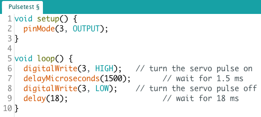

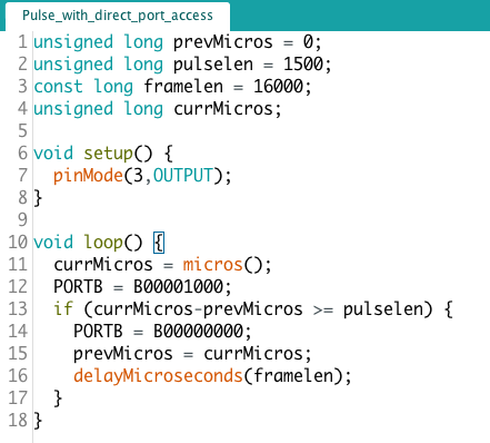

I simplified the code somewhat (wiping out my error :oops: ;) ) and I have clocked the Digispark now at 16MHz. As predicted by Phil, the jitter is reduced:

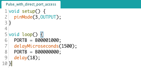

Then I tried the direct port access, which gives about the same amount of jitter, but for some reason is slightly further off the 1.5 ms mark (1487-1495 vs 1491-1497). Nothing to worry about though :
Max.

Phil_G wrote: 10 Jul 2019, 14:55 Just as an experiment, put noInterrupts(); at the start
I think your jitters will disappear ;)
Error at compiling for ATtiny25/45/85
I also experimented with replacing the delays with a counter based on Micros(), but the jittering is still there :(
