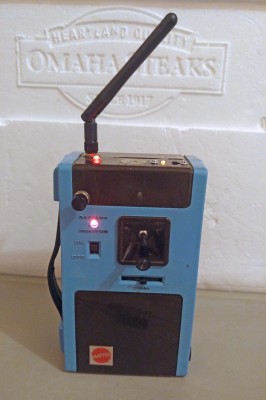

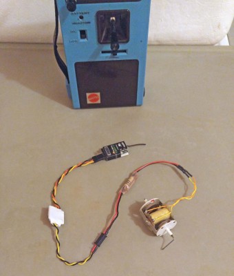

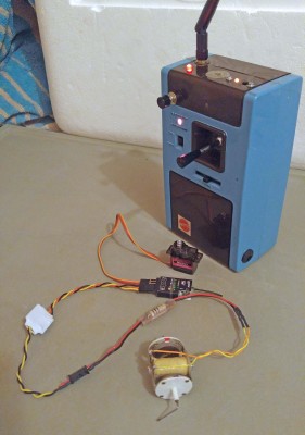

Finally got my Mattel transmitter conversion completed. Used Phil G Digimac 1+1. FYI the Mattel stick pot is 170K ohms! Had to put a 1Meg ohm resistor across the pot, a 100 ohm resistor on the ccw lead and a second 100 ohm resistor on the cw lead of the pot to get the system to work. Very pleased with the results. Nice! Also added one of Phil's pulsers with a 100 ohm resistor inline to an Adams actuator. It all works nicely. Now I've got throttle and a waggly tail! Now do I put in a School Master or a Jr. Falcon? Decisions.....
