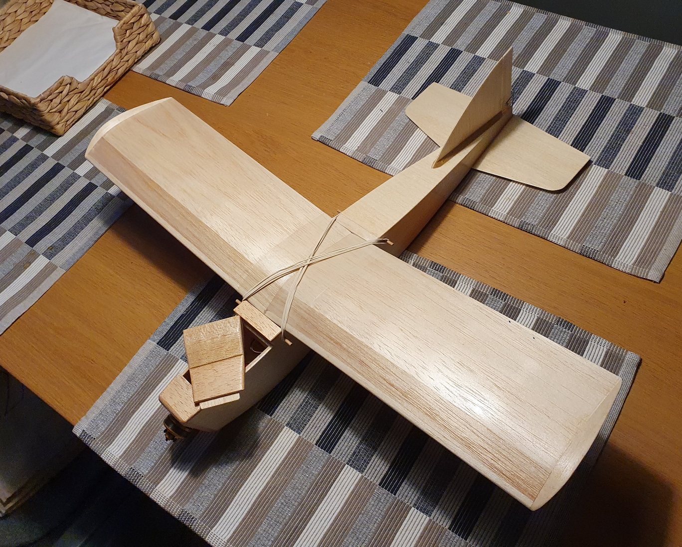

The following are a few pictures of my Sharkface with one of my R/O bricks, this Sharkface weights in below 250 gr. with a 2s LiPo ready to fly.
