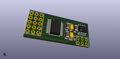

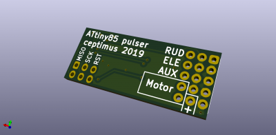

Here's what the board will look like without any headers fitted. Board size is 35mm x 15mm.
Front of board: click for bigger view.
Back of board: click for bigger view.
I'll get the gerber files done. I'll give it a day or two in case anyone spots any mistakes or has suggestions for improvements. Then I'll get the first batch of test PCBs ordered. I think I'll be able to assemble these surface mount components okay using the hot plate or toaster oven method. Like I said, I would have liked to use the smaller DRV8838 chip, but I think soldering that would be beyond my skill level! :shock:

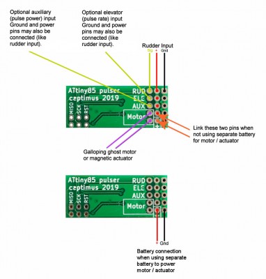

I've added a manual, in pdf form, to the opening post of this thread. The image below is probably the only thing from the manual that most Mode Zero readers will need.
Click for larger version.
