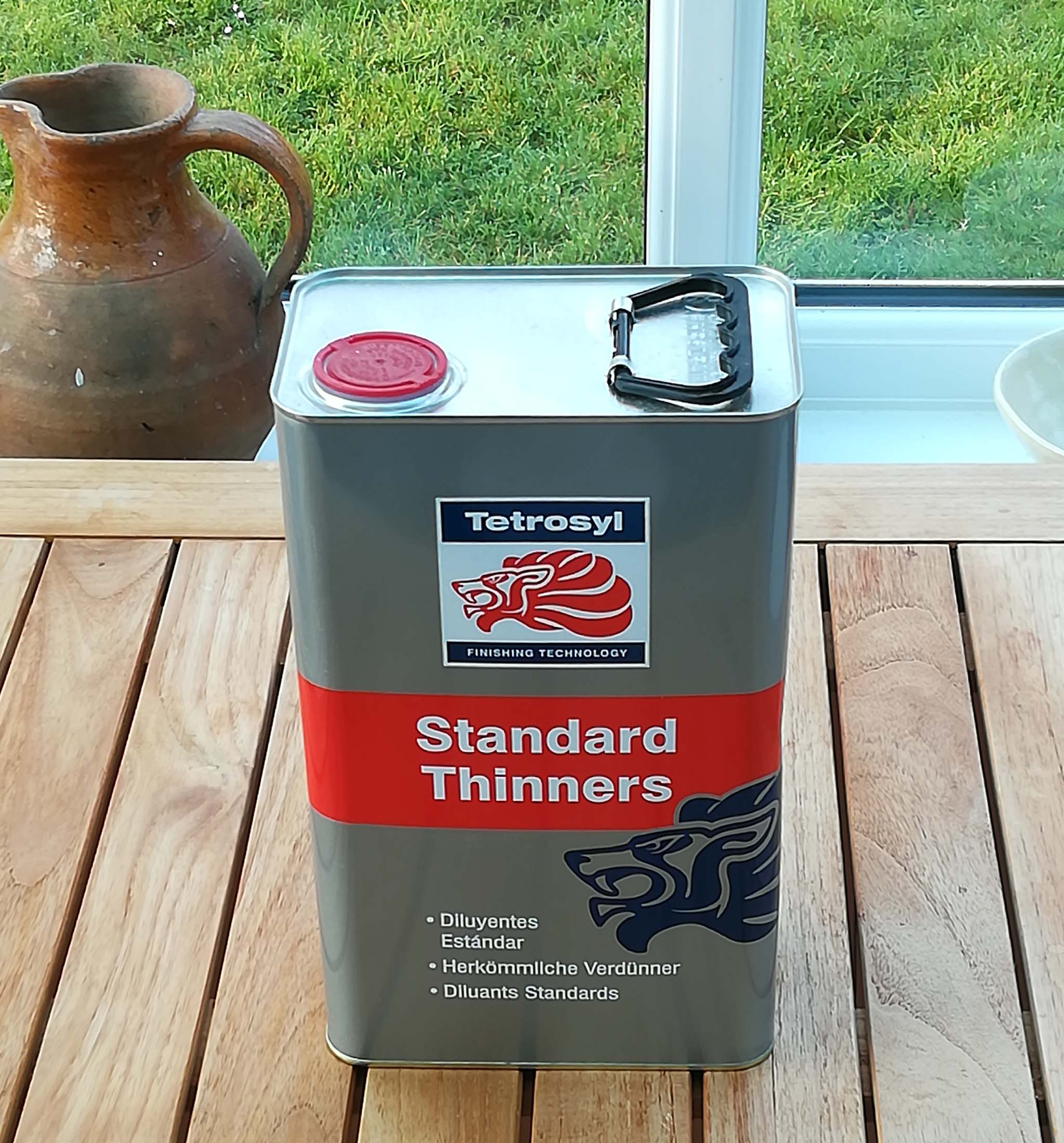

What brand of cellulose thinners are you using? I bought a litre can mail order at great expense and in six months it's taken on a brown tinge - which as I like to use white tissue (takes me back to my 'pocket money' days when you used what came in the kit) means that it can only be used for cleaning brushes....
- Posts: 605
Re: Synthetic Tissue
I use quite a lot of thinners for other things and use some of it for thinning clear dope and any other modelling applications. I buy "Standard Thinners" in 5Ltr tins from anywhere that's cheap........
This one was was £18 from a car goodies shop in Ipswich but I think most paint suppliers stock it, usually at around £22 - £25 though if your're lucky you may find it for less.Paul
