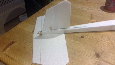

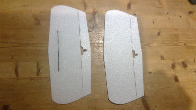

This the tailplane
Two versions
Lightweight with thin c/f on leading edge to stop rubber band cutting in
Beefed up version has a c/f spar which hugely improves rigidity

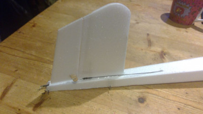

This the tail end - c/f pushrods - fin has a short section of c/f that goes up about third of the fin and down through the top and bottom of the fuz
I should add that the laser cut missed off the front l/e of the fin - hence a slightly less attractive shape!

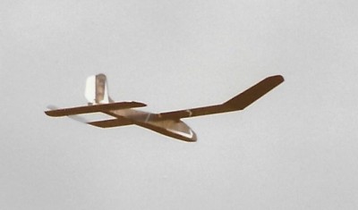

Hi - I've just joined and spotted this post. This was my first RC glider around 1975 - and reintroduced me to sloping in 1990. It survived well until my son over did it on a loop and folded the wings. Nice to see it wasn't just me that had one! I recently brought the RM magazine article and wondered if I fancied building another. Lovely to fly on alight day on the slope. I put on a much larger rudder and flew it with a Waltron 4-5 set.

Mine in the photo ended up with ply doublers on the outside of the fuz under the wing and more a the tail...well, I was 14 and learning! But it still flew nicely in the '90s. Totally irrationally, but I'm seriously considering making another! As if I don't have enough gliders...or can you ever?
