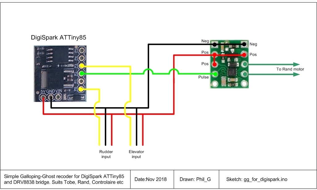

DigiSpark port connections are:
P0: rudder channel input from the rx
P1: is the digispark's on-board LED used to indicate pulsing
P2: output to the DRV8838 bridge
P3: elevator channel input from the rx
P4: unused
P5: unused

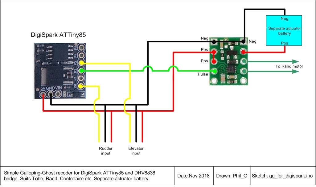

This way the actuator is powered from the receiver supply, but as with the PIC recoder, the actuator can optionally have a separate battery if required by chopping the receiver positive supply to pin 9, and providing a new pos from the separate battery. The negatives are common:

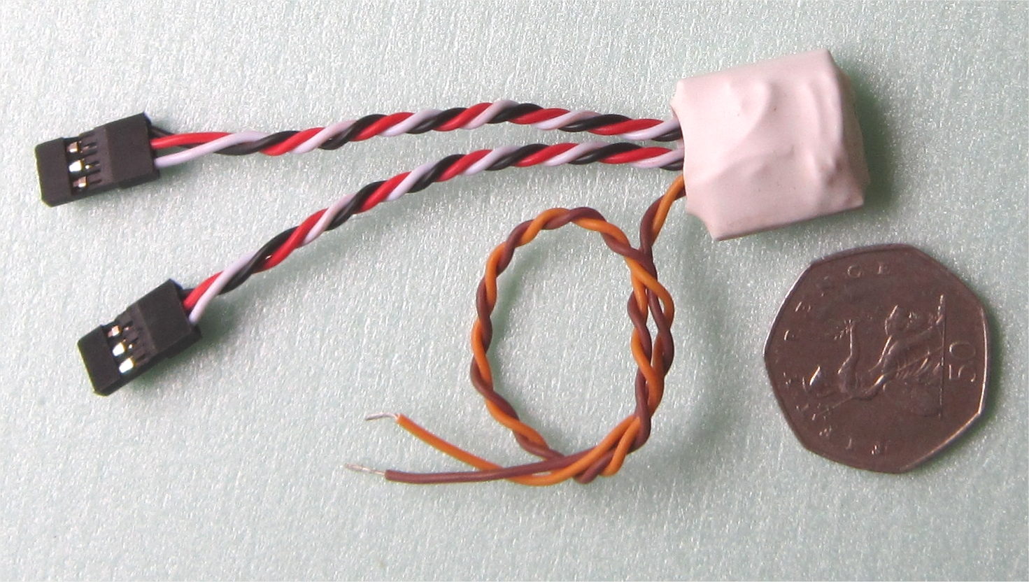

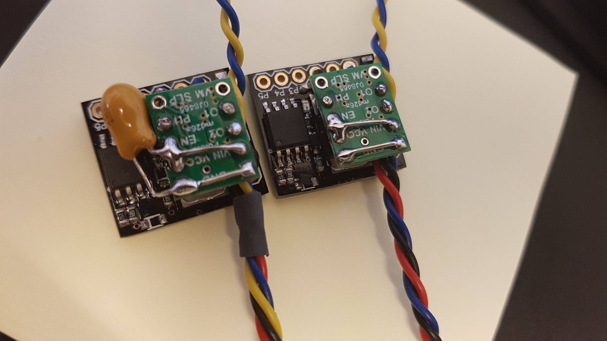

Here's the finished recoder in heatshrink. Tobe's build of the PIC recoder is minute in comparison, but its still small enough to hide (under 1" square by 1/4" deep) and the larger size makes it much easier to assemble. Its slightly smaller than the 'easy' veroboard PIC layout:

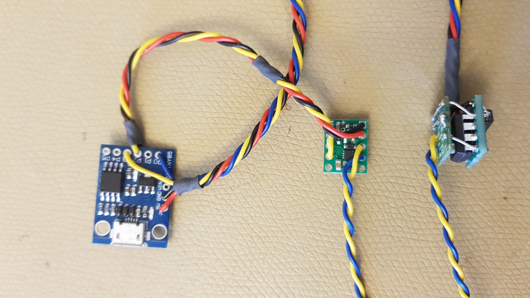

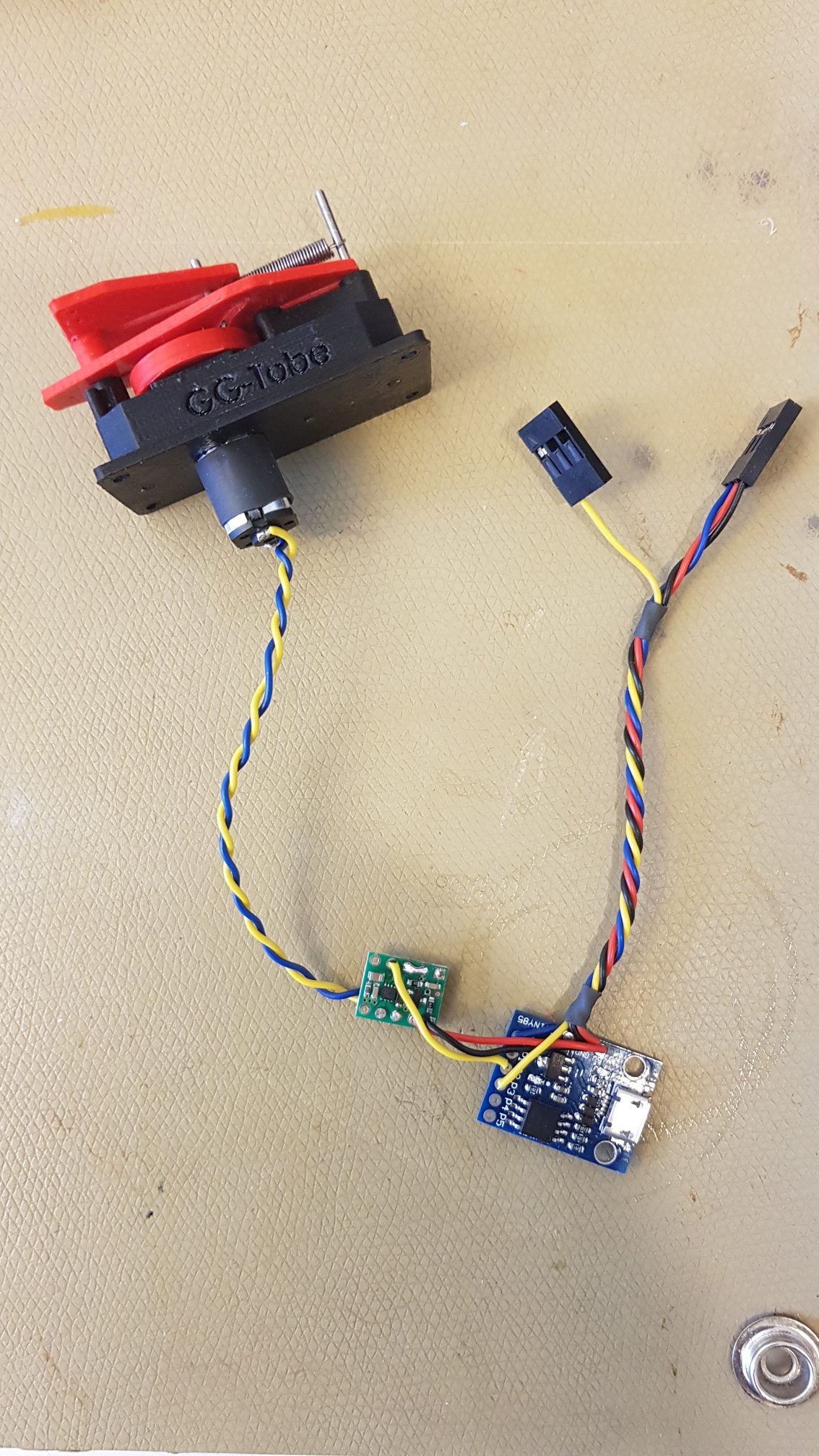

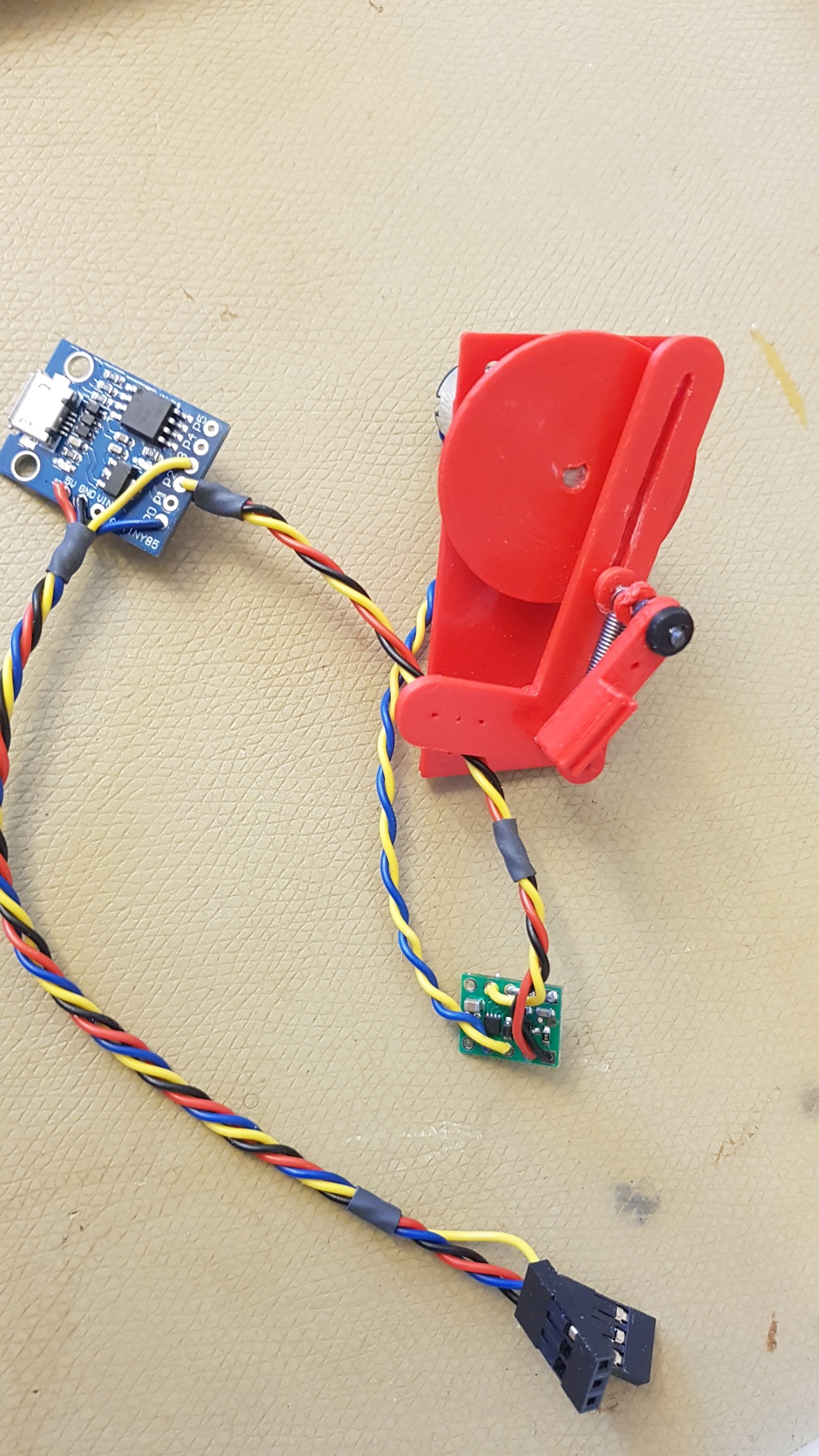

Here are mine first 2 DigiSparks Recoder connected to some of my projects. In one of the pictures I show the DigiSparks together with the PnP Recoder with Phils PIC circuit, both uses the same DVR8838 Poluolu driver
