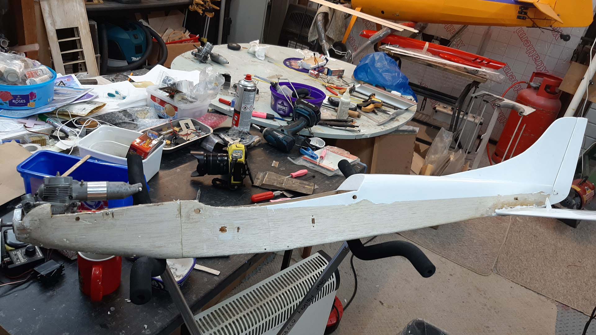

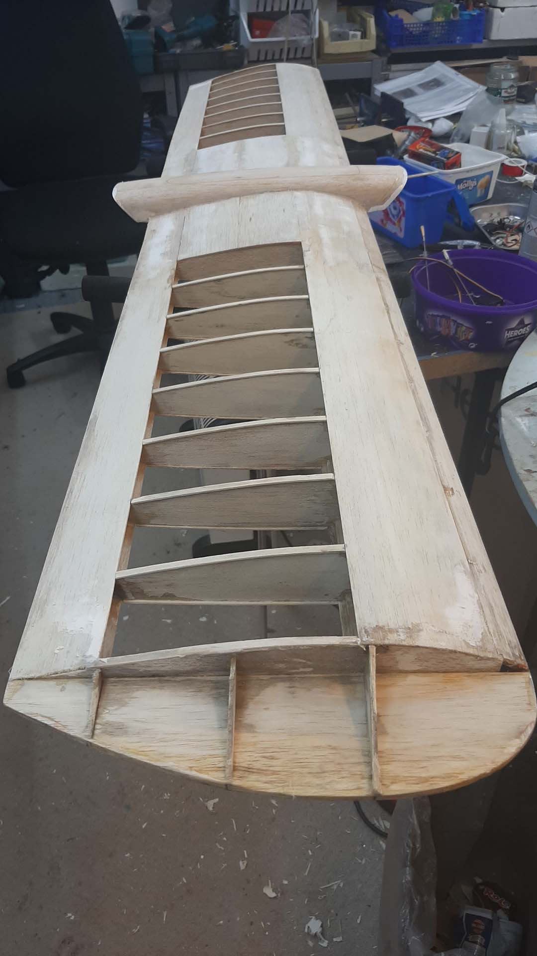

Re: Veron Concord plan
Posted: 19 Dec 2020, 21:34
by stuart mackay
Thank God, I stripped the covering off, as one wing tip was soaked and going mouldy inside the covering.
Letting it dry out completely and some bleach took all the black mould out of the wood.
Progress so far.....

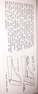

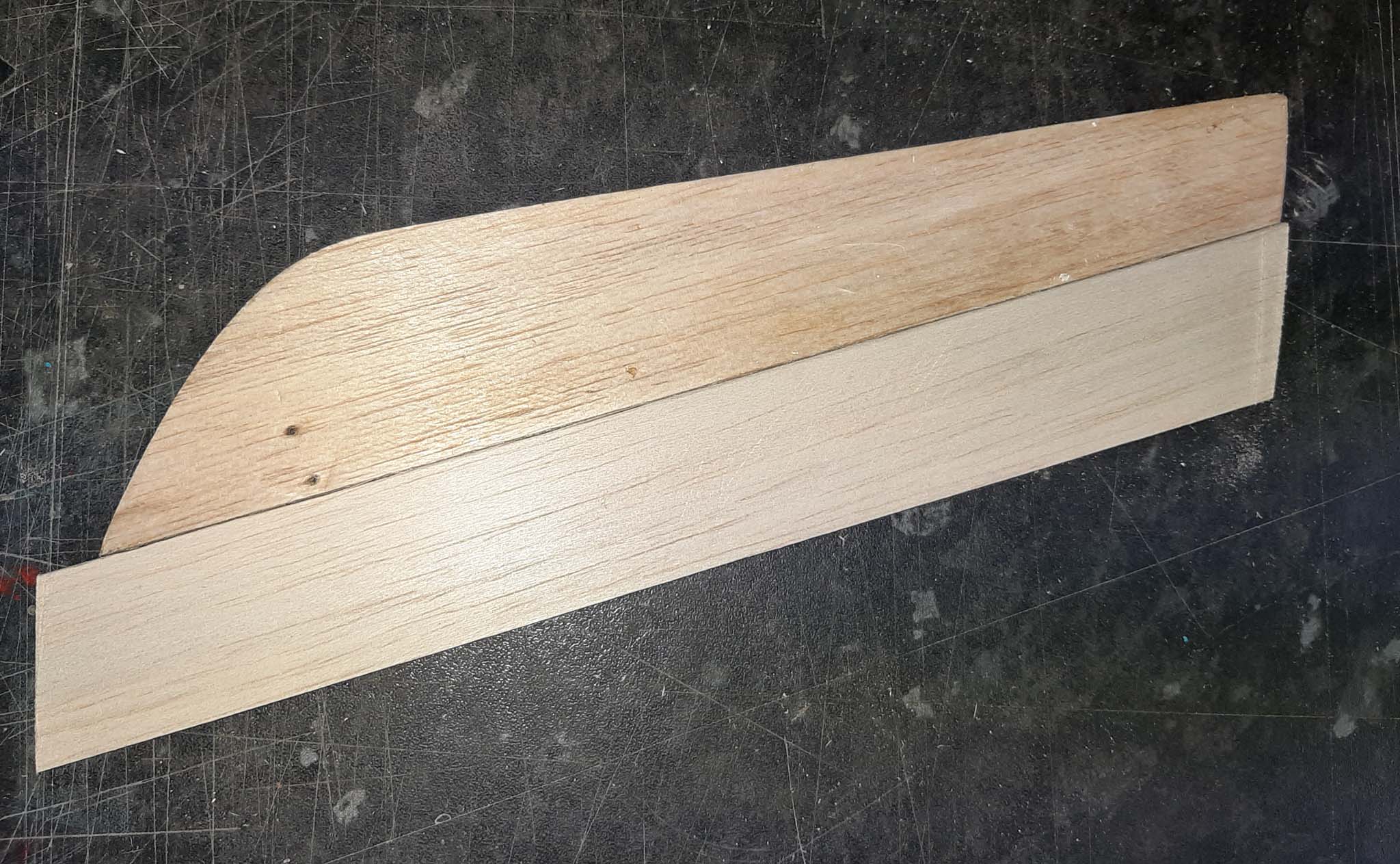

Posted: 20 Dec 2020, 18:46
by stuart mackay
Extending the rudder area for more authority
Posted: 20 Dec 2020, 18:58
by Shaun
Plan rudder worked fine on original one be Stu. Plenty of authority.

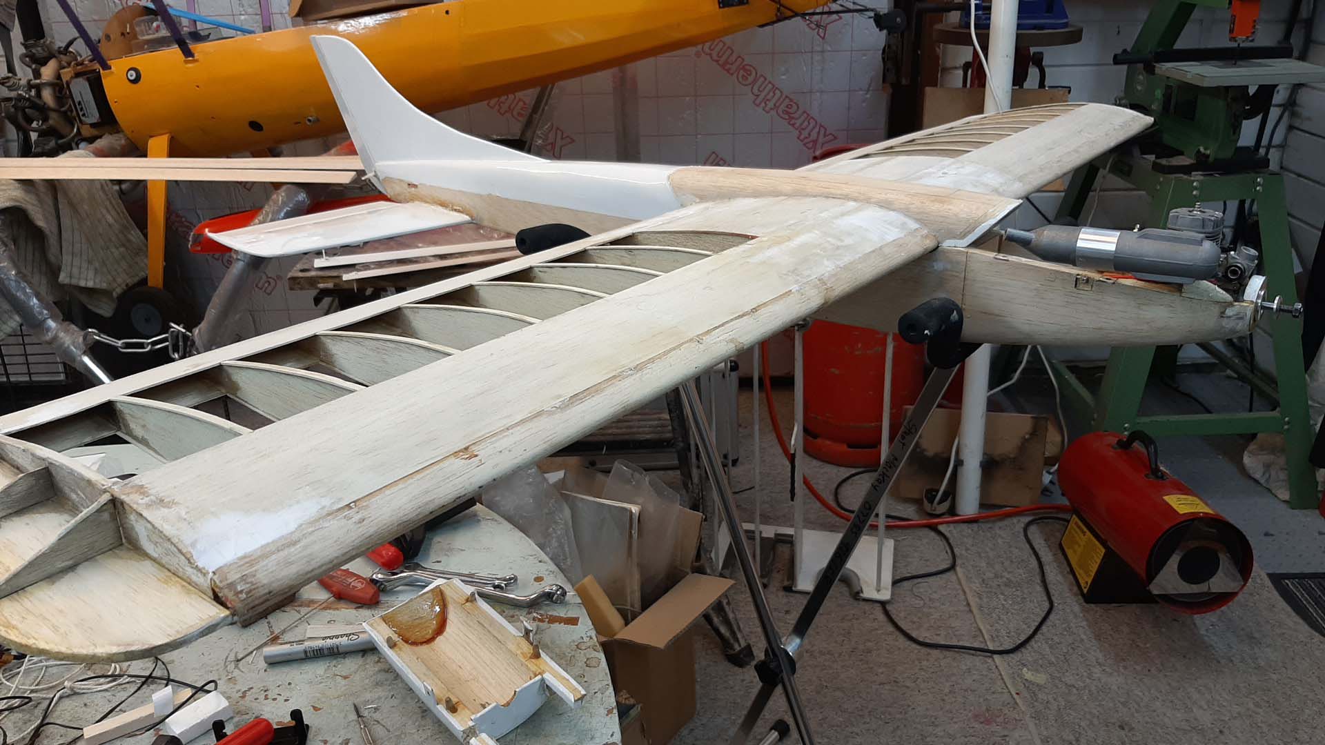

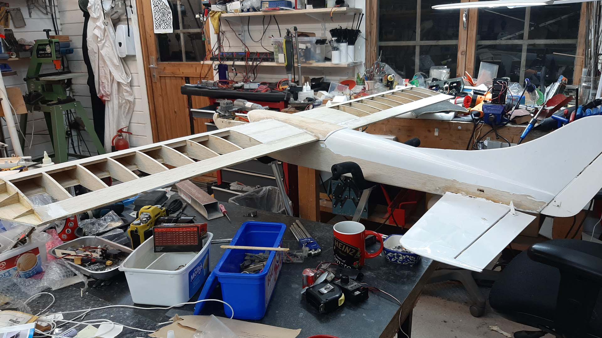

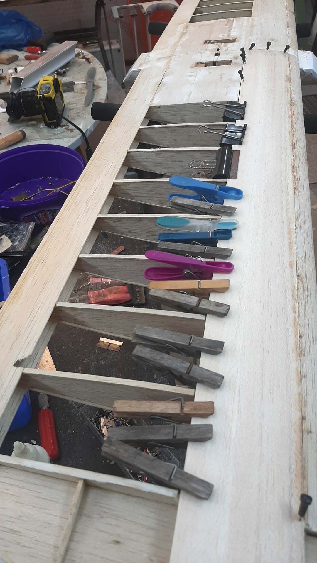

Posted: 29 Dec 2020, 20:19
by stuart mackay
Slow but sure progress in the Swaffham balsa dust factory!
Covering getting perilously close after removing the glued on stab and made into a bolt on affair as I have done with the wing.
New ailerons fabricated and wings fettled and fuse/tail/wings all +realigned.
Am pretty sure the airframe has been built from an original kit many years ago judging by the amount of spindle moulded components in the fuselage structure.
