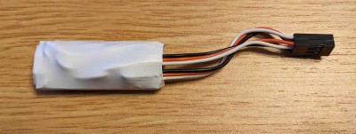

Instead of using a Uno, I've made all of mine using a Nano with the "6-pin lead" made from two servo leads/plugs glued together with Cyano. You need a Nano with the header pins NOT soldered (they often get supplied with the headers already soldered).

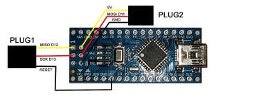

I have not soldered the leads into the normal D11, D12, D13, 5V or GND pins, but used the Nano ISP header as it has duplicates of those connections. The only one not connected to the normal pins is the target RESET pin that is connected to D2 pin (the official instructions has it connected to D10, but I altered one line of the code to be D2 as the D2 pin is closer to the other connections I'm using to keep the wiring tidier). You can program the Nano either via its USB connector or if you already have an ICSP programmer, you can program it by temporarily using a 6-pin header in the icsp connections.

Wiring (see optional 'colours' comment in following post)

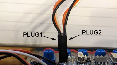

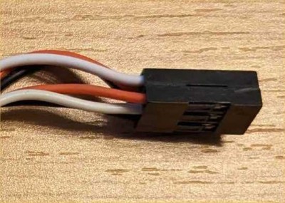

Using one 'Futaba' black/red/white lead and for the other one a 'JR' brown/red/orange helps orient the assembled plug.
When glueing the plugs together you must get them the correct way around!
ie both Futaba blacks at the same end, or Futaba black and JR brown at one end:
Then I heat-shrink the Arduino Nano

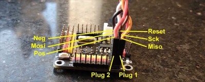

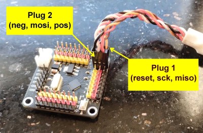

Connecting the ISP to an Arduino Uno and Nano is easy via their 6-pin (3x2) ISP header. Unfortunately most Pro Mini don't have an ISP header, so you need to connect directly to D11, D12, D13, 5V, GND and RESET pins on the Pro Mini. If you are making your own ISP you can make one with custom leads, D11, D12 and D13 are next to each other so a servo plug will directly fit to them and Vcc, RESET and GND are together, so another servo plug can directly connect to them, just ensure you get the servo plug the correct way around as it is easy to reverse the plug and reverse the polarity on a Pro Mini (don't ask how I know). The two servo plugs for the Pro Mini obviously are not glued together, but mark them carefully so you know which way around to connect them.

I've been meaning to try an "Arduino as ISP" programmer but its never been a priority as my usbasps are no trouble, so having decided not to go sloping today, I wired one up and of course it works fine. As I was doing 'plug 2' (pos, mosi, gnd) I thought I'd swap the red & white in the servo plug and on the Nano connections, to make it more logical - so red & black were pos & neg on the ICSP header and white was mosi. Then I noticed that I think Mike did the same!
This is only about colours, electrically the connections are exactly the same either way.

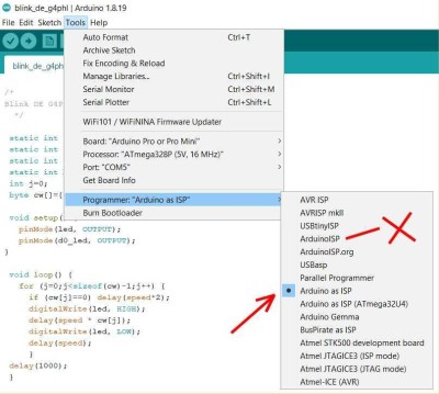

Another potential 'gotcha' is correctly selecting the programmer as "Arduino as ISP" and not "Arduino ISP" :D
As with a usbasp, use "Upload Using Programmer" not "Upload". Otherwise "Upload" will program the programmer itself with your sketch!

Phil_G wrote: 01 Nov 2024, 13:45 As I was doing 'plug 2' (pos, mosi, gnd) I thought I'd swap the red & white in the servo plug and on the Nano connections, to make it more logical - so red & black were pos & neg on the ICSP header and white was mosi. Then I noticed that I think Mike did the same!
Yes Phil, I do swap the servo wires so red is +5V and the white is MOSI, but explaining that in my instructions was too difficult, so I didn't. Trust you to have noticed!

Some more pictures. You'll see that on Plug2 we swapped the pos & mosi colours at the plug end and also at the Nano end.
Electrically, provided you swap both ends, it makes no difference, its just colours.

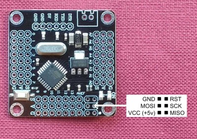

AS the target board that board supports 5v on the ICSP port as denoted on the silk screen on the board. If you are intending on using this board as the ICSP programmer then it will output 5v because the uP is a 5v version and there is no 3v3 regulator on the board. You would need a bi-directional 3v3 to 5v level changer to drop the 5v signal to 3v3......or you could use a 3v3 Arduino micro...but then you will need a USBASP to program it :-)
