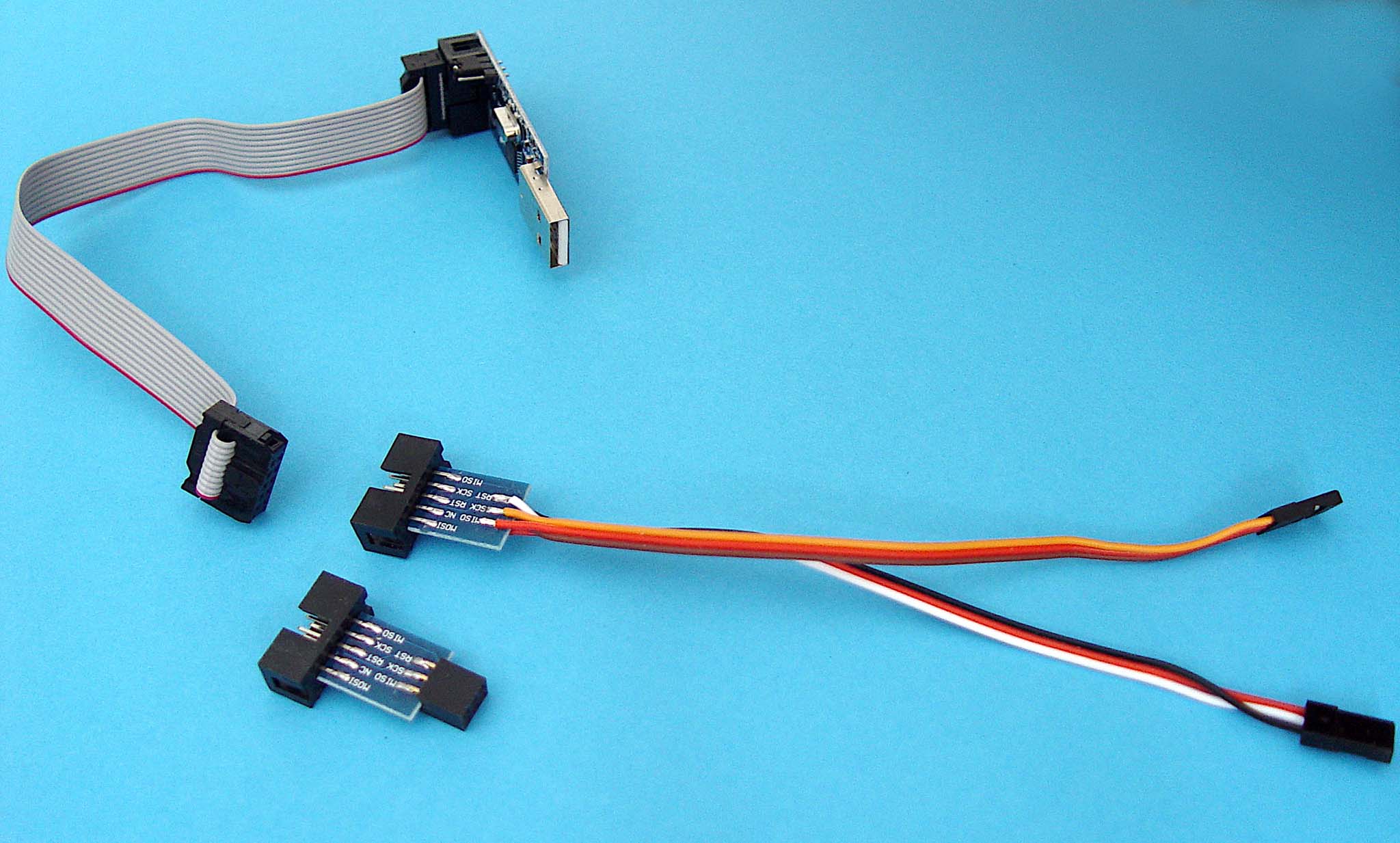

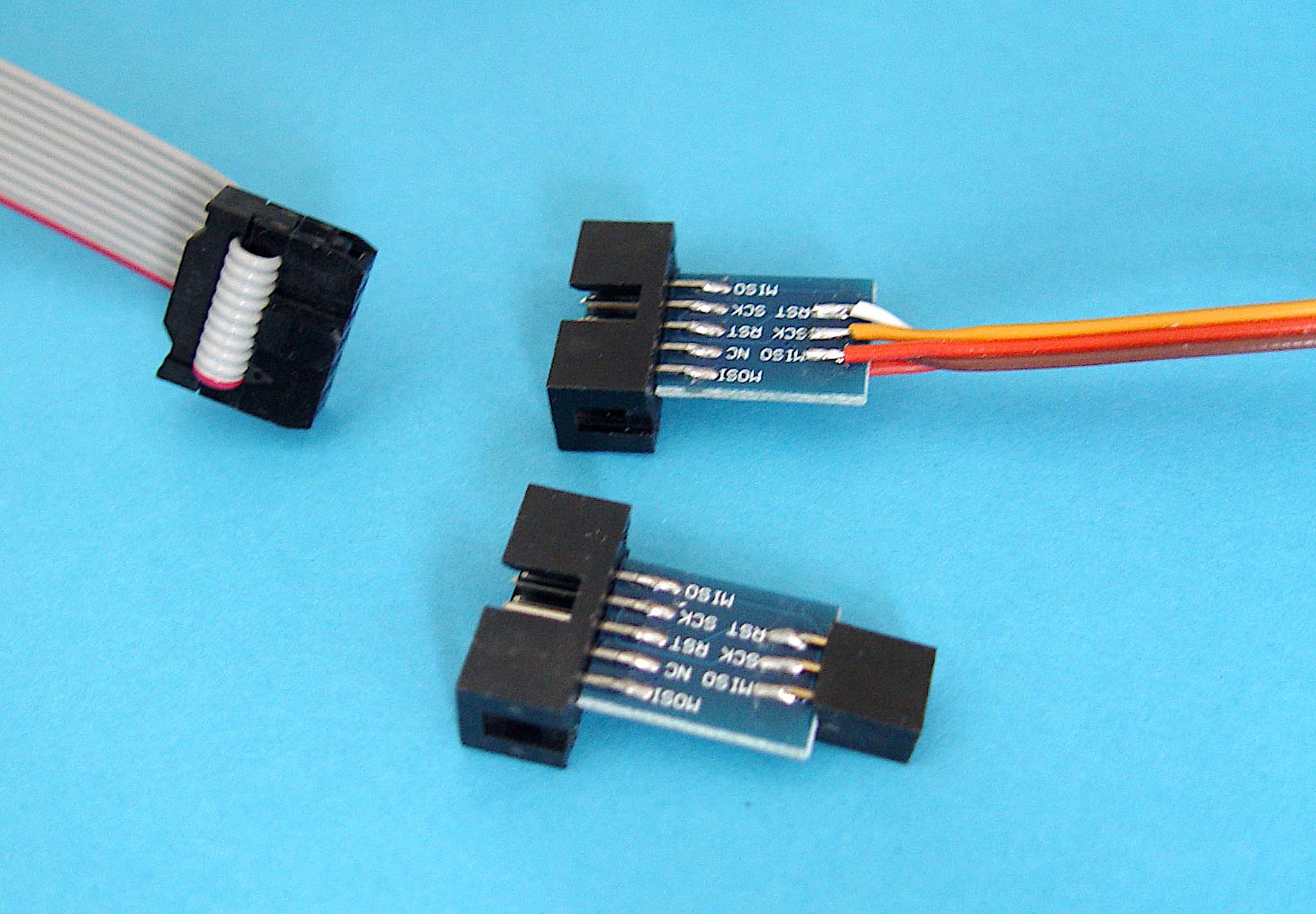

Firstly, you need to acquire an USBASP programmer. I purchased this one: https://nl.aliexpress.com/item/1pcs-Sma ... Title=true which came complete with a 10 to 6 pin adapter. I managed to find a second adapter, which I converted to a twin servo lead arrangement as Mike_K describes in his documentation. Pictures:

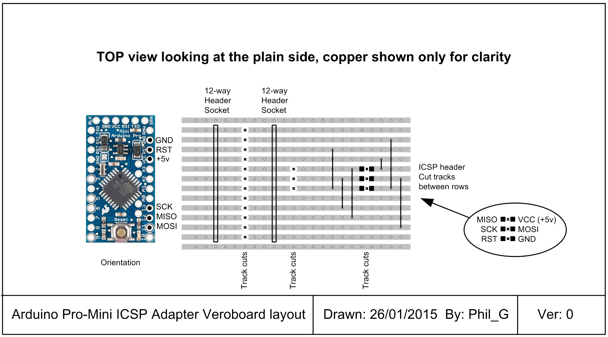

This is my Pro-Mini ICSP adapter:

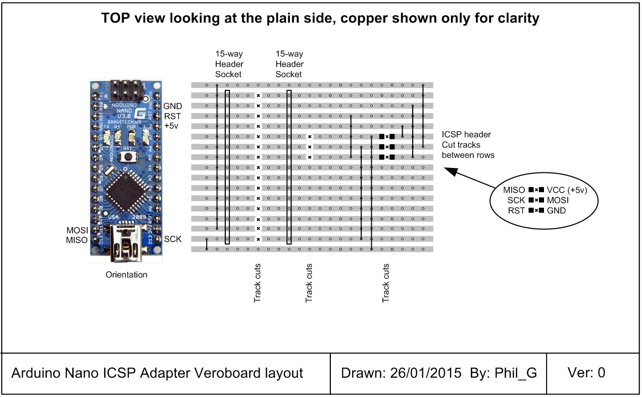

...and if you use Nano's, but like me you dont fit the intrusive ICSP header, heres a Nano ICSP adapter:
