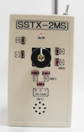

I will introduce the single stick transmitter I made.
Single stick 3 channel transmitter "SSTX - 2 MS" is a single stick type 3 - channel proportional transmitter using "3 axis joystick".
It was completed in May 2015.
(PIC16F88)
· Proportional control of rudder by right / left operation of stick
· Proportional control of elevator by vertical operation of stick
· The throttle is controlled to be trimmable like a multi in the left / right rotation of the knob.
· Throttle can also select 3 point switching of single channel.
(SSTX 2 - MS: M = multi, S = single)
It is a transmitter that can maneuver a 3 channel airplane with one hand and it can be said that it is a convenient transmitter for "people who need to maneuver with one hand".

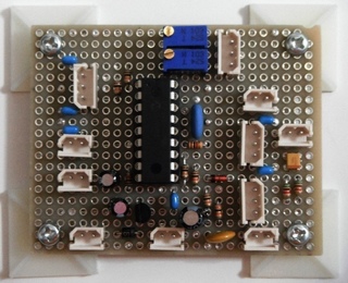

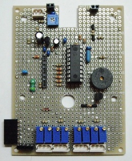

(Propo related)
· 5 channel propo board
https://oteru0106.exblog.jp/24041640/
· Single propo board (1 + 1)
http://singlechannel.seesaa.net/article/430062248.html

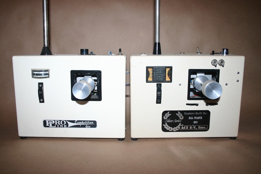

Hi<
Added these because I think the metal gimbals are really cool.
All the best,

Thanks for your comment
The metal gimbals are beautiful
