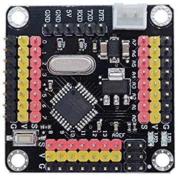

Does anyone know what modifications need to be made to the new DIY More Pro Mini Strong boards? I assume that the Schottky diode needs to be shorted, but is there anything else that needs to be done? I seem to remember a thread on the singlechannellersreunited board, just before it shut down, but I didn't make any notes.

hangflyer wrote: 05 Mar 2018, 23:54I assume that the Schottky diode needs to be shorted...
Hi John, I wouldnt assume anything without tracing it out. On the previous version of the DIY-More boards, the schottky was removed. On the Deek-Robots it was shorted. They're all different.
In either case the purpose of the mod is to provide a convenient 3-pin header with Neg, Battery v, and PPM, for the RF module.
On a Strong board I would put my PPM on the rx pin (D0) as per the others but the trick is modifying the adjacent 5v pin to make it behave as a battery-level output. I havent yet seen one of these new boards so I cant advise - it needs investigating properly, & not guessed - maybe someone else has already done the work?
I could do it if anyone has a spare board to send me, but I have a stash of 30+ DIY-Mores so didnt intend ordering Strongs for a good while.

I have several of the Pro Mini Strong boards here, but I think I got the 3.3 volt versions by mistake. I later realized the Pro Mini DIY-More boards you sent me had a 5 volt regulator.
I would be glad to send you one of my Pro Mini Strong boards to evaluate, and tell us how they can be used,
Jay
