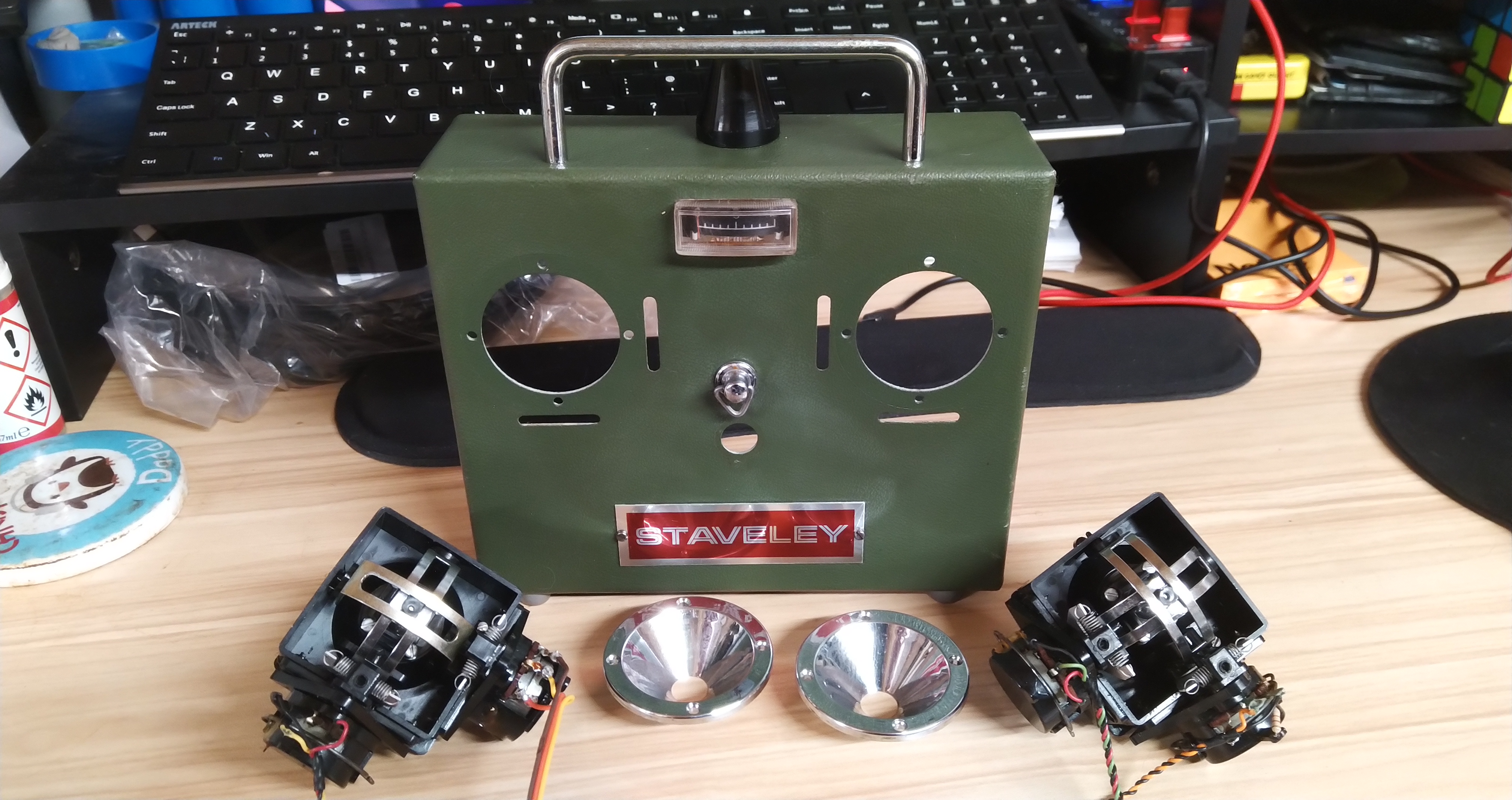

Here's the Staveley I was very fortunate to receive today from Mike and Stu (thank you again both :D :D :D ), I forgot to take a 'before cleaning' photo but will post a few pics as the project progresses. Inside is a 1969 datestamp which corresponds to me being 14 as I remembered, I thinks its been damp at some stage of its long life (no retirement for you, Staveley!) and there was a bit of corrosion, to be expected in a 52-year-old set ;) , but a generous coat of Castor oil varnish has kept the case quite well protected! I dont feel at all guilty converting this one as the PCB and the elevator pot tags were green/blue with verdigris so ideal for a new encoder, but I was pleasantly surprised to find all four pots were 5k, not what you'd expect in an analogue set :D

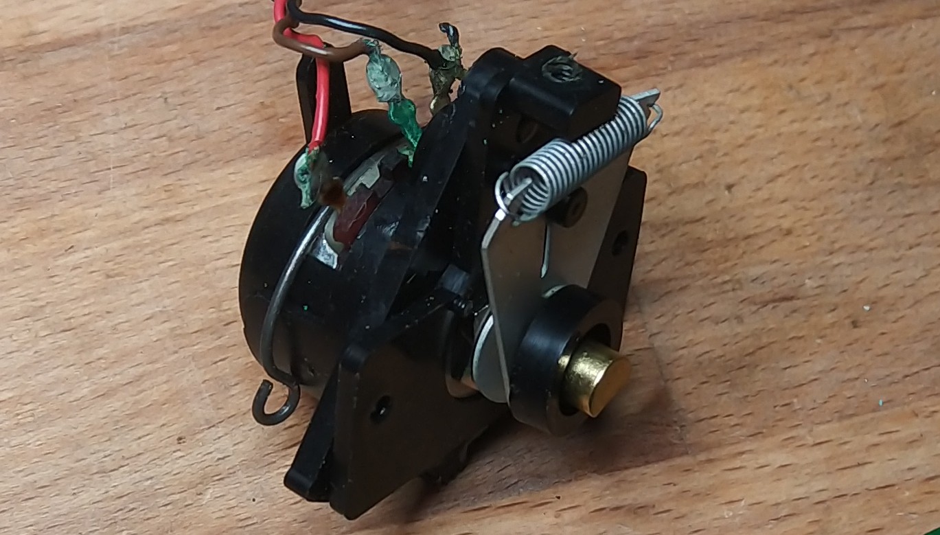

The throttle stick felt only loosely connected to its pot, but luckily as it happens I had just enough Kraft bits to swap the broken throttle yoke and the corroded elevator pot, and I now have two good stick units. Externally it has cleaned up quite nicely, the chrome bezels had encrusted castor varnish which eventually gave in to brake cleaner and a determined scrubbing:
Still not sure what module to use, maybe 35 with one of the Jamaras, but then I have Frsky V8 & D8, plus the Lemon prototype - which I feel I ought to use as I've only bench-tested, not flown it - or another NRF... I dunno yet. This is going to be a really nice set but its for flying, not display! :D

Almost good as new! Not at all bad for a 1969 set, fifty-two years old!
No conversion as yet other than cleaning up the case, switch & stick pots, still not sure whether to use the Lemon 2.4g module or to go 35mhz :D
