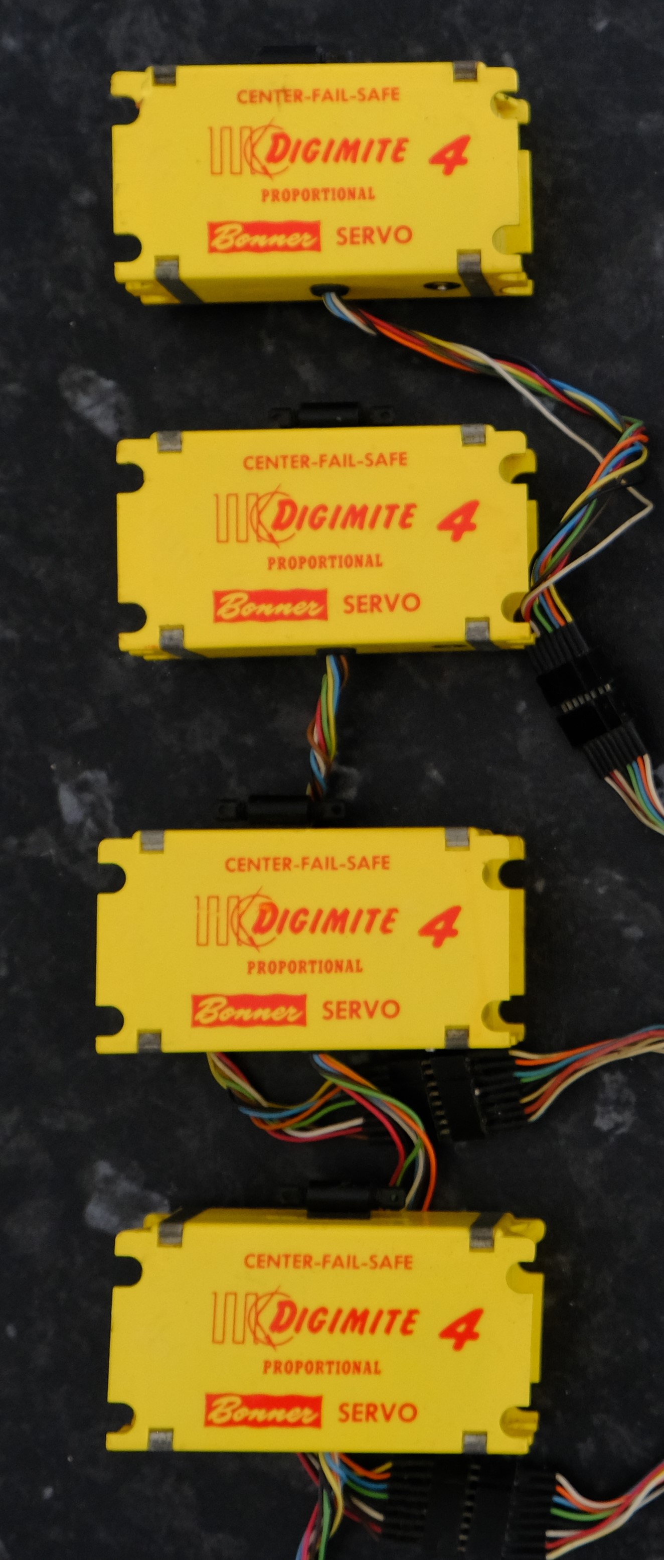

Thanks Pete!, co-incidentally, I have just been taking some pics of the Bonner Set and I noticed that they had end or centre failsafe exactly as you describe!
That is that answered comprehensively & as we have learnt to expect from "our" resident Vintage Radio Tech Expert! :D :D
So do you think he copied the Bonner electronics to use in the Orbit PS2 servos mentioned in the article?

I don't think so. I don't know if you've opened up a Digimite servo or not - be VERY careful if you do! Little ball bearings tend to fly everywhere! The Digimite-4 was quite different electronically from the original 8. I've never had one apart, but I think the amplifiers were at least partially in the receiver. The output rack had a couple of wipers pressed against a PC board at right angle to the main board:
ImageDSCF2141 by Peter Christy, on Flickr
(Seen here above and beside the red gears)
One wiper ran along a linear wire-wound pot track soldered into the board. The other ran along the "fail-safe" tracks. One terminal of the motor connected to the centre-tap of the battery. The + and - ends of the servo supply went to 1) the amp, and 2) the failsafe tracks. In the event of a fail-safe, the motor would drive until the wiper left the tracks (gap in the middle for center failsafe, or at one end for end failsafe). As far as I'm aware, Orbit made no mechanical provision for this.
The receiver pack on the 8 was a 7-cell, with multiple tappings. For the servo drives, the important ones were -, +2.4 (centre-tap) and + 4.8.
