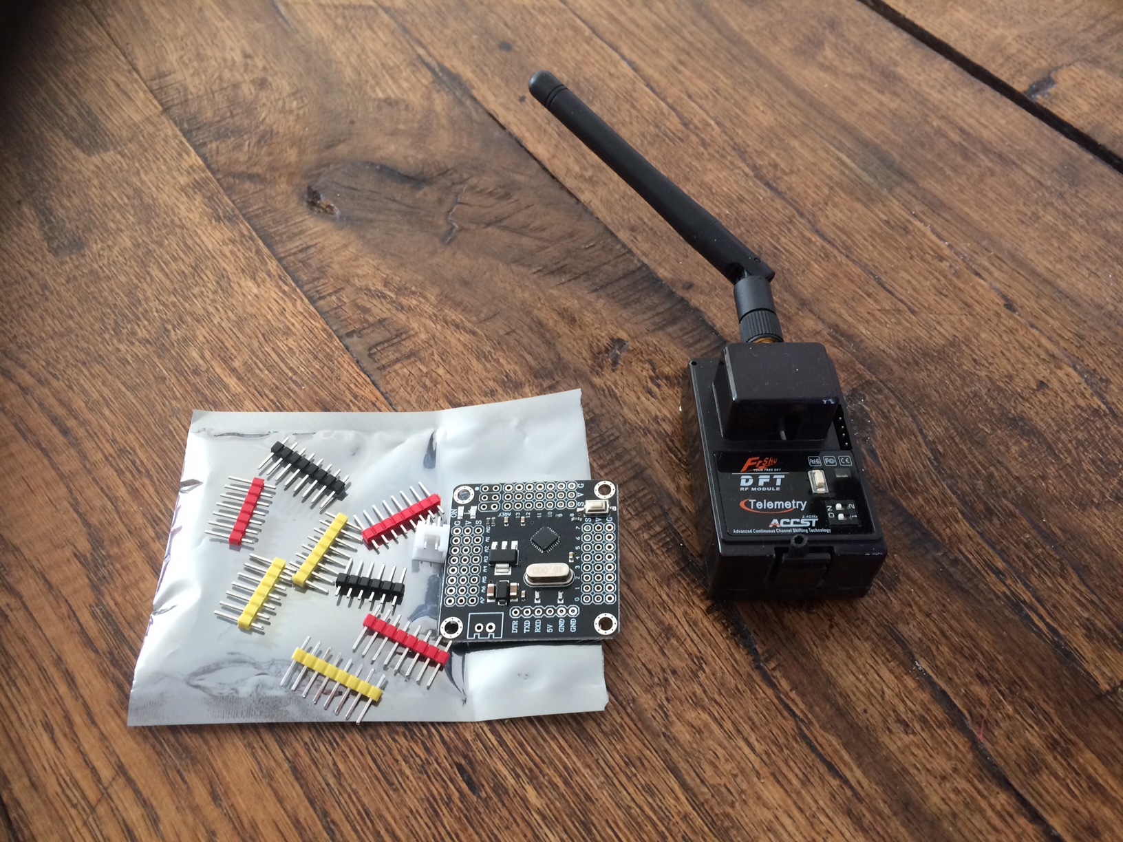

Hi there,
I recently acquired a Frsky DFT module and a pro mini strongboard (see photo).
I hope I can use that to transform my Multiplex Digitron 4/6 -27 mc transmitter to 2.4 ghz.
Anybody used the combination DFT module and strongboard before and tell me if this has good chance to succeed?

I have that combo in 2 conversion and very pleased

Tobe wrote: 26 Feb 2021, 17:08 I have that combo in 2 conversion and very pleased
Ditto for me too!
