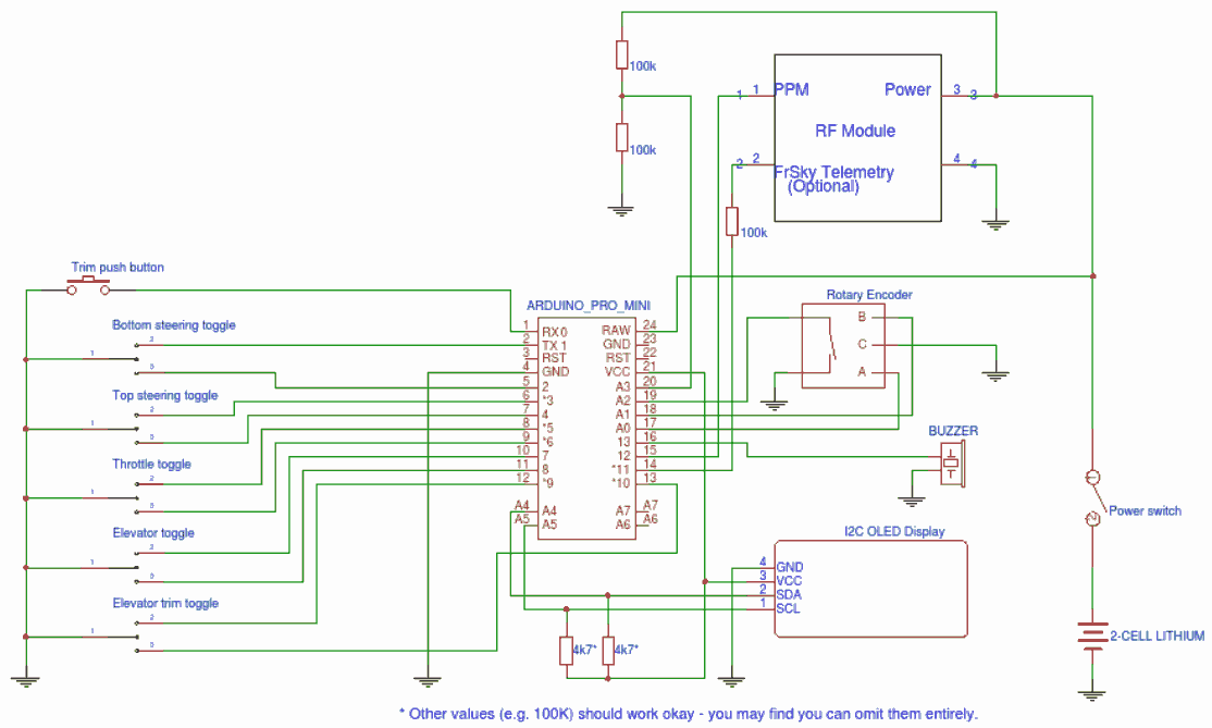

Can I get details of the rotary encoder/switch shown in the schematic.

Hi Clive,
This is sort of thing you need: https://www.ebay.co.uk/itm/3Pcs-set-6mm ... 2228998536
That's 3 pieces with free shipping for 99p. You can also get them with a PCB with connector soldered to the back as shown in the picture - but you don't really need that - it unnecessarily complicates things by having pull up resistors and a VCC connection - which are not needed as the Reedy 10 sketch enables the Arduino's own internal pull-ups on the inputs. You probably also want to buy a knob to fit the 6mm shaft, unless you already have some or want to make one from a bit of wood or similar.
The two big 'pins' on two opposite sides are just for mechanical support and can be ignored. That leaves two pins on one side which are just a momentary switch when the encoder is pressed, and three pins on the other side which are the 'A', 'common' and 'B' inputs from the rotary part of the encoder. For the Reedy 10, one pin of the switch and the common (centre) pin of the encoder go to GND, the other pin of the switch goes to A2 and the 'A' and 'B' encoder pins go go A0 and A1. Once the Reedy 10 is working, if you find the encoder works backwards (clockwise decreasing instead of increasing) then just swap the 'A' and 'B' wires on A0 and A1,

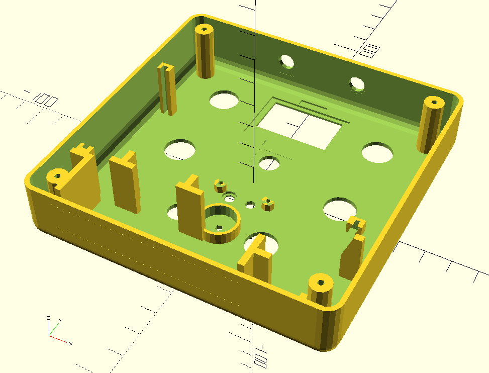

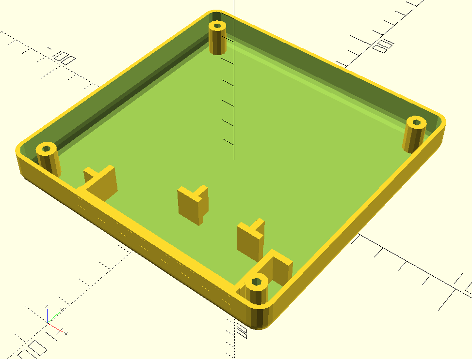

is there any chance getting the 3D print Case info for your Single Channel transmitter and for the Reedy 10 transmitter case (ReedyTenCase_STL_files) back? They were lost in the old forum and I would like to give it a try to print out those cases.

Hi Frank, Sorry for the delay. I was working away from home and had no access to my CAD files till today.
- Attachments
- ReedyTenScad.zip
- (3 KiB) Downloaded 268 times

Thank you for the files. I found a guy, who is printing 3D for a very reasonable price here in Germany, so I will give it a try to get some more enclosures printed.
I also will try to learn a bit about OpenSCAD. I will try to draw a case of the Engel Uniton Handy transmitter.
