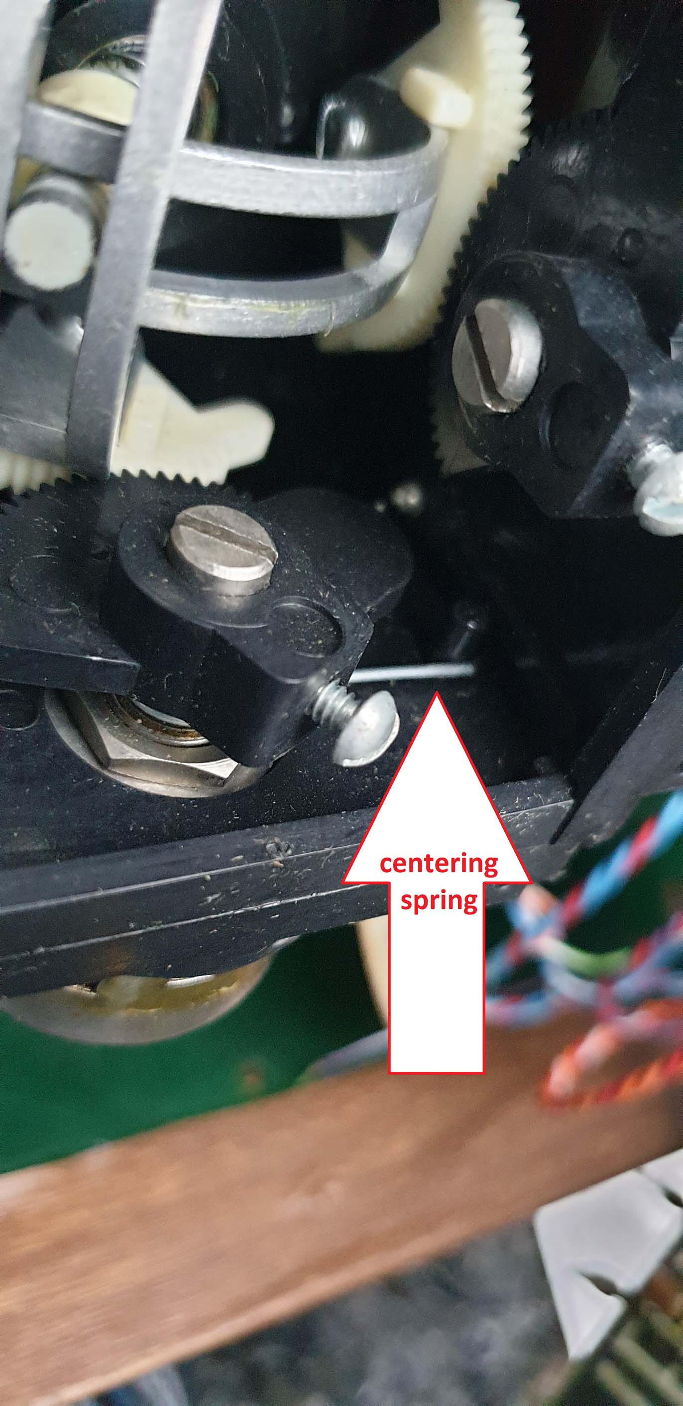

The next Tx is badged as a Micro-Avionics, as is the pcb. Where it gets interesting is that the case is clad in wood grain vinyl, the same as the S/C RCS tx. As you can see from the pictures, the original case is anodised green like some of the F&M or CSE reed or early proportional trannies.
There is some tell-tale corrosion on the pcb that has been cleaned up previously, but there is no evidence of corresponding corrosion on the inside of the case. Perhaps the original case was so corroded, that another case had to be put to use?
The stick mechanisms are different to anything I have seen before. They use a geared arrangement to drive the pots, and a flat wound centering spring with two fingers.
My intention with this one is to gently heat the vinyl to hopefully remove it a bit easier. If the green anodised case can be cleaned up, I'd much prefer to have it rather than the vinyl clad version :P

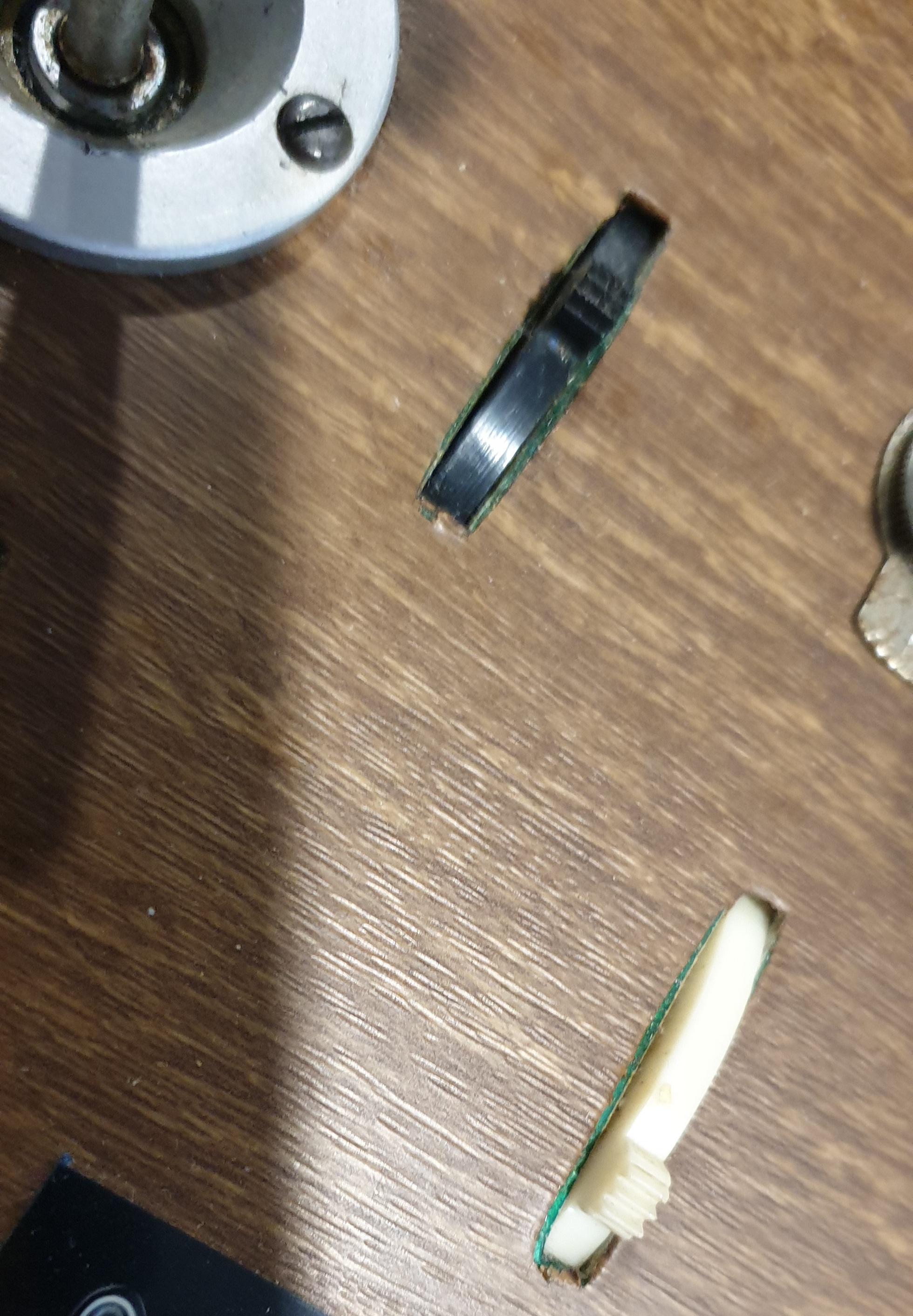

Thanks Mike. You got me thinking about the Micro-Avionics Tx so I went back and had a closer look.
The case front and back is anodised green, the woodgrain vinyl being added later. Compare these pictures:
my Tx - original green case visible under the vinyl cladding
Not a great picture, but you can see the green underneath the vinyl cladding.
another shot showing the green case under the vinyl.

Hi Wayne,
Your Micro-Avionics is interesting. It is an original green case that somebody covered with wood grain adhesive shelf paper.
The originals were all green, with the green and silver border logo on the front. The circuit board is from the 1st version of the Micro-Avionics and is a beautiful example of Don Mathes work. The wood grain is going the wrong way on yours, as it was oriented vertically on the originals.
The 1st wood grained versions were the XL series, next, was the ill fated XL-IC versions with orange cased airborne components. Micro-Avionics got all their parts from Orbit, including the meters, cases, servo mechanics, sticks and hardware. As such, they used whatever meters they could get at the time. If Orbit was out of stock of the newer silver faced meters, they supplied the earlier white face meters. Later, they ordered green/black meters for just the Micro Avionics, but ran out of stock and went back to using the earlier meters which they plenty of in stock. Electromechanical Corp of Perkasie Pennsylvania made these meters and they were used in Kraft, EK Logictrol, Orbit, RS, and many other USA brands. They could be special ordered with your company name and logo on the meter, but that took time and was expensive, so many companies, like Orbit, ordered the generic ones when they needed them right away.
The ill fated XL-IC series was plagued by the 1st generation Motorola MC- TTL series of JK flip flops that proved to be very unreliable and problematic due to them not being humidity proof and absorbing moisture. They would have logic problems and jump channels such that the channels would work, but on different sticks!!! This cause many crashes and problems because Motorola was aware of the issue but would not divulge it to their customers. Bob Novak was the designer and engineer in charge of the XL-IC series and it would have been a huge success had it not used the defective Motorola logic chips. In short order, Orbit sold out to Datatron and that included Micro-Avionics as well. Orbit had kept this a secret up until they sold, but after Datatron absorbed Orbit and Micro Avionics, they combined them into one company and changed the color to Orange, and used Orbit circuit boards in all of the systems to simplify things.
Re: More Tx's for Resuscitation & Rebirth
Thanks Jay for your detailed response - it ties all the odd features of this Tx together :)
(Original) Green it shall be :D
