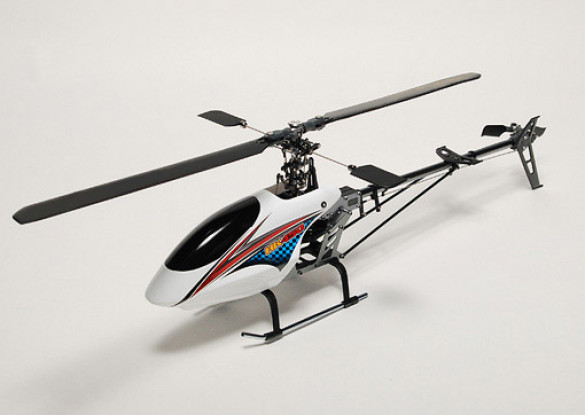

Picked up one of these yesterday for $15.00 brand new in the box.
Have to add motor,esc, servos but hey, bargain I think, can't really go wrong.
HK450

Finally managed to get around to finishing off and test flying.
Had to get my head around the settings menu in the Flysky FS-i6 but finally all dropped into place.
Main hastle was getting the swash plate to move opposite on ailerons.
Turned out to be under a heading Swash AFR and set the first to a minus value and all good now.
First flight seemed to be reving too high and lift off was above centre stick so cranked in some more pitch on the adjusters and it turned smooth and flew like magic.
Very happy with the outcome.
