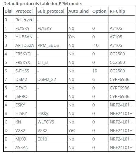

Gents,
I stumbled into this whilst looking for a viable replacement for the favorite FRSKY V8HT DIY module.
Got one en route to me, will report back on it goes.
Has anyone tried it?

- The Jumper 4in1 modules I've bought have been 100% reliable, but are supplied without the selector switch or bind button as it's assumed it'll be used in an OpenTx transmitter where it's all done from the menu. You'll need to buy a 16 position switch and tactile switch if you plan to use it.
- They are designed for use in a JR-module bay, so are not as convenient as specifically designed DIY modules such as FrSky XHT, DHT and V8HT or the more recent LemonRx DSMP DIY modules.
- In ppm mode they don't always (usually?) work out of the box for FrSky, Futaba or Hitec protocols (or any other that uses the CC2500), but have to be tuned. Yes really, they have to be tuned to a receiver! This is easy in an OpenTx transmitter, but laborious in a conversion
- The documentation supplied with most of them is misleading as their firmware was updated years ago and they operate completely differently to the supplied instructions. Update the firmware and just refer to Pascal Langers official documentation https://github.com/pascallanger/DIY-Mul ... -TX-Module
- The DSM2/DSMX support in PPM mode is also a pain as you have to select from one of 6/8 channel, 11/22mS, DSM2/DSMX which gives eight protocol options. In serial mode in an OpenTx it auto-selects, so is very usable
