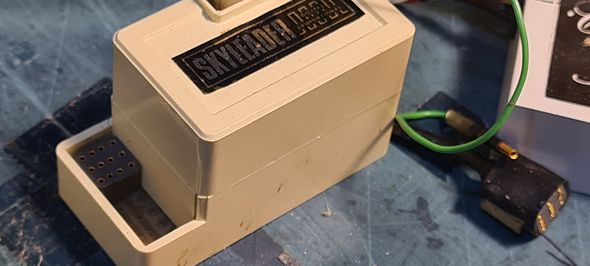

Just scored a Skyleader Clubman Super and a Multiplex Europa, with receivers, chargers and some servos. I'm waiting for them to arrive, in the pic I have there is what looks like a brick, did Skyleader make two channel bricks?
I would have posted a copy of the pic, but can't do that till I get home from work tonight, so I will post a pick in about 8 hours.

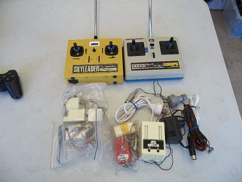

BTW, here is the pic.....
See the bag under the Skyleader, has two servos I can see and the other bit looks like a receiver brick on it's side, the other things in the bag can't be seen clear enough.

I think it's just the standard Skyleader Clubman Super AM Rx, it's double deck with the rf board on top and the decoder and servo connector block on the bottom pcb. The Skyleader TSX Rx were very similar, except the servo connections were on a fly-lead, but circuitry was the same. The later Skyleader FM Rx were a single deck Rx, with a different servo plug/socket.

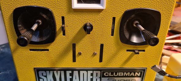

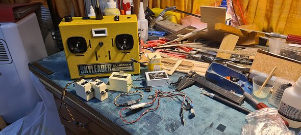

My purchases arrived today, the Skyleader Super Clubman turns out to be a two channel set converted to 29Mhz, the TX is mint as if it's never been used, there is a shielded button on the top of the case, no idea what it's for. The orignal receiver looks like it has not been converted from what ever the orignal, a second receiver with the brand CHM Systems was the one used with the TX.
Only two trims, aileron and elevator, and it's on the best mode, Mode 1.
The two receivers, two servos, flight pack, switch harness and one servo extention lead.
The orignal receiver looks like it's never been used.

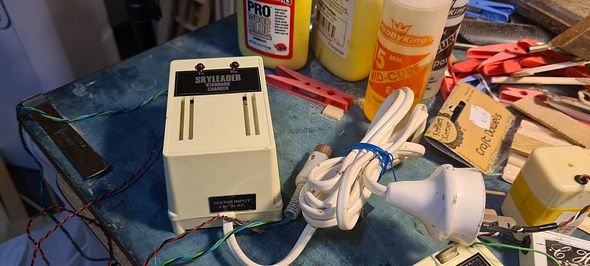

Original charger is gigantic, 240 volt version.
The servos and switch harness have been converted to Multiplex plugs, the original plugs are in a bag in the box, I can refit them if I feel like it.

The shrouded switch was for the buddy-box/trainer switch, you could connect two Skyleader Clubman/Clubman Super/TSX/SLX/Courier together, one master the other slave for training purposes.
