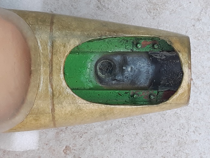

Fear not the lead is within a very contained space . If it broke free completely it would hardly change the C of G

Yes, it is a big chunk of lead and you might need a bit less if it were further forward. From the earlier build pictures, it looks as though you may be able to put some directly unter the motor......... FWIW, I hollow out the block on the underside of the nose, soak the area with water for a few seconds to saturate the wood and prevent burning. Tip any surplus water out and then pour the lead directly into the hollow. Let the lead set and then tip the model upside down and the lead will fall out. Let the area dry out (if it hasn't already), clean up any scorching and then bed the lead back in with some 5 minute epoxy. This way the lead is as far forward as it is possible to get it and there is no wasted space.

Another option is to put the lead forward of the prop hub in a spinner for max forward position. Well balanced of course. A turned steel mass can also be very effective out there.
Be very cautious pouring molten lead into any wet or damp area. If you really must do it at least cover all skin and wear safety glasses.

The possible drawback of a heavy spinner could be the side effect of gyroscopic precession. Maybe not a big problem on something like a J60 but on anything mildly aerobatic I think it would be a no-no and even on a J60 you would never get it to loop straight!

Interesting comments thank you . Agreed with getting it as far forward as possible - it is in fact very nearly under the motor -and it would be if the motor were a smaller diameter. It does look big amount of lead but it’s only what it needs and no more. The model itself is a light build. I felt the same about the(electric) Black Magic which has a similar sized lump. However the Super 60 with its 4stroke up front needed a lump in the tail !
Back to the Junior it balances slightly nose down with a 3300mah 3s and level with a 2200 3s
