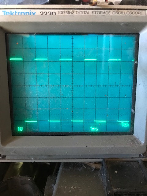

I finally got around to making a divide by 2 circuit using a JK flip flop, an MC14027P. Tied the J and K to positive, S and R to ground, connected the demodulated and squared audio (data pulses) from the receiver to the clock (CK) input of the flip flop and as you can see below, it divided the 1000Hz modulation frequency from my signal generator into 500Hz pulses. I tried to photograph the recovered pulses from the Digi-Ghost Tx, but they are too slow and my camera only catches about one half a pulse so you cannot see the entire sweep of the scope.
My next plan is to use a SOT-23 8 pin D-type flip flop wired as a T flip flop to do the same thing and install it inside the receiver case and output the pulses to the unused signal pin on the battery plug of the receiver. I'm using a Traxxas 2215, works great.

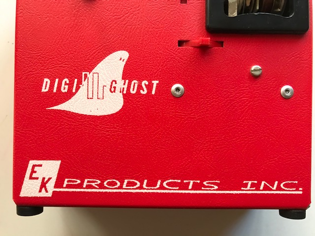

Any chance of a closup of the front of the tx, & the Digi-ghost & early EK logos please? Also some case dimensions? Not urgent, a reproduction Tx to compliment my EK proportional trannie collection is a medium to long term project on my list. Did EK ever make a reed tx(s)?

The transmitter case measures 6 inches tall by 5-3/4 inches wide and 2-1/2 inches deep. Photos below.
