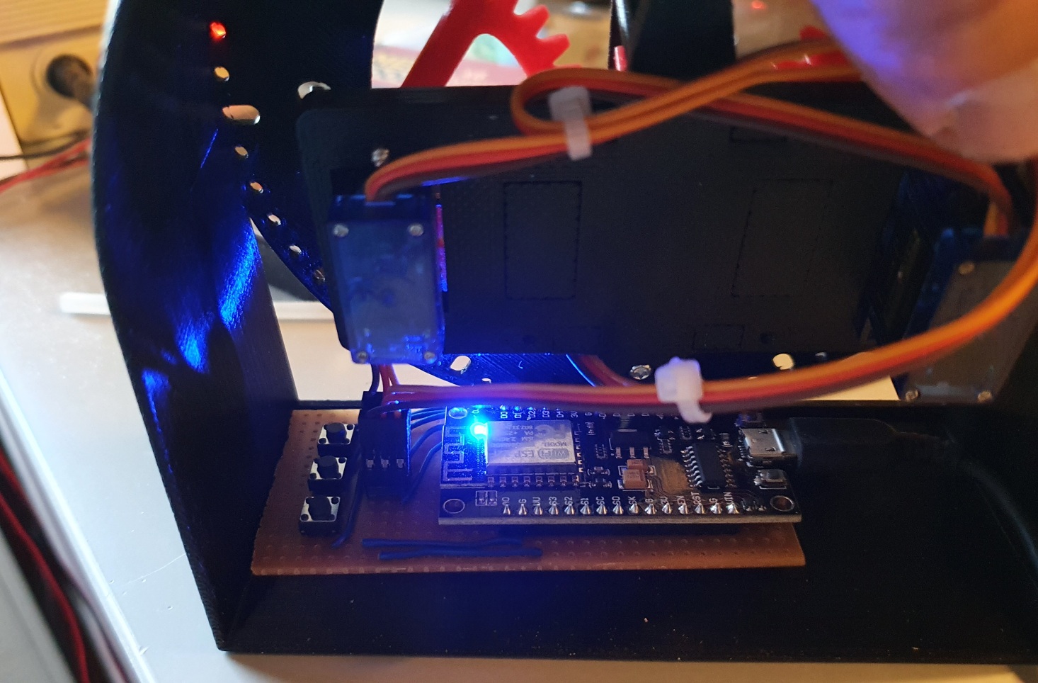

It's worth getting one of the 'strong' boards - they're only a few dollars and make experimenting with servos and similar R/C connections such as SBUS less of a hassle. Also, they fit better in the clock! I put the screw holes to mount the board in the 'backplate' of the clock, and some cut-outs to clear where the pins protrude through the PCB. Normally, I incorporate stand offs to mount PCBs but that would make the backplate difficult to 3D print without support, so I went for the 'flat back with clearance pockets' approach.

I will take your advice, this was stuff I had hidden in a "junkbox" that I ordered wrongly as i was looking for the ESP32 really.

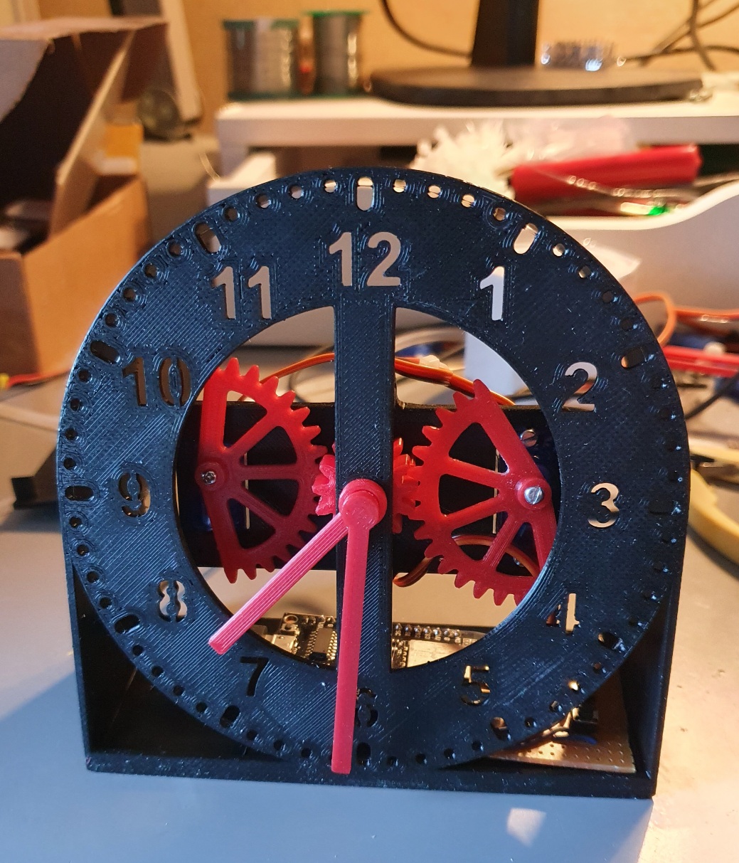

My sister really appreciated the clock and the design as she said, first time ever, this is something you built that I might consider to have on the shelf and visible!

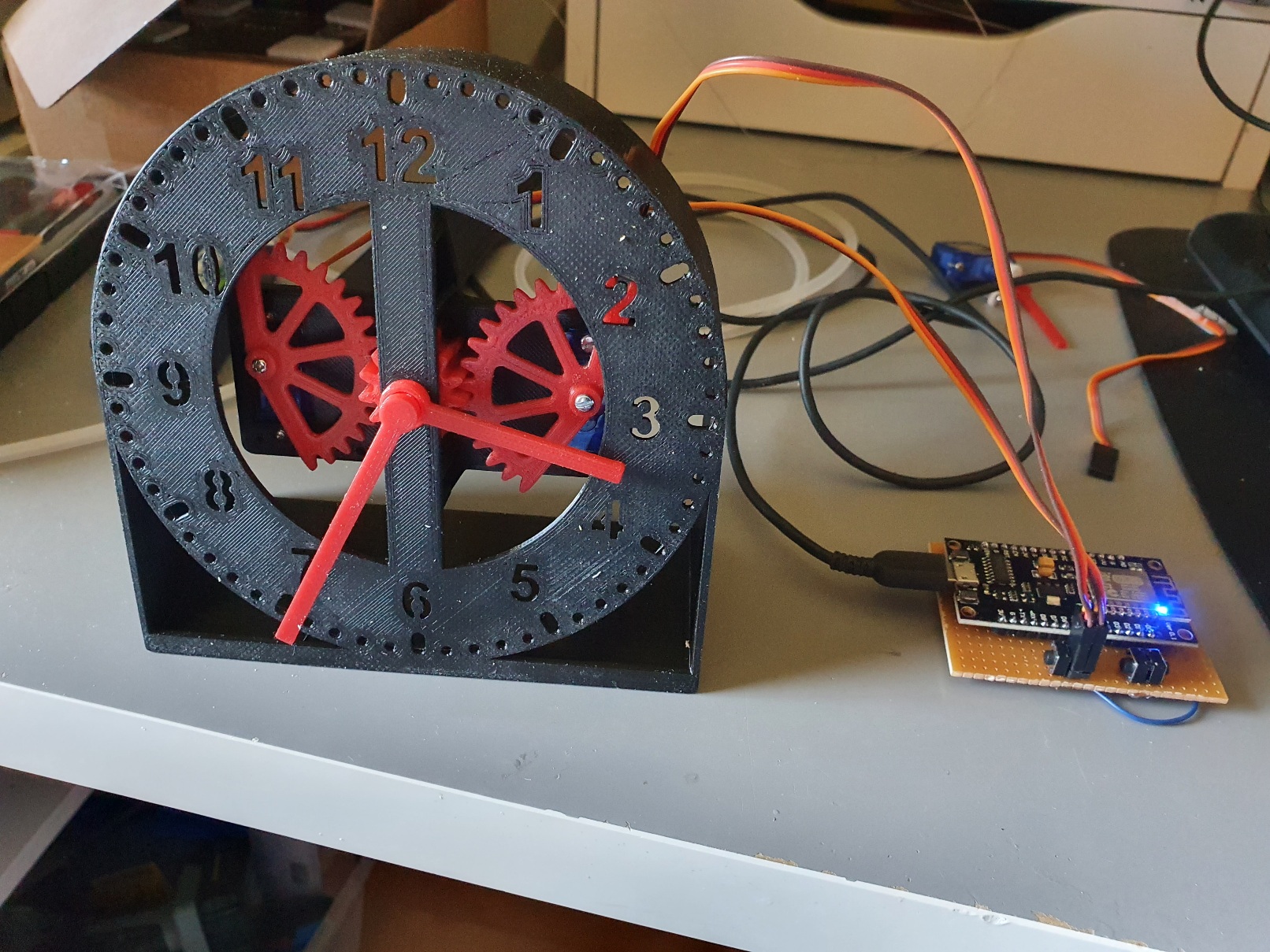

Martin, I have 2 clocks up and running and they are exactly the same as servos etc. but they still need individual calibration!
I was thinking...as calibration takes some time!!! if you could have each hand to make at a command do like "60" steps/one revolution after which you read on the dial the actual amount of steps and compute 60/XX and set the minute/hour travel accordingly, I think this would expedite the process.
As the servos at least the cheaper ones are not linear which normally is not an issue but might become here creates the question if you should calibrate the clock in 15 steps segment but to be honest I don't feel it necessary as the parallax error when you look at the clock is probably higher.
