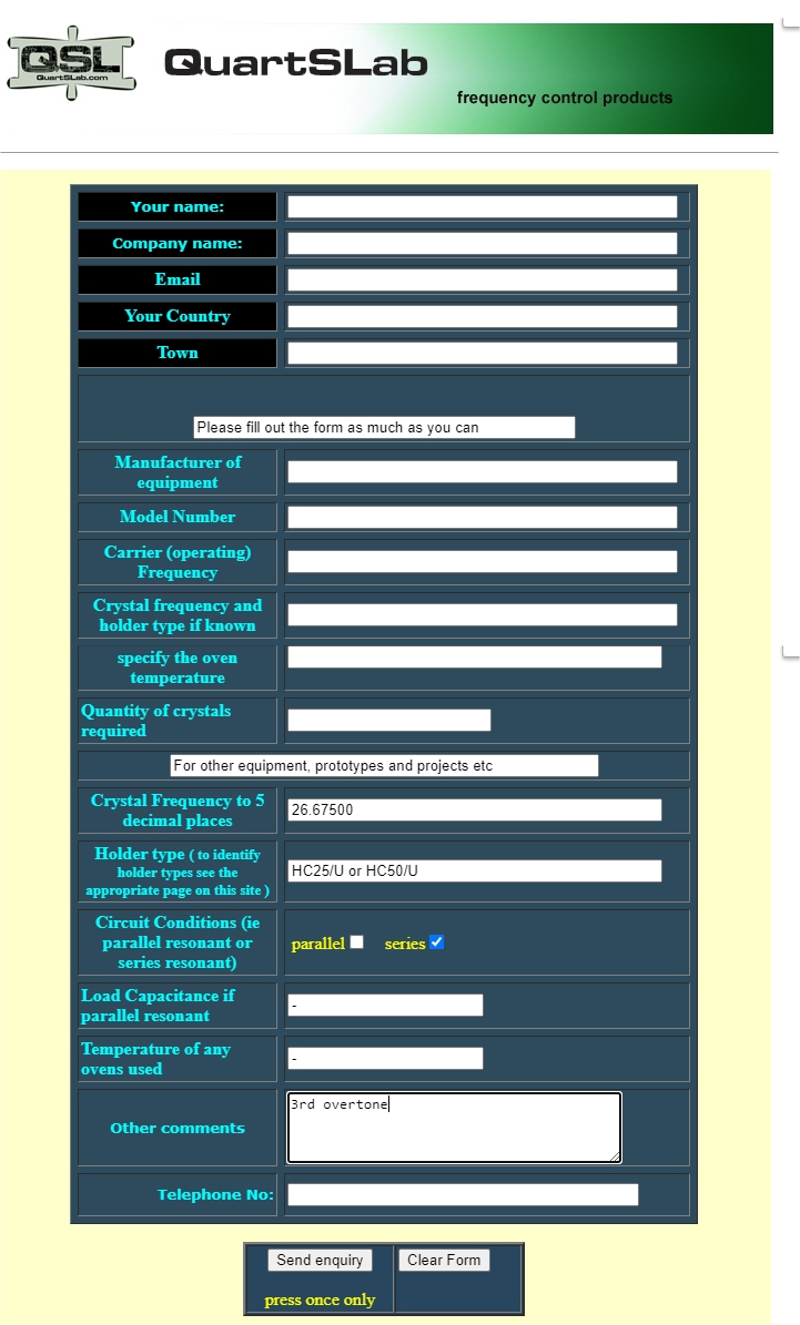

Say you have an early Macgregor superhet with the 470k IF. Suitable transmitter crystals are ten a penny but receiver crystals for a 470k IF are rocking horse poop. Quartslab will cut you a brand new one for £12. Actually theres a minimum order of two but thats ok, they dont have to be the same crystal.
Given the price some vendors are asking for standard crystals, I think £12 for an otherwise unobtainable custom made one is great value.
Use the bottom half of their form, specify the exact crystal frequency (eg transmitter frequency minus .47mhz for Macgregor), the holder as HC25/U or HC50/U, series resonant, 3rd overtone:
