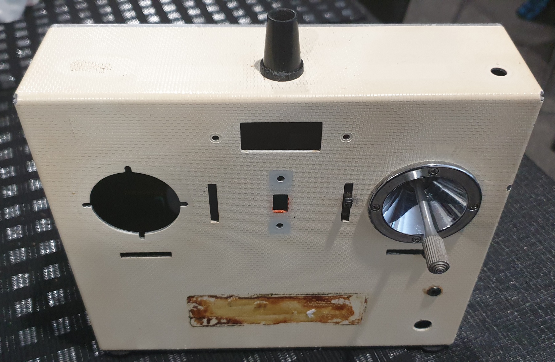

Re: Cleaning Vinyl Clad Alloy TX Cases?
That's come up well ..

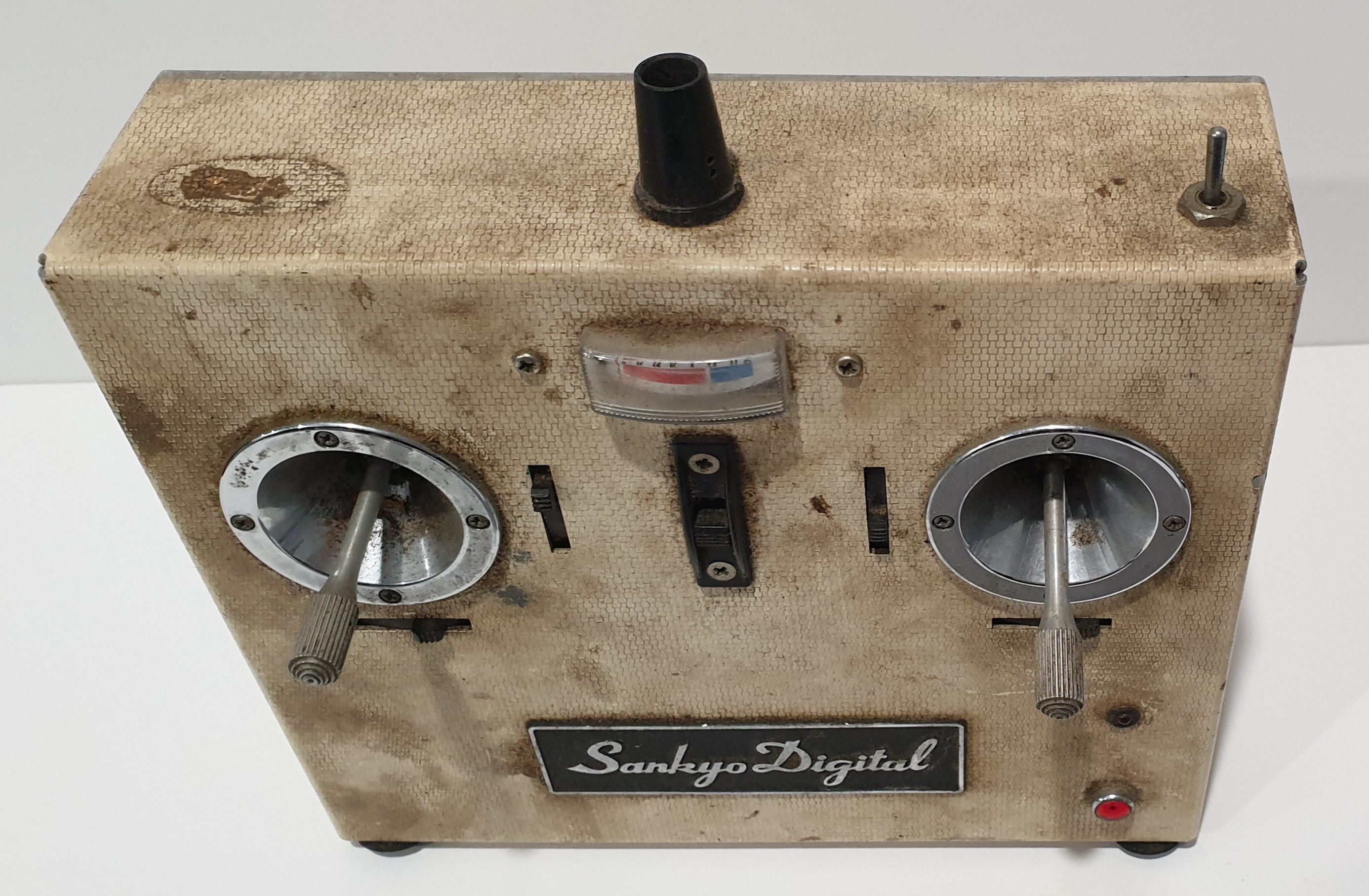

I've had excellent results with just a wet Mr. Clean Magic eraser.
It has worked fine on Kraft, Ace Olympic and Silver seven, vintage Futaba and even Heathkit blue paint.
