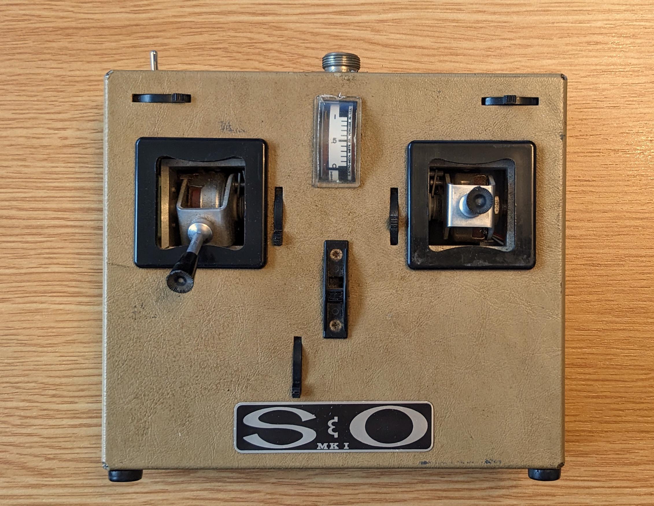

The S&O set had been on my "bucket list" to add to my collection for years, but I had little hope of ever finding one as they had been hand built in the USA in very small numbers from 1971 to 1973. Then this one appeared on eBay.de and I managed to get it, another crossed off the bucket list!
What is so special about S&O? Well the joysticks. If you think Pro Line joysticks are good, the S&O are better. In fact, they would give any modern top-of-the-range Jeti, Futaba or Spektrum a run for their money. The electronics were also exceptional, very stable with changes in voltage and temperature, it was a set truly ahead of its time. But it was so expensive and difficult to build that they couldn't continue and Pro Line took the top spot again.

Hi Wayne

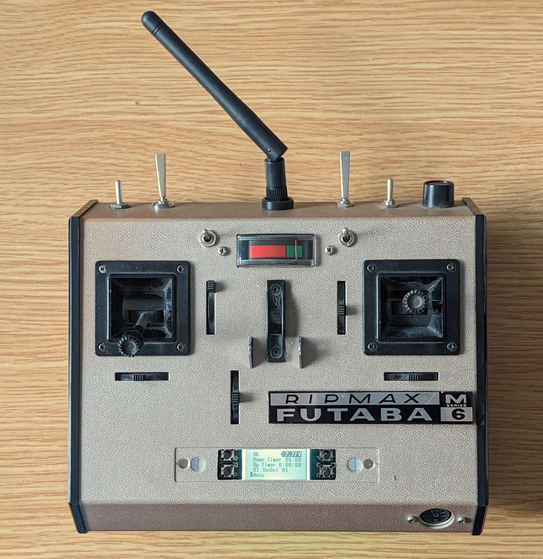

I've designed a dedicated encoder board for the Futaba M6 (FP-T6FN elsewhere in the world) that nearly fits the S&O, the auxiliary lever just fouls the "slot" in the pcb. I'm going to see if I can file away the bit of the PCB that would foul the auxiliary lever (I don't know how bad an idea it is to file away a bit of a multi-layer PCB, but I know there are no tracks in that area) and then have one of my standard conversions with the encoder LCD and menu switches hidden behind the S&O badge. The worse that happen is that I mess up a circuit board, but I've around 20 left, so it wouldn't be a disaster.
And the encoder board in its intended transmitter

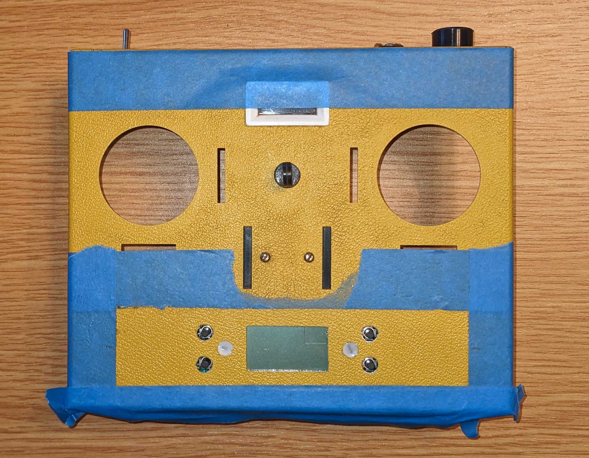

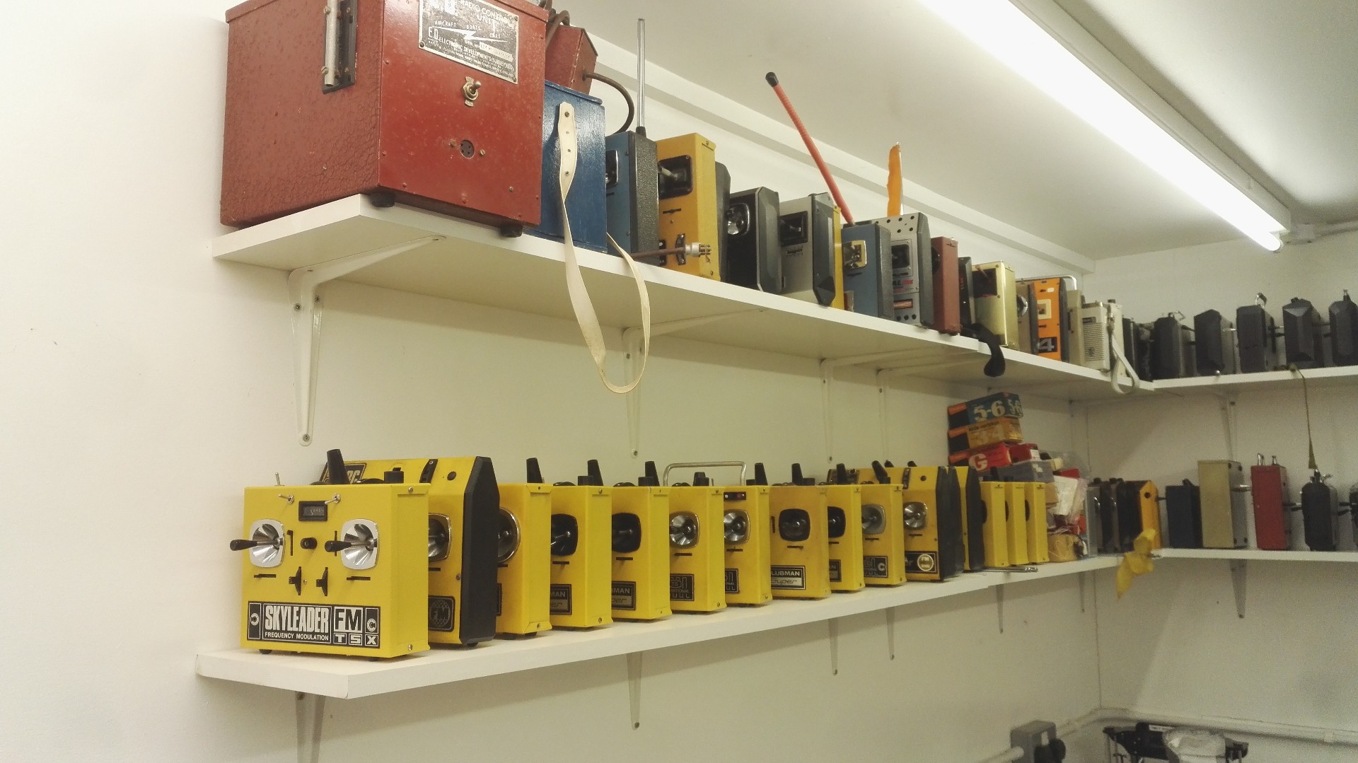

I have a bunch of Skyleaders I am converting however, some for my own use and others to sell, which includes an
SL, SLX, Clubman, Cluman Super, TSX, Courier and a couple of Courier Specials. And there are about a dozen Futaba M6 to convert as well, so it should keep me busy!
A Skyleader being converted with the encoder test mounted
