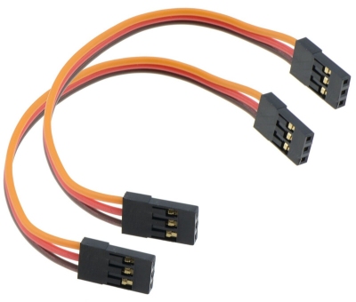

Consequently I would rather graft on a standard servo cable, preferably replacing the whole lead or if thats not possible, extending
with a few inches of ready-made 'servo lead'. To this end I buy bundles of ready-made leads, these for example are female-female leads (in EE's terms, aeromodellers insist servo connectors are male) and snip them in half to make two 'adapters'. I usually go for twisted cable, though as PaulJ pointed out, you can split and twist the ribbon ones (I'd never thought of doing that!).
These are female-female!
Re: Wiring connectors
