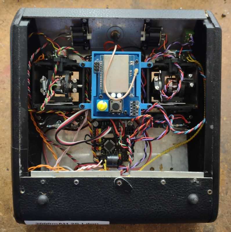

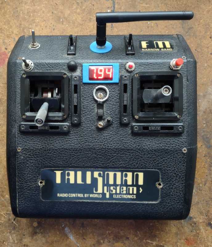

My latest project: an elderly World Engines UK Expert transmitter:
This was originally built as a 35 MHz set, with an Ace Silver Seven encoder. I had intended to keep the encoder when I converted it to 2.4 GHz, but it had developed a really weird fault which I failed to locate. As a result it now has one of Phil's excellent 7 channel Arduino encoders, on a DIYMore "Strong" board.
Power is provided by a couple of LiIon cells salvaged from an old laptop pack. All the "blue bits" used for the aerial, meter and RF board mountings are diy 3D printed.

The transmitter now has a multi-protocol board for the RF module. Unfortunately, its only an ATmega one, with limited storage space, but I've managed to get all the FrSky and Spektrum protocols in, which is all I need.

Nicely done Pete. I think those sticks are the same ones used by Proline in their Competition series?
You should get your lad to do a modern-day 3D display with it :D
The red button top right, is that for what I think its for? :D

I'm not sure if the sticks are shared with ProLine, but I rather doubt it. They are all plastic, and have phenomenally strong springs - even by my standards! :lol: I've never handled a ProLine, but I thought they had metal gimbals?
It does have separate electronic slider trims, and it took me a while to get the "mixer" resistance right. I ended up with 33K, which gives around 10% total trim (5% per side). Unlike rotary trims, you are using the full track, rather than just part of it.
The top right red button is the single-channel emulation. The smaller, mid-right button is the timer. The switch above the left stick is the throttle lock. I may yet add rate and expo pots through the holes at the ends of the Talisman plate, where the Silver Seven encoder screws went through.
Now that the latest version of the encoder has all these extra whistles and bells, I'm thinking of adding at least the timer and throttle lock to my Royal Classic Tx. That has an early Arduino Nano / DeekRobot board, so I'll have to tweak a couple of things on the sketch to get it right for that board (PPM out IIRC).
I've made a few changes to that Tx recently, so I ought to go back and update the thread on that, I reckon!
Wayne: You didn't need the single channel button to make helicopter aerobatics "interesting"! I added a switch which transferred the throttle function to one of the auxiliary sliders on the top, keeping the collective on the left-hand stick. Setting the aux slider to around 80-85% kept the throttle open enough for loops and rolls. Then for autos, you had to switch the throttle back to the LH stick, shut the aux slider to zero, then separate the throttle back to the aux function with the switch to initiate the auto. All whilst still trying to control the heli!
As I said, it worked, but required a bit of dexterity to pull it off! :lol:
