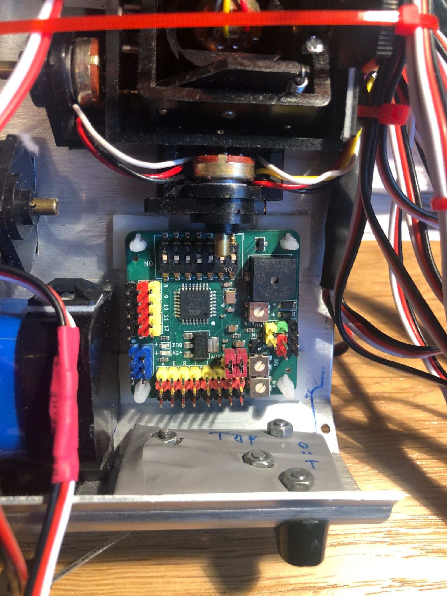

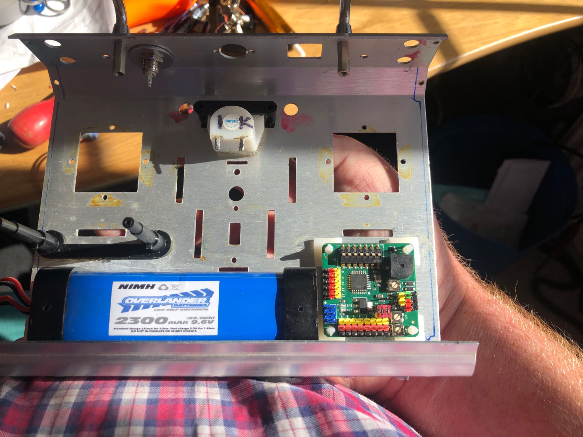

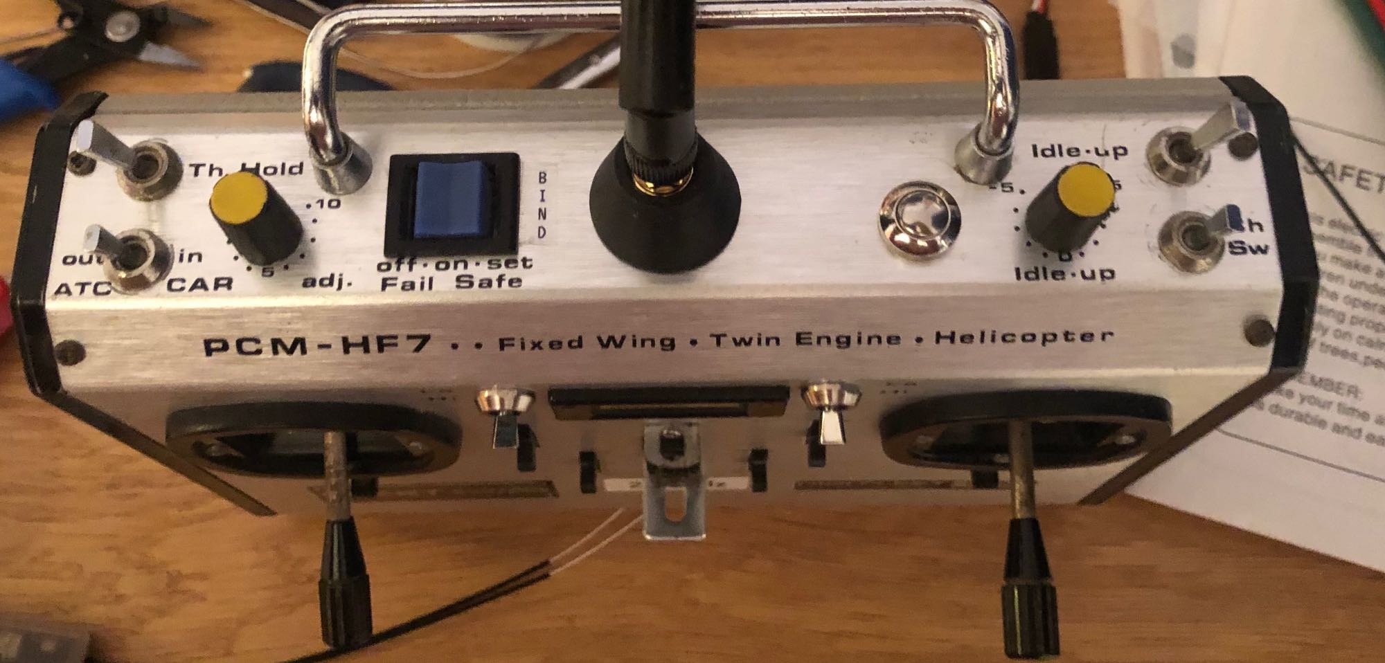

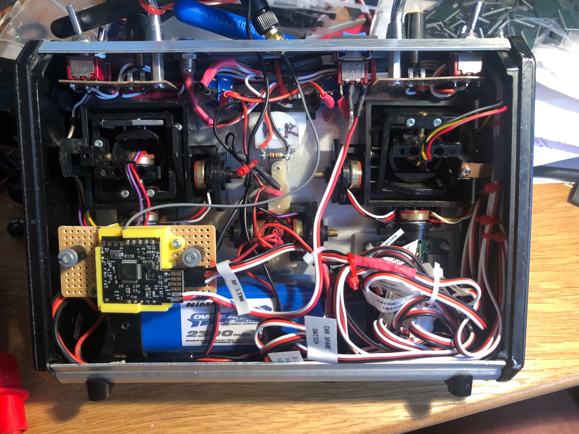

So with my second Digifleet PCM transmitter I elected to gut it completely and install one of Mike Kitchen's GTS encoders. Fitting everything in was a bit of a challenge and also organising the correct throws for the electronic trims. This was all achieved in the end and the result is a fully working Tx with all the channels correctly assigned and some new features (eg expo). The throttle hold switch now locks the throttle at idle when activated (Safety feature). The failsafe button is now the Bind/Range check button. The 2 knobs on the top now control the level of elevator or aileron rate or expo. An additional button was added for the timer activation/ stick calibration function.
